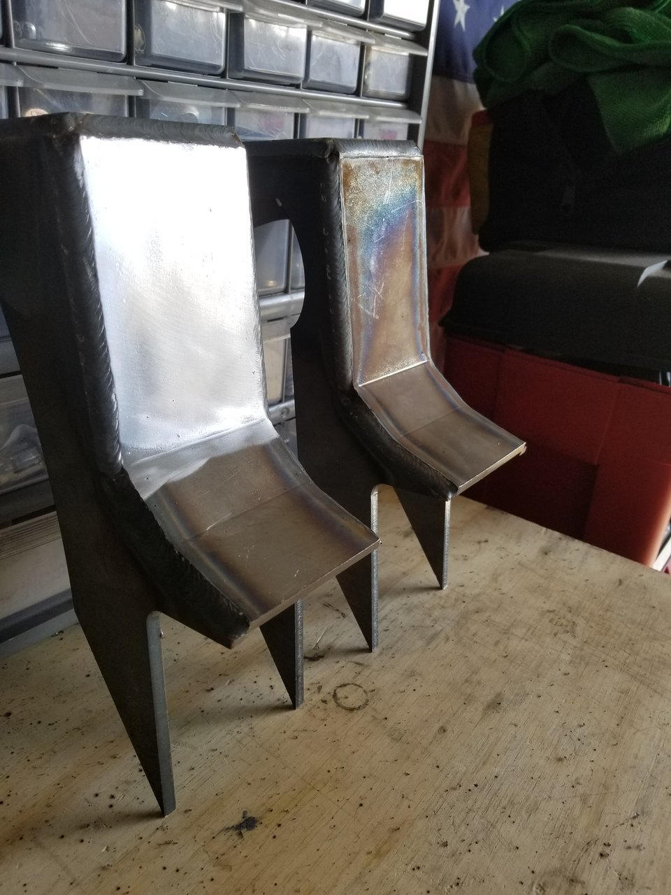

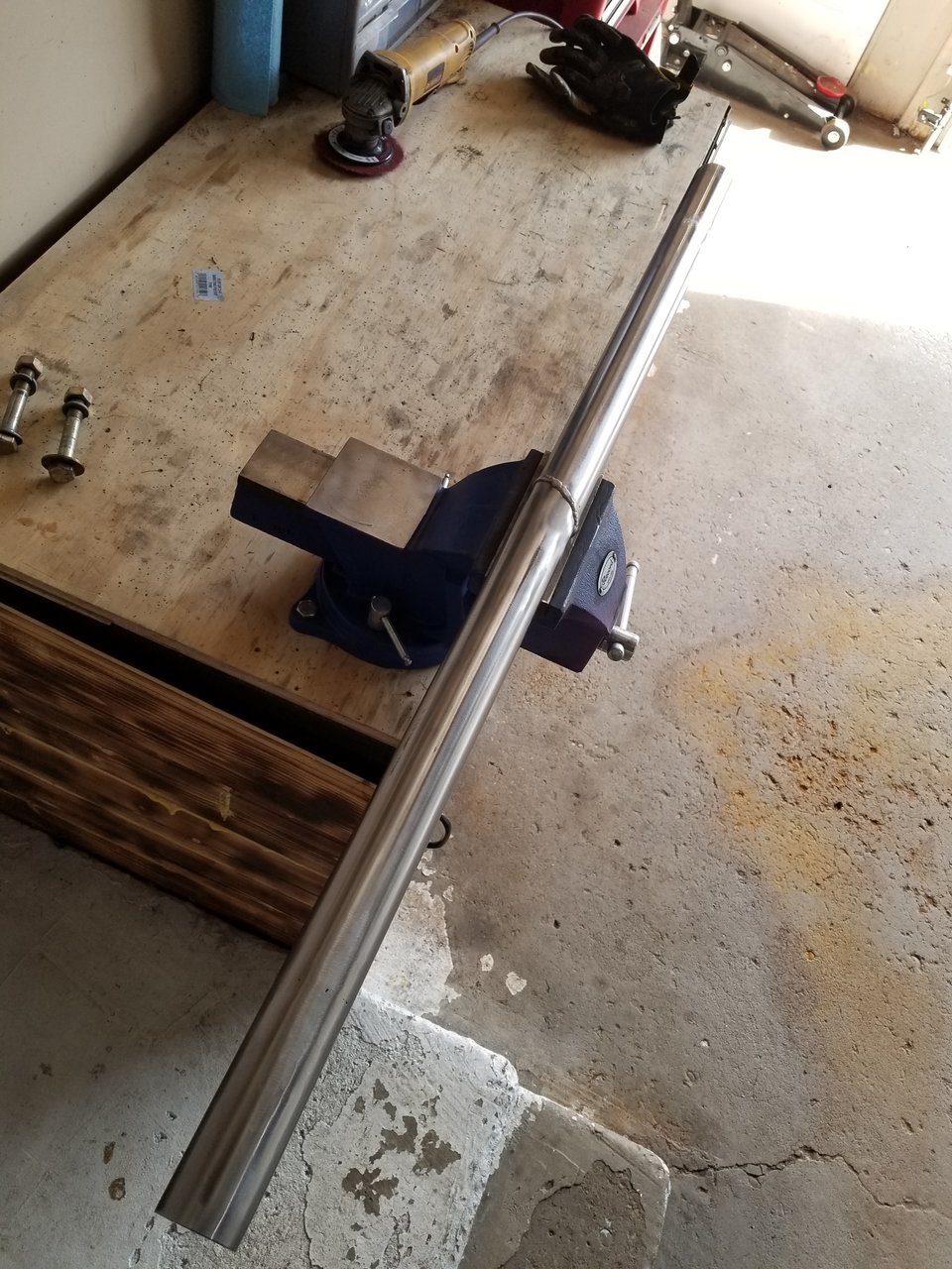

    New abrasive wheels are awesome. They are expensive but will make the finish a lot cleaner.

    Yeah I couldn't believe how clean it is. I've always used the crap from home depot and am never happy with the finish. Going to get to work on my custom archive crossbar. Archive is sending me the crosstube flanges and I have my own metal so we will see how this turns out.

    Welded up the crossbar. It was too short. I have to shorten it now. Hopefully the welds hold on a good hit.

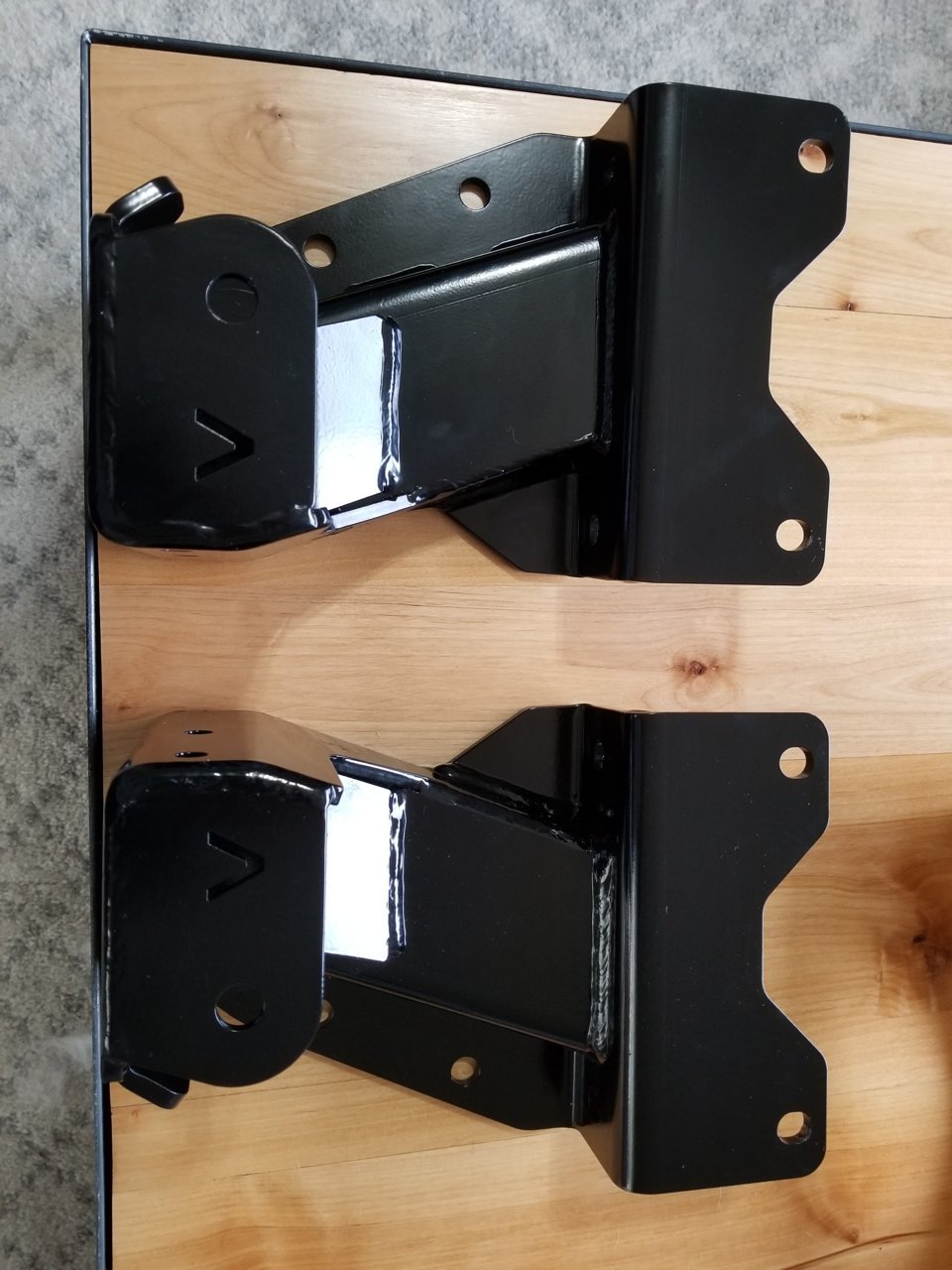

    Archive Hammer Hangers are on and what a difference. I didn't think it would be as good as it rides and that was just from a quick 10 minute drive. My setup is bilstien 5125 with Allpro Expos and archive hangers w/stock shackle. Will be paired with some 12" kings soon. Gained 1/4" lift and 1 1/2" of droop. Now my shocks are the limiting factor. Thanks @ARCHIVE
    First two pics are before and the rest are after.
    Before
    Ride height 40 3/4"
    Droop 43"
    After
    Ride height 41"
    Droop 45 1/2"
