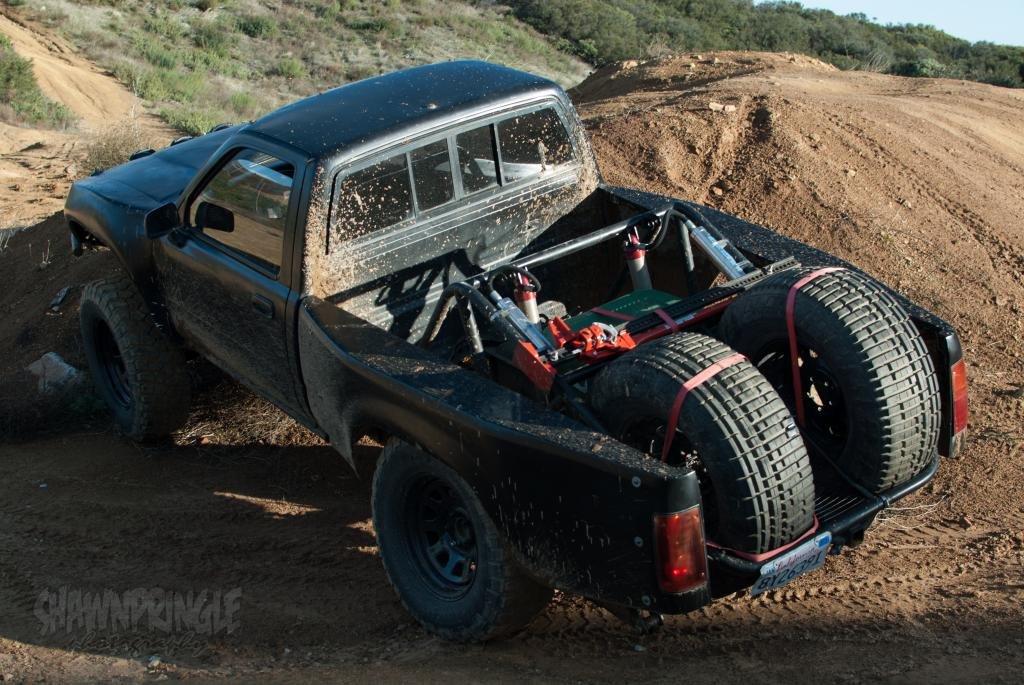

    There are two ways to re-arch a spring pack. The inexpensive way known as "cold setting" uses a press to change the arch. This is a short term fix. Springs are made out of (appropriately named) spring steel, which in laymen's terms has spring memory. Meaning unless the memory is erased, the spring pack will return to it's original height before re-arch. The second method is done by annealing, reshaping, and re-heat treating every single leaf in the pack. This process erases the spring's memory and typically costs $200+ per pack. If you're getting this done by your shop for $50, stay friends with that shop!
    So did your truck with a stock rear end and nothing but Icons up front. :notsure:
    Gotta pic of your shackle/mount setup and we can tell you?

    No one has said your truck can't work they are trying to advise you on how to avoid breaking and wearing out parts on your truck. I suggest you start taking some advise from people who have more experience than yourself and learning a thing or two instead of getting defensive. The point they are most likely trying to make is that instead of buying those shackles you could be that much closer to a legitimate rear suspension that you won't have to constantly maintain

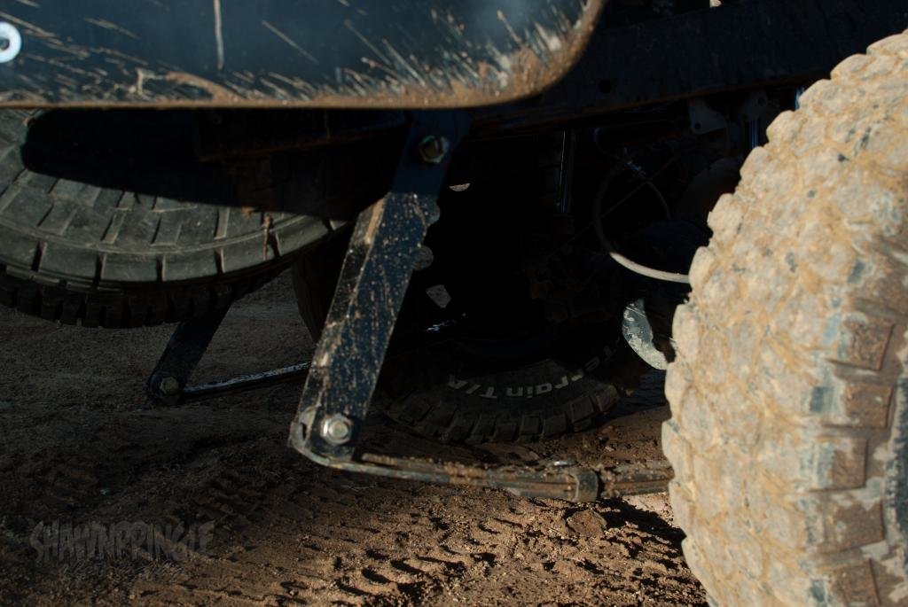

    does this look that bad? flex-80_zps22f5aae8_1246fada64a0e64ecdf9a4a66549a2c343bfcc06.jpg flex-81_zps9151749d_4ece45a209b667dca0ee878e6ce431ef0fddb139.jpg

    Show us the side thats compressing

    its there look in the pic, theyre taken at the same position

    Can't see anything other than the shackle and part of the mount.
    The shackle looks thin. Looks like a couple of pieces of 1/8" plate sandwiched in between two pieces of rectangular tubing? If you're using a rectangular shackle like that I'd really recommend plating it top to bottom and at least 3/16th. I bent my 3/16" square shackles, so did Matt.
    As for the mount, sorry dude but from the what I see that's a little sketch. I can't see the whole thing so I don't have much to offer, but from what I can tell, I don't see any gusseting at all on it and literally just looks like a piece of metal hanging off the bottom of the frame with a bolt running through it. When it comes to pivots, you typically want a piece of DOM tubing welded to the frame and then gusseted front and back with bushings and a sleeve that the spring bolt runs through (basically just like one of the eyelets of a spring). You want as many points of contact on the pivots as possible to keep it from ripping off the frame. I actually have my bed cage welded to the top of my pivots and the pivots gusseted front and back.
    As for spring arch, all I see is the truck drove up on the side of the hill. I don't see bumps (or where it bumps), but i see a shit load of shock shaft still showing. So unless you're on your bump stops, I'm guessing there's still several inches of uptravel which would put the leafs way negative. Again, these are just speculation based on the pictures you showed. If you've got more or take some more, I'd be happy to offer more information or clarify any of my previous statements.
    One last thing, please invest in some tire straps.

    I know you think I'm stupid and zip doesn't know much but oddly enough it is dom tubing welded to the frame, gusseted both sides and underneath, with the proper poly bushings i might add. We also upgraded the bolt size while we were there to 5/8 I believe.
    I agree the the shackles are a relatively weak point, and will be gusseting them more shortly. The rear side that is stuffed is approx 2 inches from bump, which more than likely results in a bit of negative arch (at complete full bump), but nowhere near "6 in of negative arch lol".
    I appreciate the input and will be strengthening shackles asap, and more than likely adding more gussets to the mount.

    Are your shackles really mad of DOM ? I thought it was all plate...and the mounts.

    I put those pictures up to show the shackle angle and flex of the spring. I didn't break out the strobes and jacks to provide you top quality perfectly lit diagrams of my set up so you can nit pick each feature.

    No offence man but your shackle setup is completely unsafe and a danger to others around you on the road. and i not just talking about the negative arch from mounted under the frame, im talking about the mounting and the shackles themselves. I really don't think that could have been designed and built any worse. Please please please have those removed and have a real fabricator install something that works and wont kill people.

    1st the reason your supposed to do shackles over the frame is because a true LT leaf pack has so much droop you would be lifted a ton if your shackles are long enough. If your shackles are not long enough its not going to perform as good. You will find out when you fab something incorrect it just costs more money, it does not save money
    2nd you can rely on "wedging" your tire in all you want but what happens if the tire loses air? Or if you actually get a blowout and have the blown tire in the rear, then how do you keep it in? A standard 2" ratchet strap is $8 at HF, you don't need a race type "Y" strap for $60.
    3rd why do you have harnesses without a cage?
    Mine is also low budget garage fab there is nothing wrong with that, but if your going to make a death trap or put other people in danger your doing it wrong
