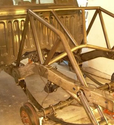

    In all seriousness yes I do. Ill tell you why. I don't think you understand how much stress is applied to a shackle and especially to the hanger. And that's because leaf springs are not just springs they are also what locates the axle, side to side and front to back. When you are driving especially while accelerating, braking, turning or articulating the rear axle wants to go all over the place. The only thing stopping that is the spring. Now think of the spring as a giant lever magnifying all that force into the hanger. Travel isn't the problem (the shackle pivoting soaks that up) its the side load and twisting action that the shackle and pivot get subjected to that starts breaking parts. These are all unseen forces that a fabricator has to think about, obviously yours didn't. Please don't use him again, he is not a fabricator, he is a guy that can kinda weld. Hope this helped

    I've also found the best working setup for a truck like yours is a 9" shackle through the frame, I wouldn't just reinforce what you have I'd replace it. I can build you some shackles if you need it down the road.

    Sounds good, I will probably take you up on that! Does that basically eliminate hangers since you run the dom tube through the frame and bolt through that?

    The frame is the hanger.
    Shitty picture and not a toyota , but you'll get the idea:

    Thats what I was saying. Thats badass, too bad I didn't think of that before he made my mounts. Looks like the strongest option for sure
