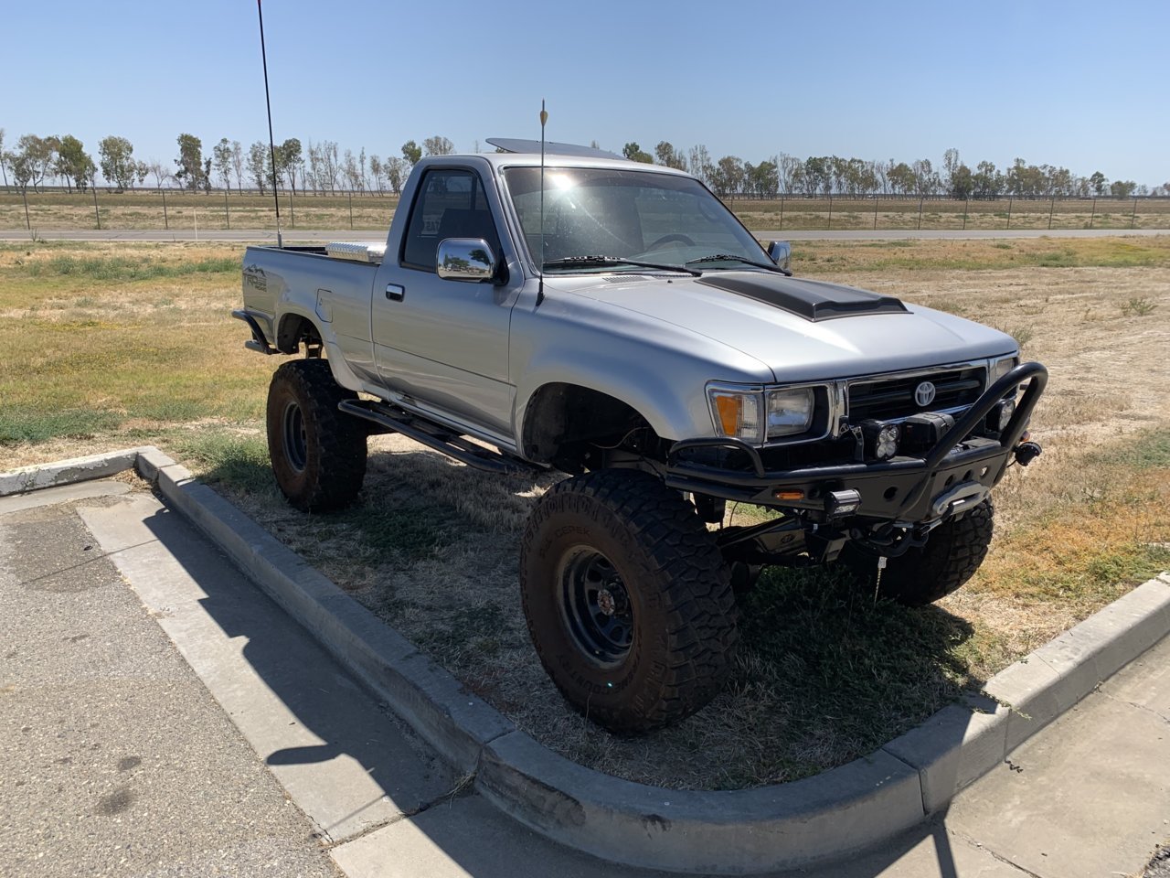

    So I’m working on a 92 Pickup with a 97 4Runner 3.4 swap. Wiring in the cruise control from the 3.4.
    When I hold the set button and turn on the cruise control it blinks twice. Anyone know what that means?
    It turns on but it won’t actuate and hold speed.
