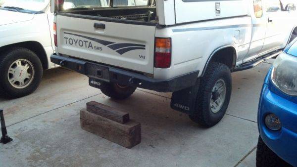

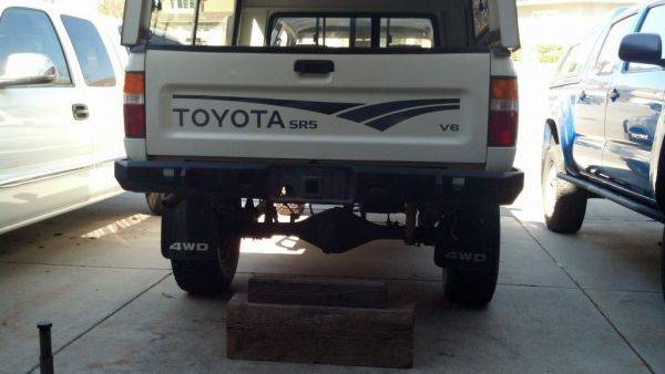

    All set up! Had to take it off to paint the spacer pieces that take up the gap between the bumper mounts and the frame, so once those are dry tomorrow it'll be good to go! :D
    I could've tucked it closer to the bed but it looked like it had its tail between its legs when I did that. So I made the gap between the bumper and the bed under the tailgate match the gap between the wrap-around wings and the bedsides

    Thanks, guys!
    Yeah I'm really happy with how it looks. Turns out there are some minute differences between the two (my truck and 1st gens), even though the rear ends look pretty similar. The bedsides go out a little farther on first gens and curve in more at the bottom on my truck. The frames are 1/2" different width-wise so I bought some 3/16" plate to fill the gap on either side, with a little left over to allow the bumper to squish on a little. And the mounting holes are different, too, so I had to drill new holes on the frame and bumper. The holes that I drilled in the frame seem like they might be a little too close to the end of the frame (3/8") so I might decide to weld the spacer plates on eventually to strengthen it. But for now it's good enough! I just really wanted it on to make sure it worked :p

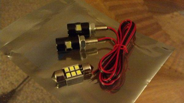

    Picked up/received some goodies today. I bought a bunch of air fittings for setting up some quick-disconnect spots for airing up tires with the new compressor. Hopefully I'll get that all put together tomorrow.
    Then I received these little doodads in the mail:
    Bolt LEDs for the license plate and a pair of LED festoon dome lamp bulbs. That lamp hasn't worked since before I started driving this truck...probably hasn't for the past 10 years. Now with the bright LED in there it's AMAZING!! I tried to take cell phone pics of the difference between map lights and the dome light but my phone camera really sucks and it wouldn't capture any light, so I'll try to get those on a real camera tomorrow night.
    I need to pull the dome light assembly down and clean the electronics, though...it's all corroded in there so the light flickers a little sometimes when turning it on.
