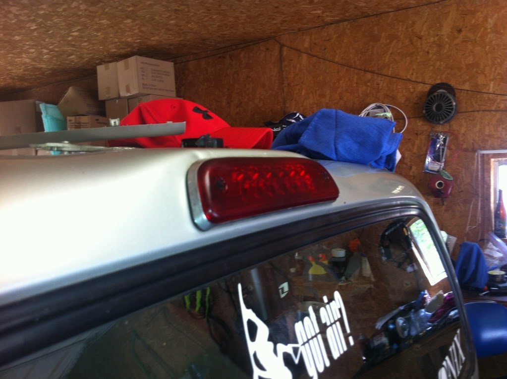

    I think it's going to be different for you, but my back window has a gap between the cab and the outer edge of the window and the coax fit perfectly in there. I doubt your truck has that gap though. I can take a photo of it close-up if you want.
    You can kinda see where it goes (into the channel, around the passenger side, and down between the bed and the cab) in this photo:
    [​IMG]IMG_5538_cleaned_small by 92shawman, on Flickr
    After dropping down under the truck it goes alongside some other wires and then up through one of the drain plugs in the foot area of the passenger seat. Then just under the carpet and up to the center console area.
