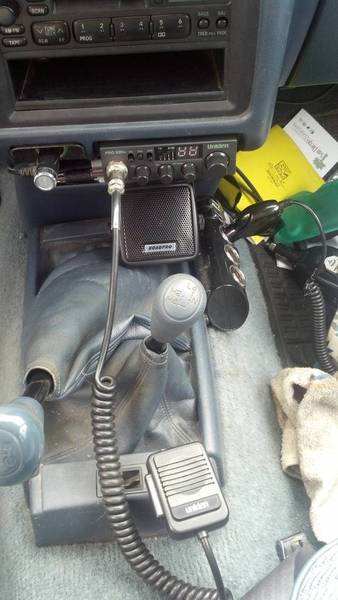

    Did some of the finishing touches on my radio today. I finally secured the external speaker and I put velcro on the unit and in the compartment to keep it in place instead of jumping out whenever I bring the mic up to my face. :p I found that adhesive-backed velcro actually works really well in there instead of superglue, like I used last time. I tested the old, superglued velcro to see if it was still holding and it basically just peeled right off...
    Now I just gotta wait 24 hours for the velcro adhesive to cure and then it's done!! :D

    CB's in and lookin' good!
    The sticky-backed velcro seems to be working excellently so far. I tried pulling the radio out after sticking it in and it took a bit of force to make it move, so I didn't bother taking it out all the way. :p

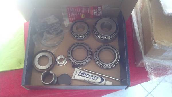

    Just ordered parts for the diff rebuild! :woot:
    Thanks, Pliny for referring me to Cruiser Outfitters. They were super helpful and prompt at getting back to me and their kit includes all the parts AND extra shims and the gear paint, so I'm happy!
    Aaaaaand my neighbor has a press and potentially other equipment (pullers, splitters, etc) for doing the actual work!! :D

    Got the package from cruiser outfitters today. Impressively fast shipping for anyone other than Amazon! Sorry for the crappy lit cell phone pic... :eek:
