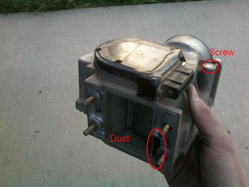

    He has a 22RE, they don't have a MAF, they have a vane and flap based AFM (super restrictive but reliable design), they don't really gunk up that easily.
    It may have a loose connection though.

    Would the loose connection be the big harness plugging into the air box, I've unplugged and reseated It a few times. Vacuum lines are fine.
