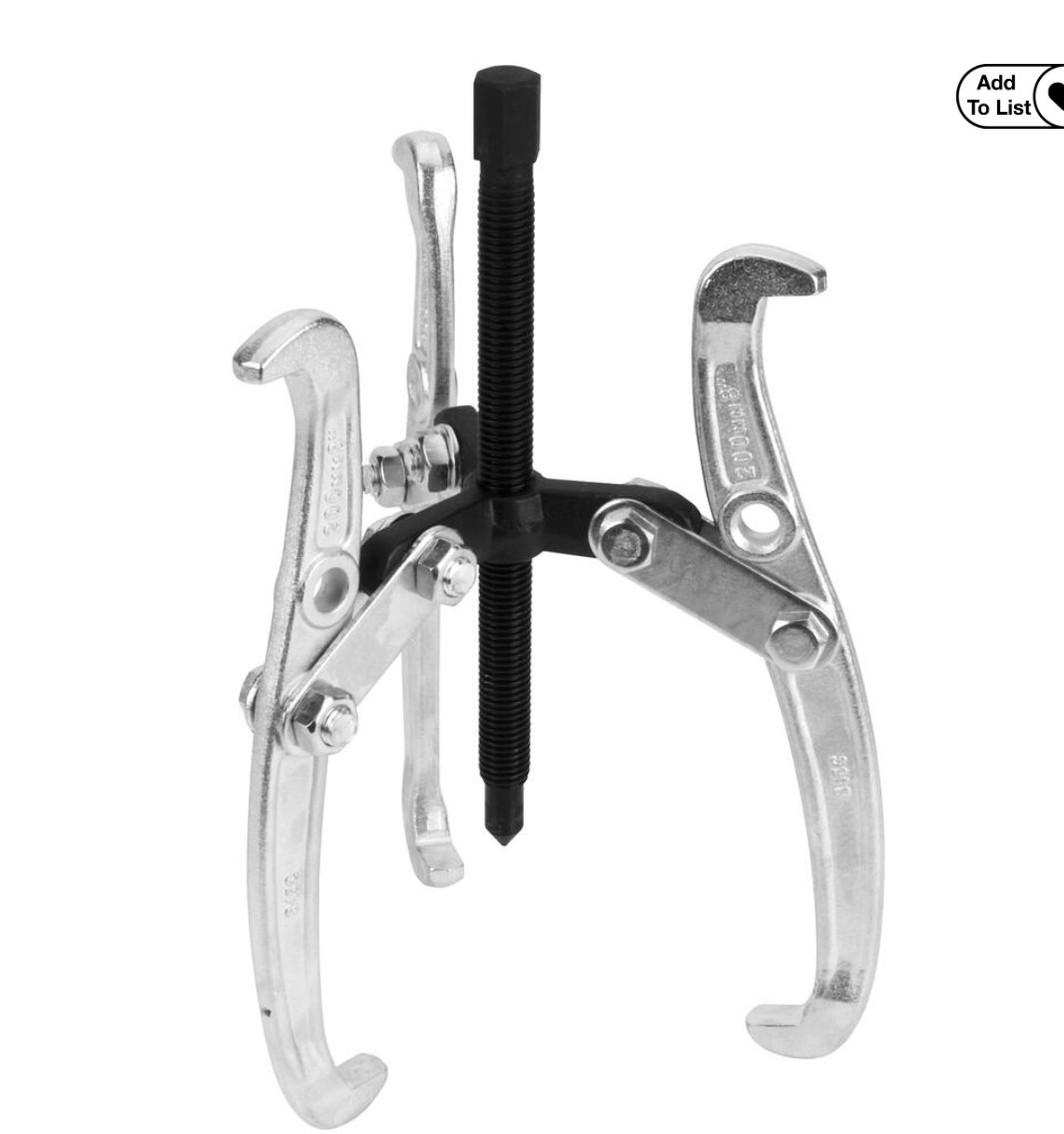

    A 3 jaw pulley puller should work.
    They sell them at most hardware and parts stores.

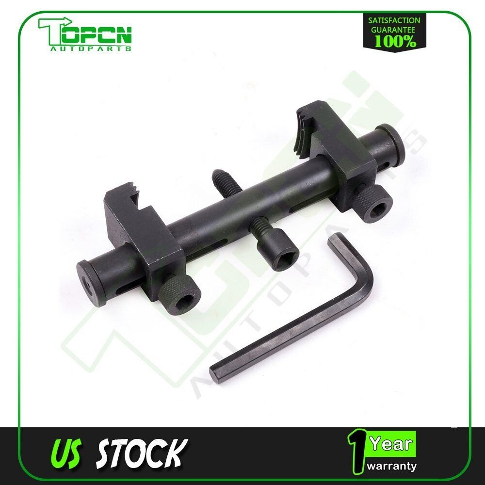

    With the design of the pulley's on the toyota engine fronts,
    one of these is real handy to have on hand....
    locks into that pulley with a gorilla grip.
    way easier and safer than the bi/tri jaw pullers....
    .....its meant for tight situations....
    Universal Puller Ribbed Drive Pulley Cranckshaft Auxiliary Remover Tool | eBay
    And by the way.....everything yields to the torch and Pb blaster........

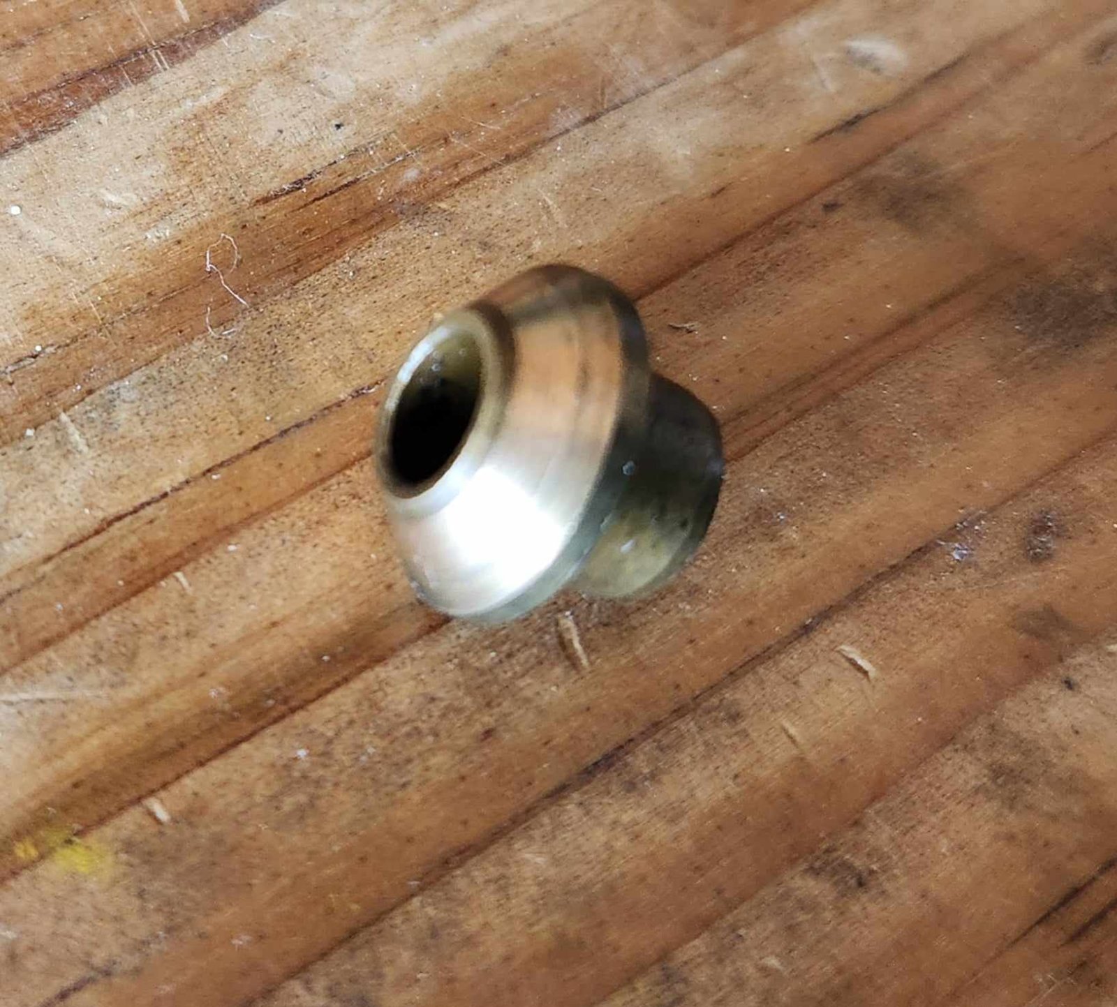

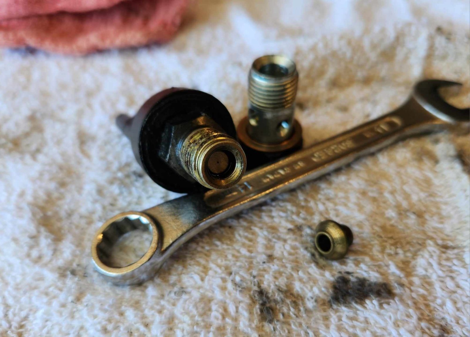

    There's nothing quite like finding a part you didn't see where it came from. I have a small brass half dome "union tube seat?" that fits perfectly in the end of the PS fluid flow control bolt and the Air control valve. I've read and looked at diagrams and still unsure - any ideas?
