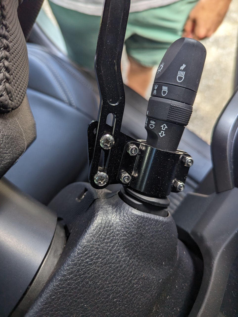

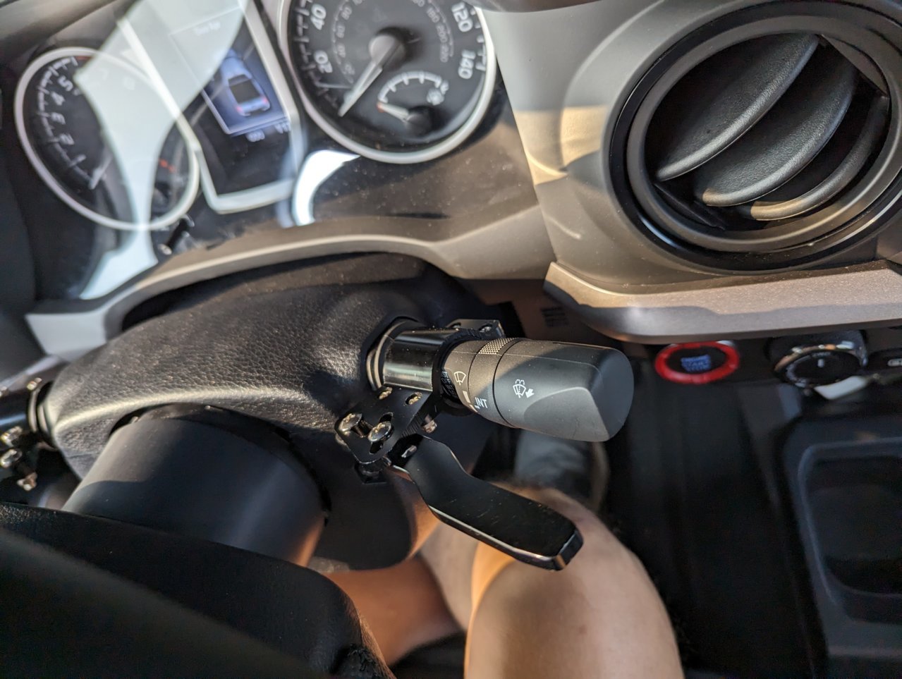

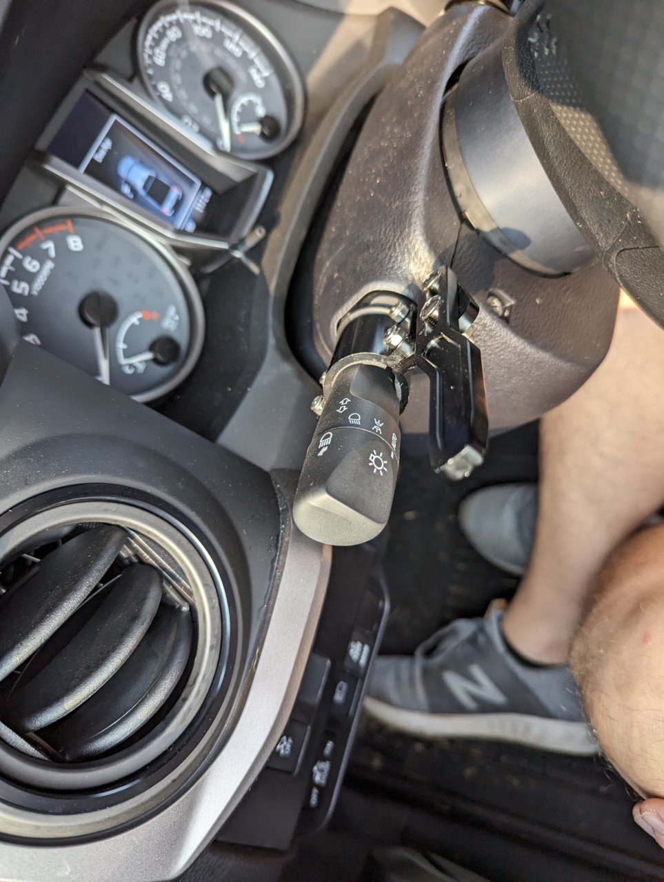

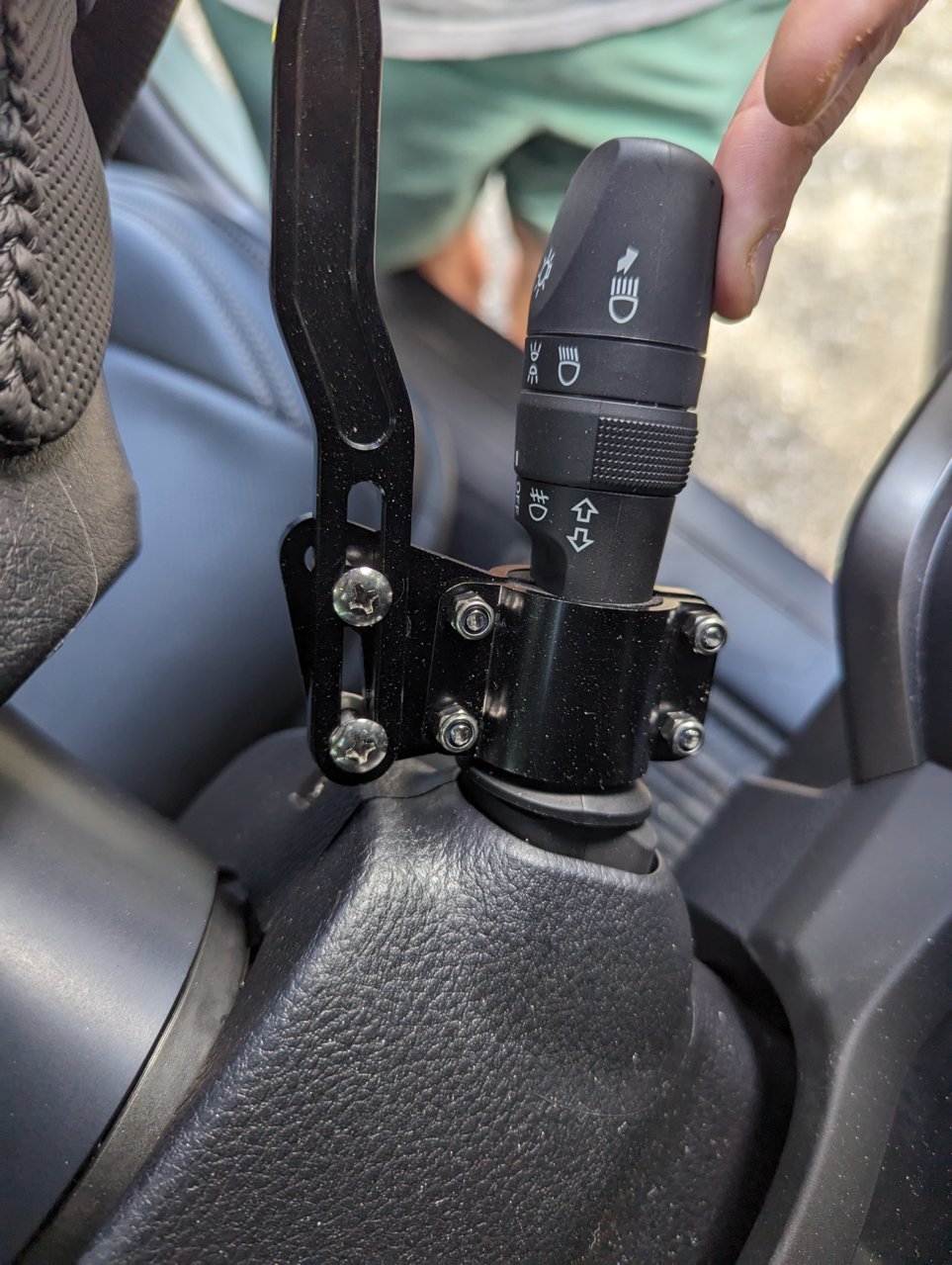

    Another follow up. Like the OP and others said one down side to this extension is how far the directional and wiper stalks are from the wheel.
    I found these on Amazon and they work great! I highly recommend installing them if you have the same concern. They come with two different depth tapes and I had to use the thicker one on one side and I used a 3m body tape on the other for extra security.
    They are listed on Amazon as "AUTOHAUX 2 piece Car Turn Signal Extension."
    musicisevil and kuruma1 like this.

    Stalk controls are all that’s holding me back from installing the extension. Have these worked well for you? Once you tightened them down they haven’t moved at all?
  11. Sep 21, 2023 at 9:35 AM
    #31
    TacoRexy
    TacoRexy Member
    May 2, 2023
    #423805
    11
    2023 Tacoma Trail Edition
    They've worked great for me. They did move with the 3m double sided I put on initially they were just a little to loose with one thin pad so I ended up using the 2 thick pieces of foam they provided. The thick foam contours nicely around the stalk and it it hasn't moved. I haven't really "tested" them to see how secure they are now, but I don't really have any complaints.
    If you are unhappy enough to be thinking about this upgrade and the stalks are your concern, I would recommend you do it. The benefits far out way the negatives.

    Very cool. Thanks for the input! I’m hoping I’ll still be able to pull stalk back for flashing brights with the extension moved closer to the column due to my fog switch.
    Thank you for posting this product too!
    Stalks were definitely the only thing holding me back. Just purchased both column and stalk extensions
    TacoRexy[QUOTED] likes this.

    You have the fogs on the stalk? Since those pics I did the stalk and fog mod and upgrade (I was pre-wired for it). The extenders do not interfere with the fog switch. The extension actually sits in the exact same spot on both stalks; flashing bright function works as you'd expect. No compromises with this mod other than it looks a bit primitive.

    I do. I was concerned that I’d have to move the extension bracket back, closer to the column, to make room for the fog ring on the stalk. Looking at your pic again it seems like it’s back far enough already to accommodate that oem fog switch on the stalk.
    You don’t have any clearance issues with the bracket hitting the column when you pull the stalk towards you for momentary high beams?

    Man, thank you so much. Extra pics are a great help!

    @TacoRexy I can’t thank you enough for pointing me towards these.
    The column extension is a game changer in comfort and makes entering/exiting so much easier. I had it installed for 10 days before I got the package from Amazon.
    While I could have made it work and relearned the stalk positions and hand stretches to reach them, these silly little things make the driving so much nicer.
    One of them was a return and was missing 3 bolts, but $4 at Home Depot squared me away. Of course they didn’t have 8 so I couldn’t do both of them though…
