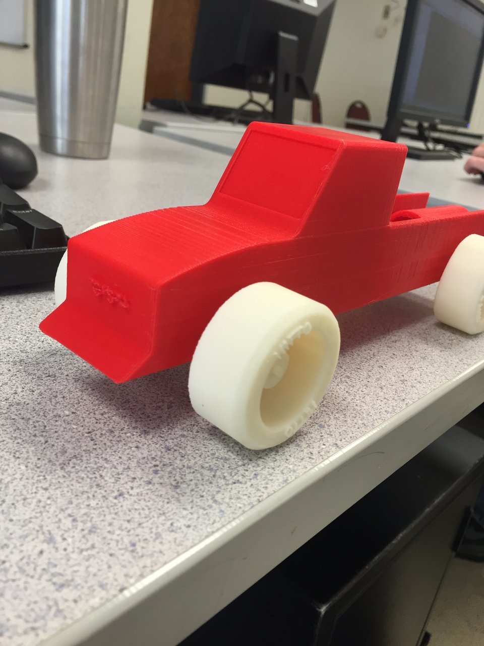

    I totally agree about the growing of 3D printable objects. I used several printers in an Engineering class that i took in High School. If i was to print that same part with one of the printers that I've used in the past, it may have taken an hour for a high quality product. We made all kinds of things, CO2 cars, rockets, ball bearings, etc... Speaking of which, i made my CO2 car a reg cab tacoma, which I still have a picture of:
    notice the "TOYOTA" on the front (didn't turn out too well) and "NITTO" on the tires.

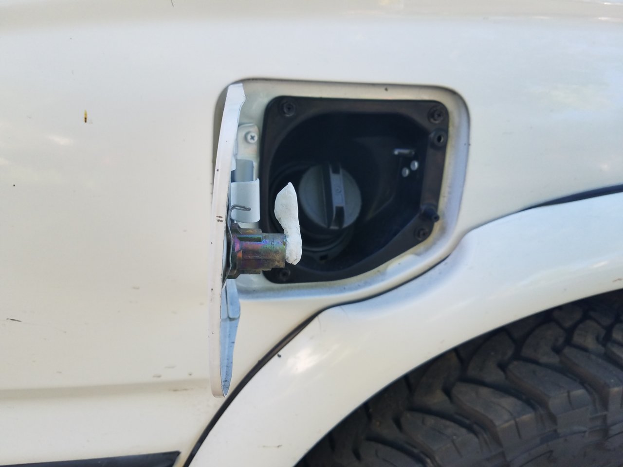

    My solution to the same problem...
    Welding wire and epoxy putty.20180623_171126.jpg 20180623_171126.jpg 20180623_171915.jpg
