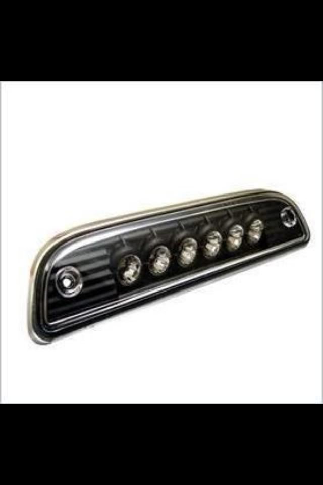

    I'm looking to swap my 3rd brake light out. Not just to LEDS but a smoked lens and black inside. I know I could smoke my lens myself but I'd rather buy one of these. Smoking something that's already red makes it dark dark
    Anyway I know that 95-04 tacos use the same third brake light. The 05-11 look so so close! Some listings on eBay say 95-11 others say 95-04. Anyway here is a picture. I think they are the same so it should work

    I have a black sand pearl. This is what I want to
    But the only ones on eBay for tacomas say 95-04. Just here lately have I seen some say 95-11. I always thought that the 1st gen third brake light was the same. But before I buy it I'd like to know if I'm right

    Hmmm. Well maybe they did make a whole new third brake light for the second gens. They look so freaking close. I may just order the cheapest one for an actual 1st gen and see if it'll work for my 2nd gen

    I did the same thing. I bought a 95-04 3rd Brake LED off Ebay for $35 shipped. It's on my 05 Tacoma X-Runner right now. It fit's just fine. You just have to make your own wiring connection and make your own gasket, since no connector or gasket is included.

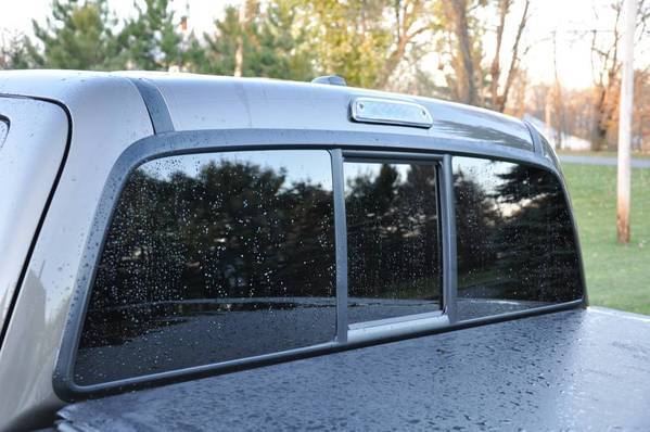

    I have this one also...and yes sealing is a problem. Moisture seems to get inside the cover when it rains so next dry day I get I will seal it up. Other than that. It works really well and looks alot better then the red stock one. Here are a few pics of mine. This light actually has a clear cover but the inside of the light is black so it looks dark when its off.
