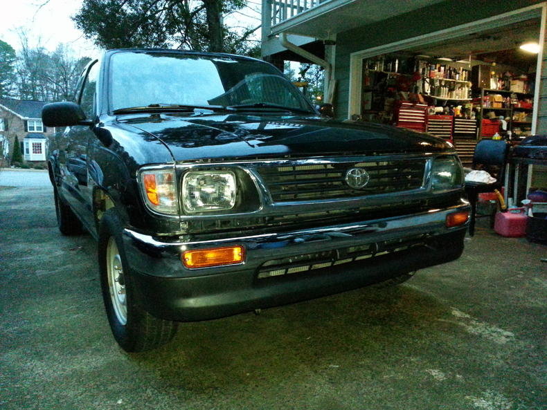

    I thought the same, but it is doing the exact bog under load on takeoff with the new parts, same as before.Even the plugs I took out(orig. ngk spec.)looked new.Just bought this a few weeks ago someone else tried fixing it I guess.These are parts I was going to change anyway but now im running out of stuff.Hope the tps fixes it.maybey it low fuel pressure?is there a way to ck the pump?any help would be great!BTW just put on my ebay bumper and lower spoiler,not bad stuff for$120 shipped.pretty good looking chrome for the price
