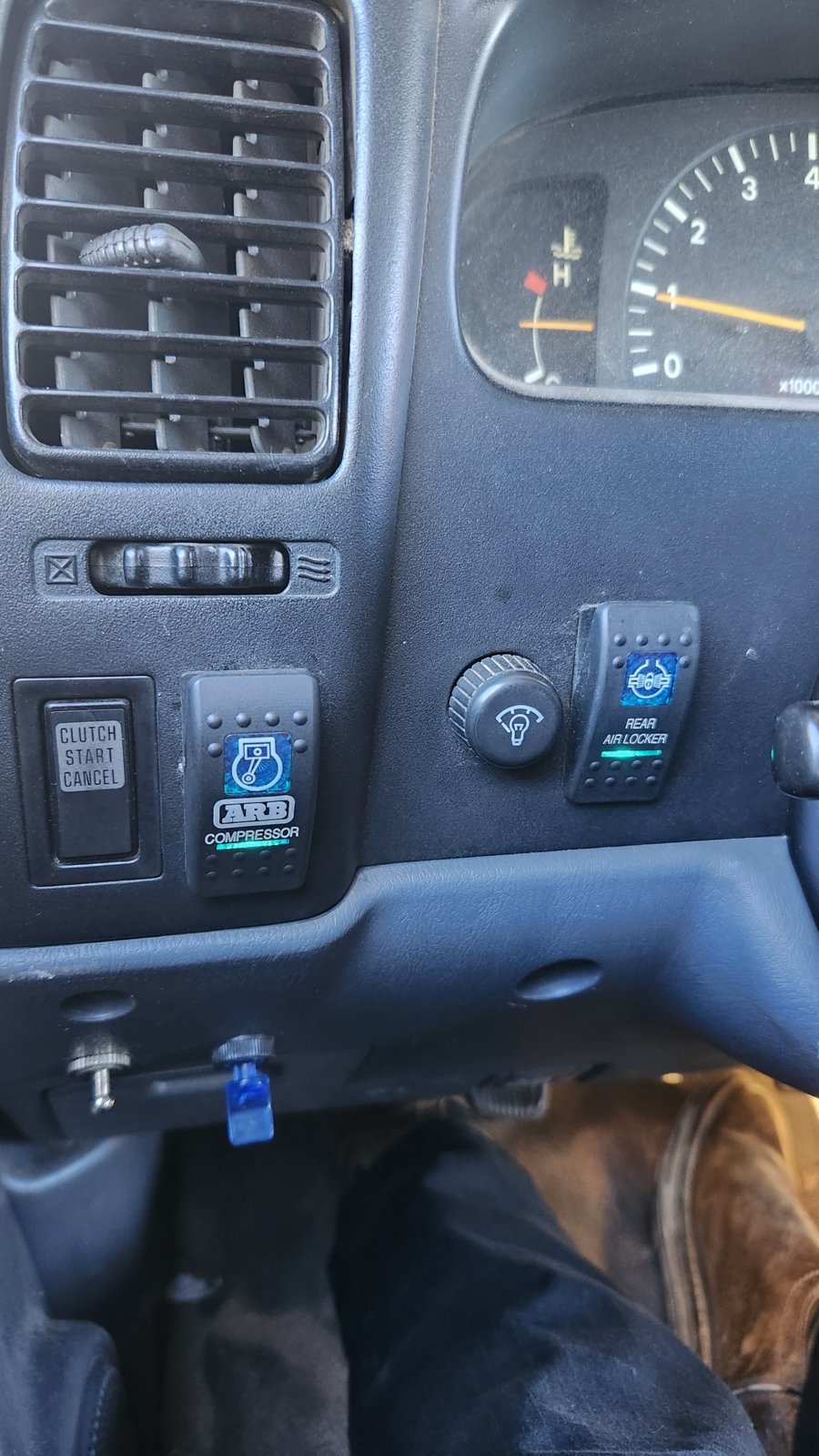

    Can I ask how many switch do you have? You can not engage the rear lock switch and engage both arb air lockers at the same time, that's according to your statement. They're standalone, not standalone like I said. Rear is primary while front is secondary.
    Sounds like you have a rear arb air locker only....

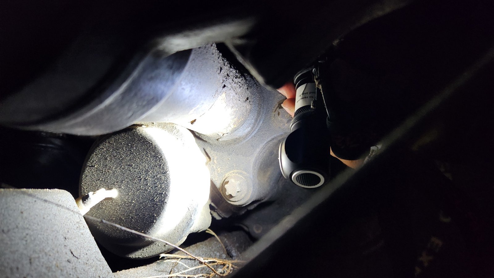

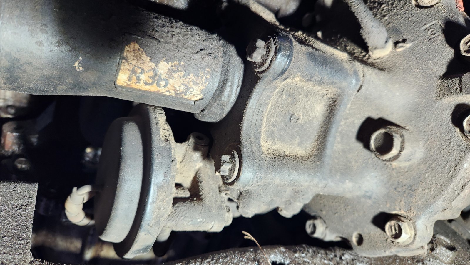

    Here is a picture I took with the skid plate on of what it looks like the front diff actuator.

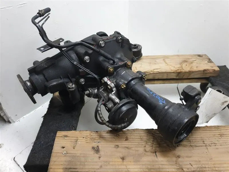

    Based on that picture, you got the earlier vacuum actuated ADD (automatic disconnecting differential) setup. So let's clear some things up, do you have a push button 4wd or a manual j-pattern leverage inside the cab?
    With that being said, this probably explain why your getting movement on the driver side and not the passenger. The non-ADD tube is different, there's no moving part. Coming from the CV to the tube to the clamshell, there's 100% contact with the manual hub (dial switch) as your engage/disengage. For the ADD setup, the tube will have an actuator that once you engage 4wd, the slide fork will move a ring gear into the lock position to allow the clamshell to spin with the CV (hence, your engage/disengage mechanism).
    In your case, you got manual hub (which seemed to be a conversion due to the fact that your manual hubs are Warn and not factory) with a vacuum actuated clamshell. The previous owner got cheap and didn't change the ADD tube to a non-ADD and probably performed the hose clamp mod or moved the ring gear in place hoping it will remain in the lock position. This is solely based on my assumption from what I'm seeing.
    If my statement is correct, you can remove the vacuum actuator and manually move the ring gear to the left (lock position) and test your 4wd.

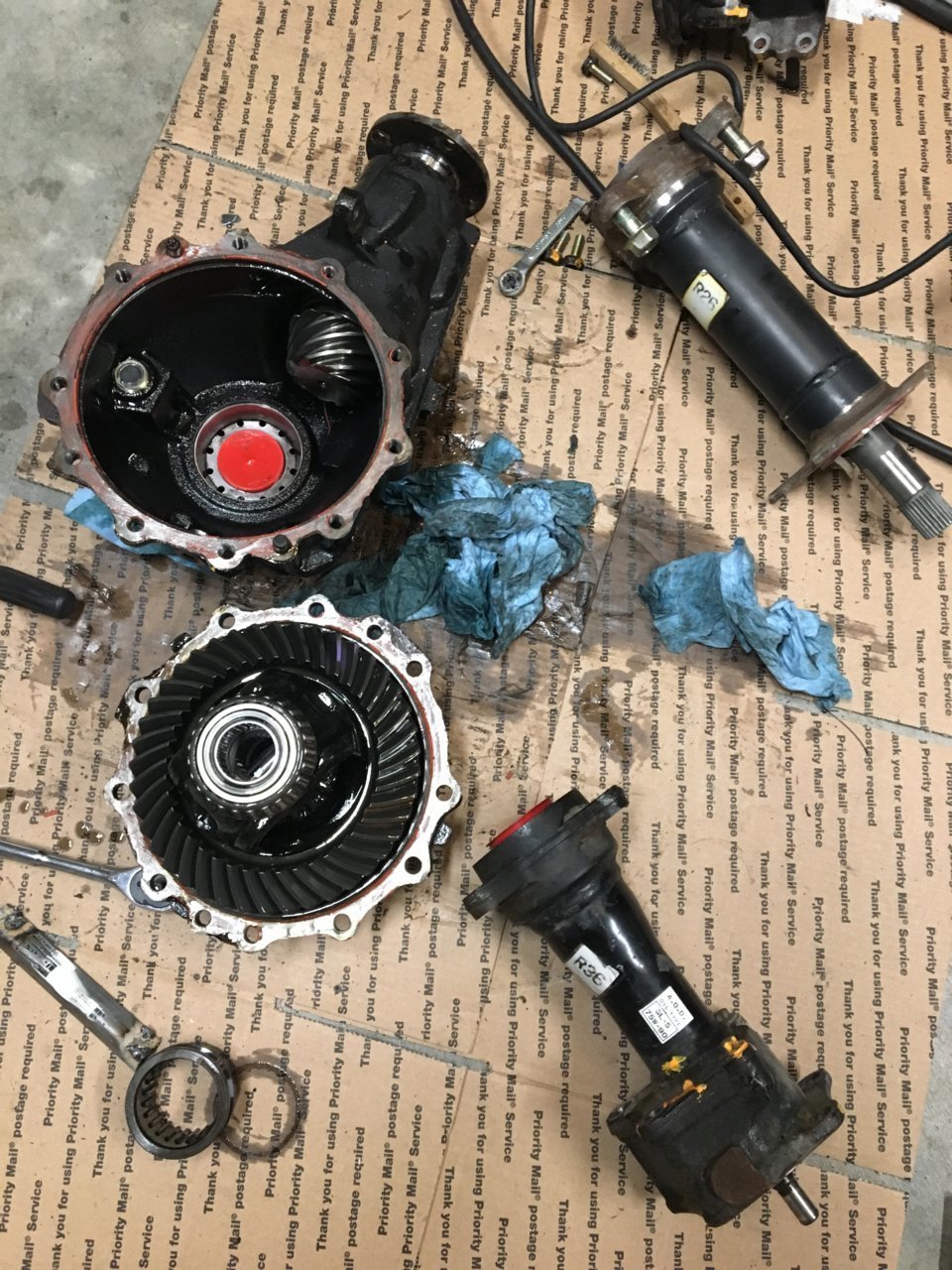

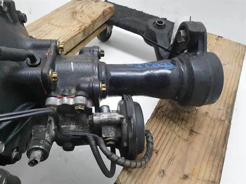

    First picture is a non-ADD tube. No actuator, just a straight tube from the cv to the clamshell. The tube is one size from end to end.
    Second picture is a ADD tube (bottom right) and non-ADD tube (top right). The ADD tube is tapered/cone shape.
    Pictures of vaccum actuator ADD tube

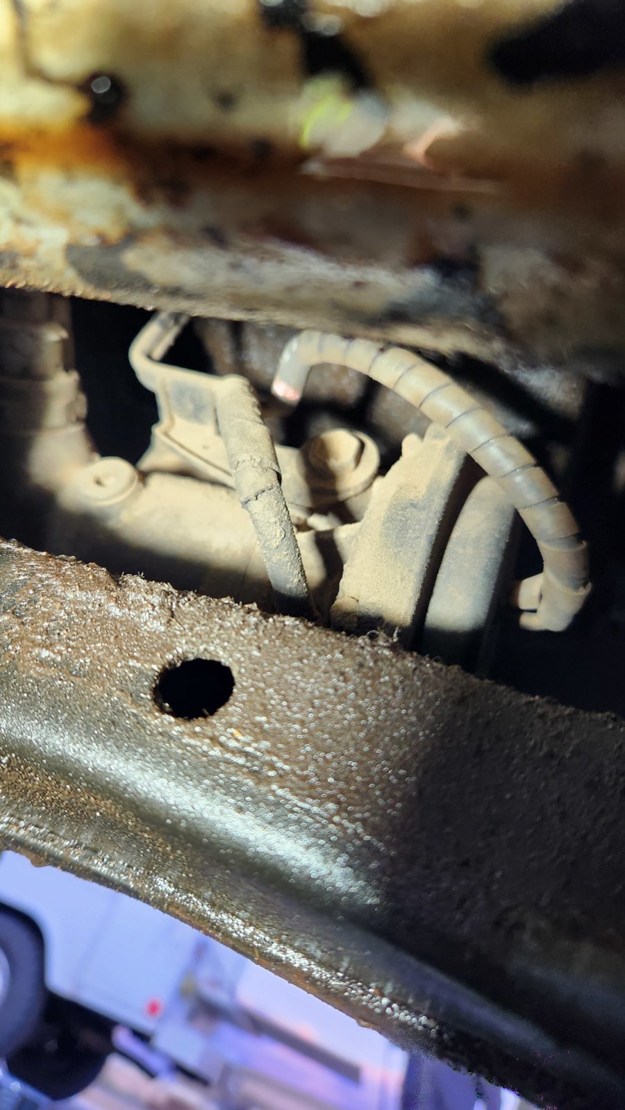

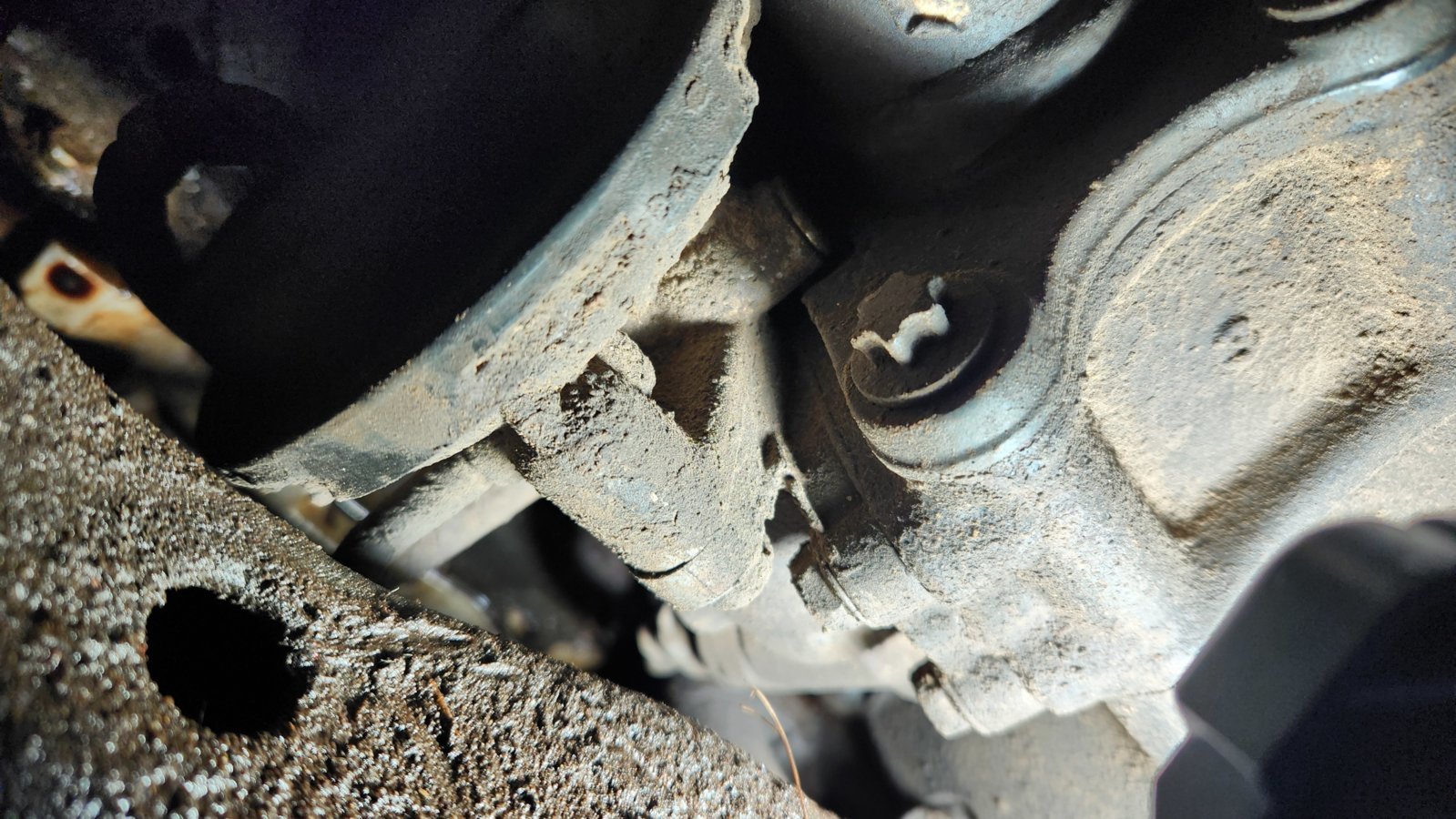

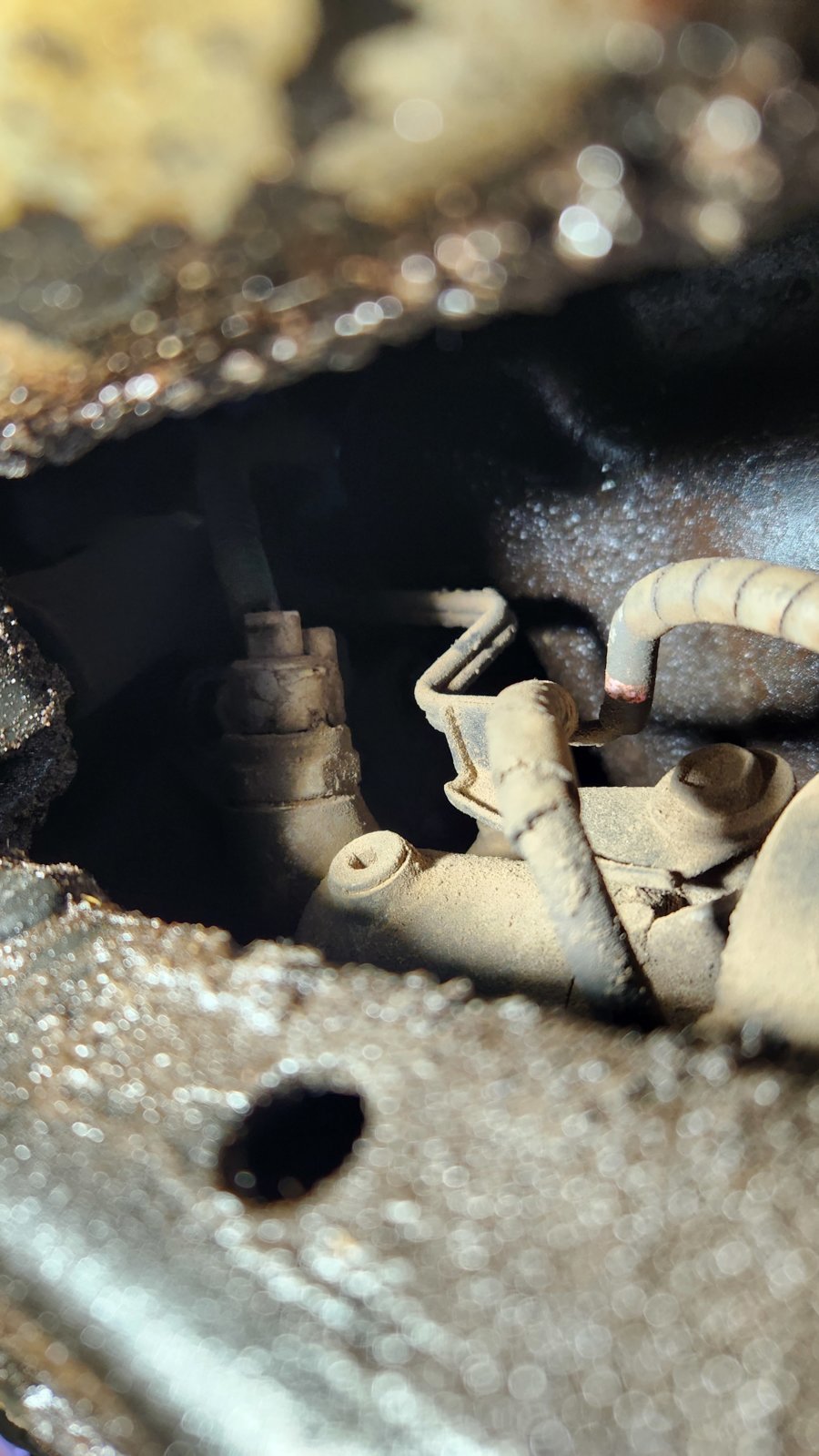

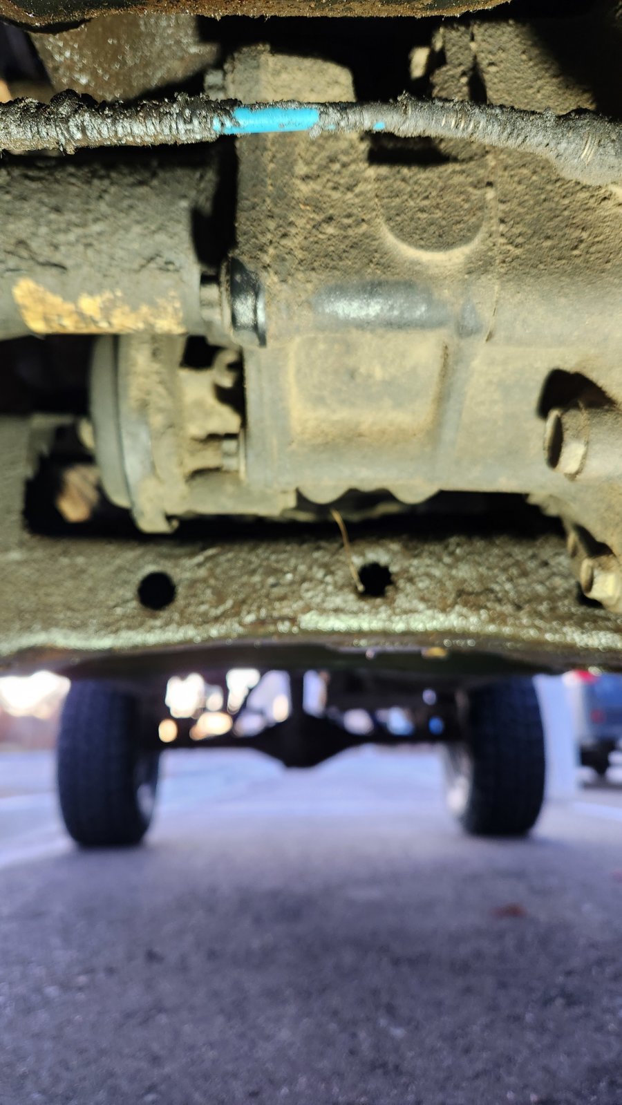

    Here's what we got.

    Also is there a part number I can find to convert it to the non add tube? For now I want to see if I can see if it is the hose clamp mode and see if it failed somehow but I would like to get the non add tube. Anywhere specific I can find one or do I have to buy the whole diff assembly to just salvage the add tube off?
