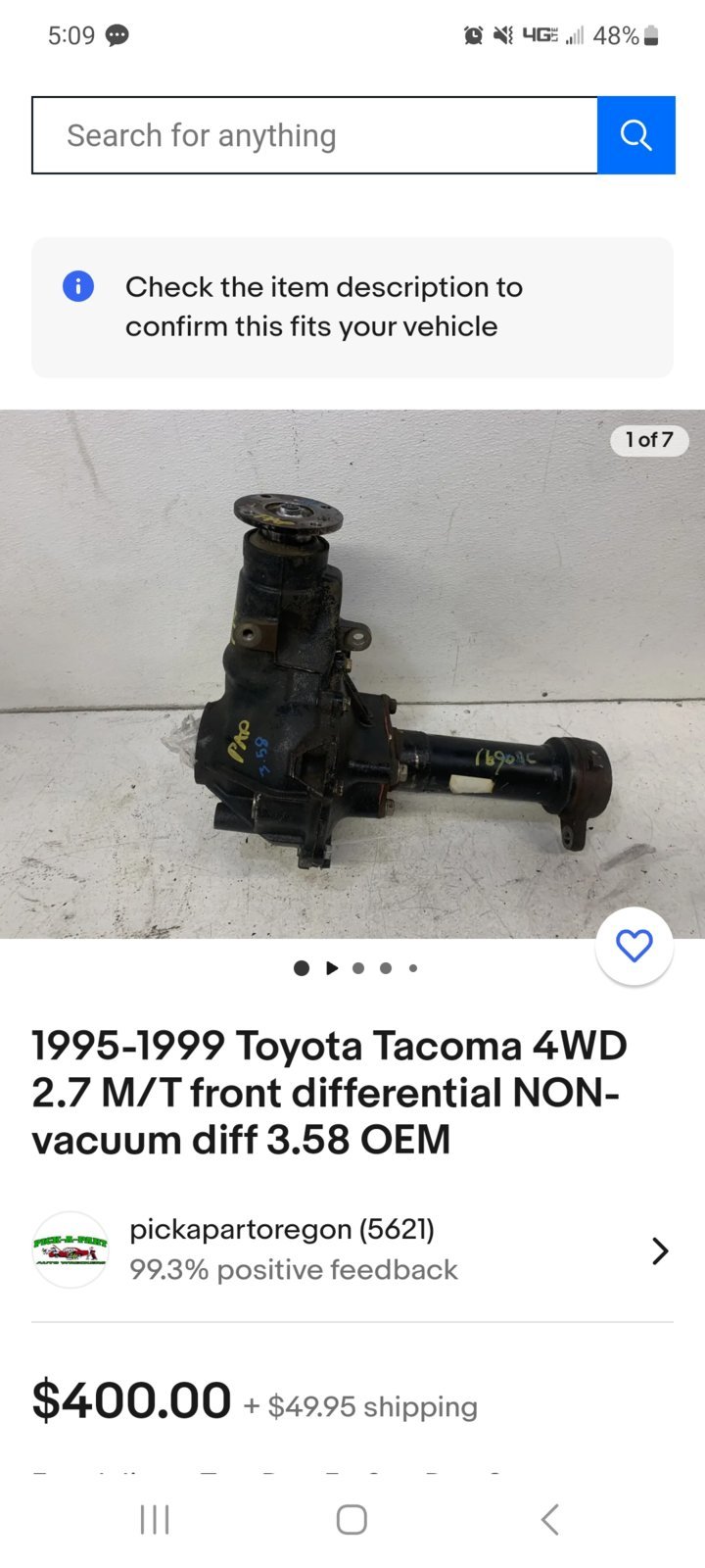

    He's gonna pay a pretty penny, think I sold mine for $200 like 3-4 years ago

    Or blow his clamshell. Read a while back that the clamp broken and pieces got lodge in the carrier being, toasting the clamshell. So yea, I rather pay a pretty penny to get it fix correct vs a bandage.

    Just $500 after tax... Ebay price is dumb
    #53
