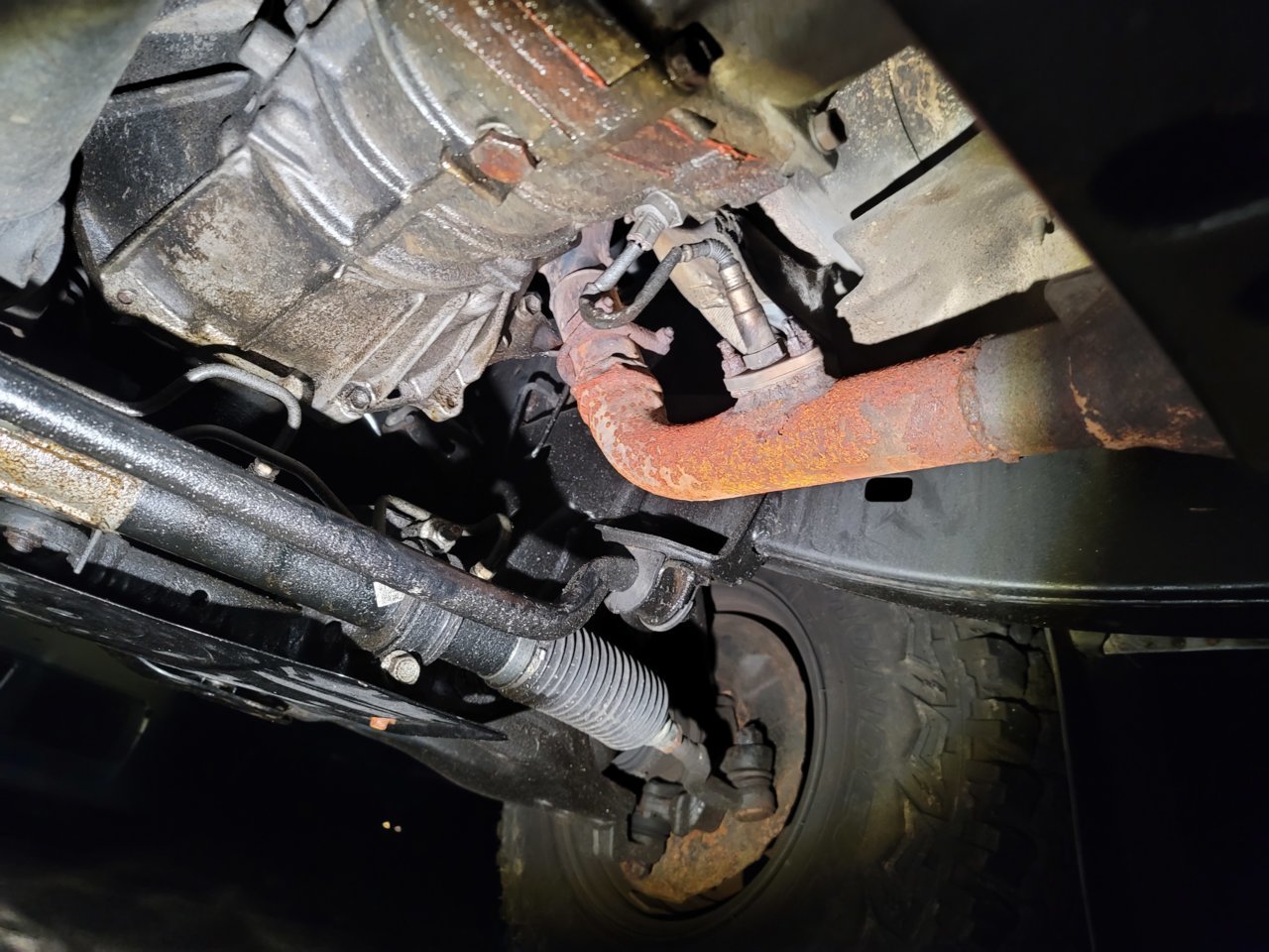

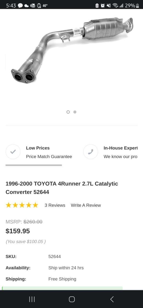

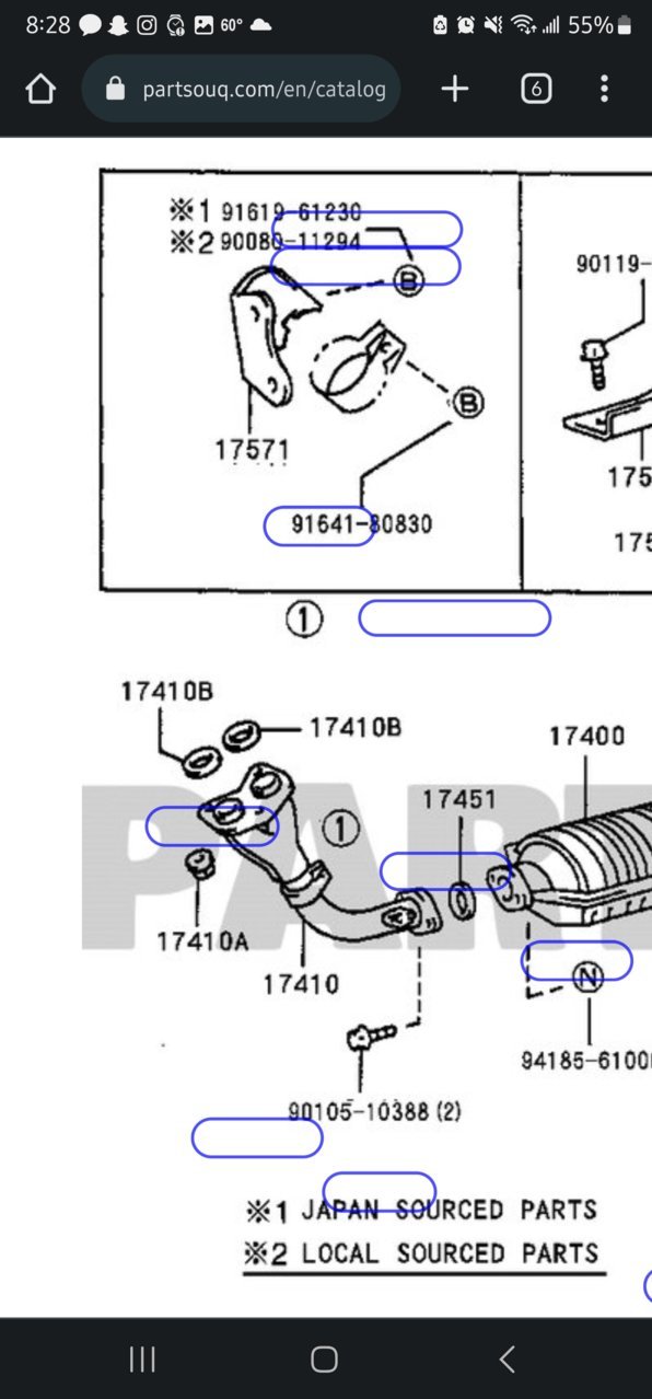

    Right! Yea I have used walker on a previous ecoboost with no fitment issues. This seems like the only 1 piece to knock 2 birds with one stone. About to just see how good their return policy is. I personally think it looks like it will fit. Attached is the oem diagram of the exhaust. 4 runner is just not separated

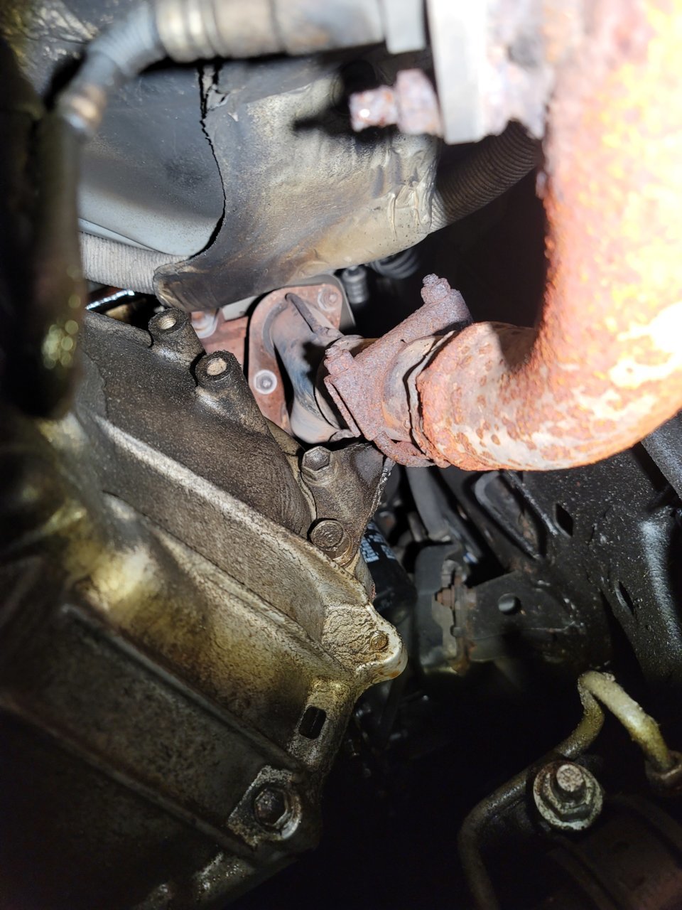

    Manifold crack is a possibility too but I am hoping not. Which brand manifold did you purchase? I am replacing y pipe because the PO cut the bottom 1 hole flange off and f$&^ing slip fit a welded exhaust section on with the cat welded in as well. I want to replace from that section back. Hoping the clogged cat is the p0420 issue but if not I will replace manifold as well
