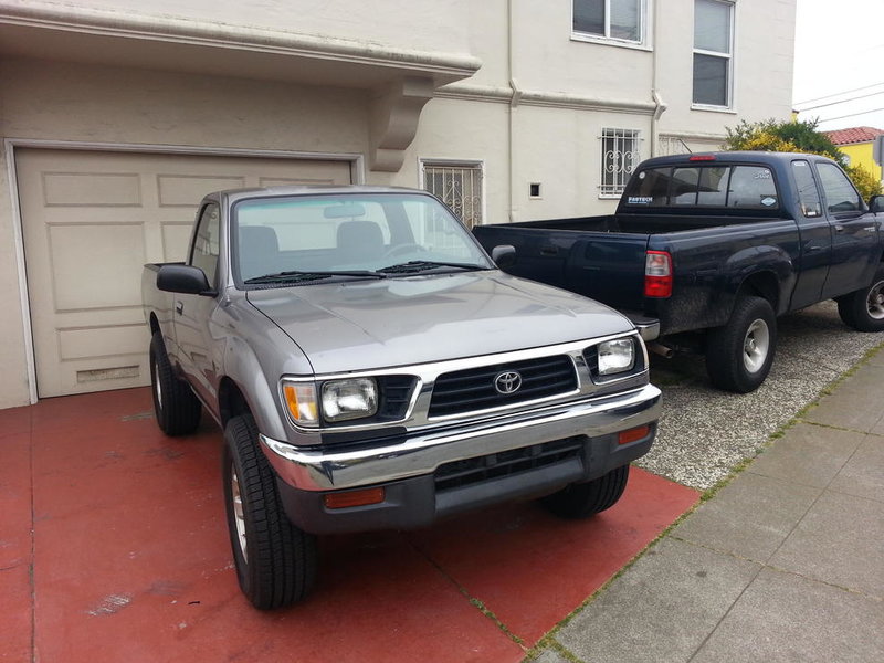

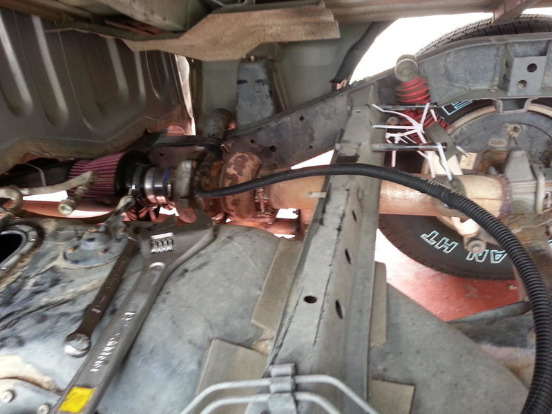

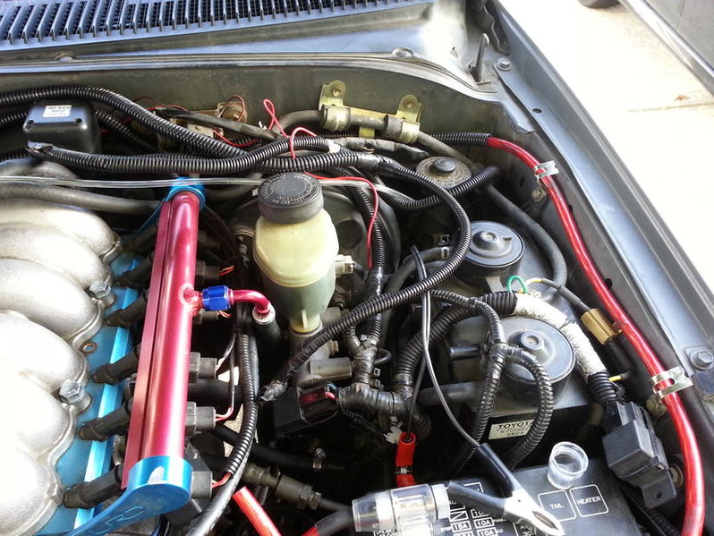

    I got a 95 tacoma regular cab that I turbocharged as well. I got lucky and got my sts turbo off of Craigslist. It was missing parts and the instructions manual by I eventually got everything to work and fit. I also installed a 97 ecu, 255 walbro, the urd turbo port fueler and mapecu3. I was having issues mapecu3 and had to send it back to urd to take a look at it. While I had the mapecu3 sent back I installed a methanol injection system and noticed that it ran pretty well at 8psi. I got my mapecu3 back like a month ago and have not found the time nor desire to reinstall it.
    By the way I hope you put a check valve between the pvc valve. You don't want boost to go into the valve cover.

    Get a catch can with a vent and just cap off the manifold fitting.

    Sick man! I have essentially the same truck and looking to do about the same. Are you using the fuel pressure thing supplied with the STS kit or now just running stock injectors w/meth?

    I'm currently using the FMU supplied with the sts kit. I'm afr are are 13 to 14 which is lean. However at WOT it goes to 10 (strange)? So I recommend the mapecu3 with the urd portfueler to get most consistency. I'm lazy right now so I haven't got around on reinstalling tuning the mapecu3. But so far my motor hasn't blow. Hahaha.

    That's awesome bro! And yeah I put that check valve in there like 4 months before the turbo
    :D
    I was debating meth injection but dayum having to deal with another resivoir and finding an uncomon chemical is not something I'd look forward to for a DD

    The issue with the PVC check valve is that when in boost, the pressure builds in the lines and forces the valve closed and the PVC valve can't vent. Basically you are pressurizing the crank all the same :notsure:.
    You need to put a vent/filter on the PVC vavle or run to a vented catch can and cap the mainfold fitting :notsure:

    I just used my windshield washer bottle as the reservoir. I'll take some pictures of it so you can have some references (maybe this weekend). When I brought the sts kit it came with the methanol system too and the harness. Again I didn't have instructions so I followed the coolingmist instructions.
    Also some good reading material from Tom at tubro mirage.
    http://www.turbomirage.com/water.html
    StAndrew, I have a oil can sitting around at home so I'll probably install per your recommendation. Or I might use the sts pvc system that I bypassed.

    StAndrew, actually I don't think I need the oil catch can. I have a breather on the driver side valve cover.

    Do most guys use this setup for strictly on road? That looks like a terrible spot for off-raod use.

    Well the kit is higher than everything else including the axles, frame, driveshaft, and even higher than the the stock muffler... So you don't have to worry about anything unless you're climbing trees :)
