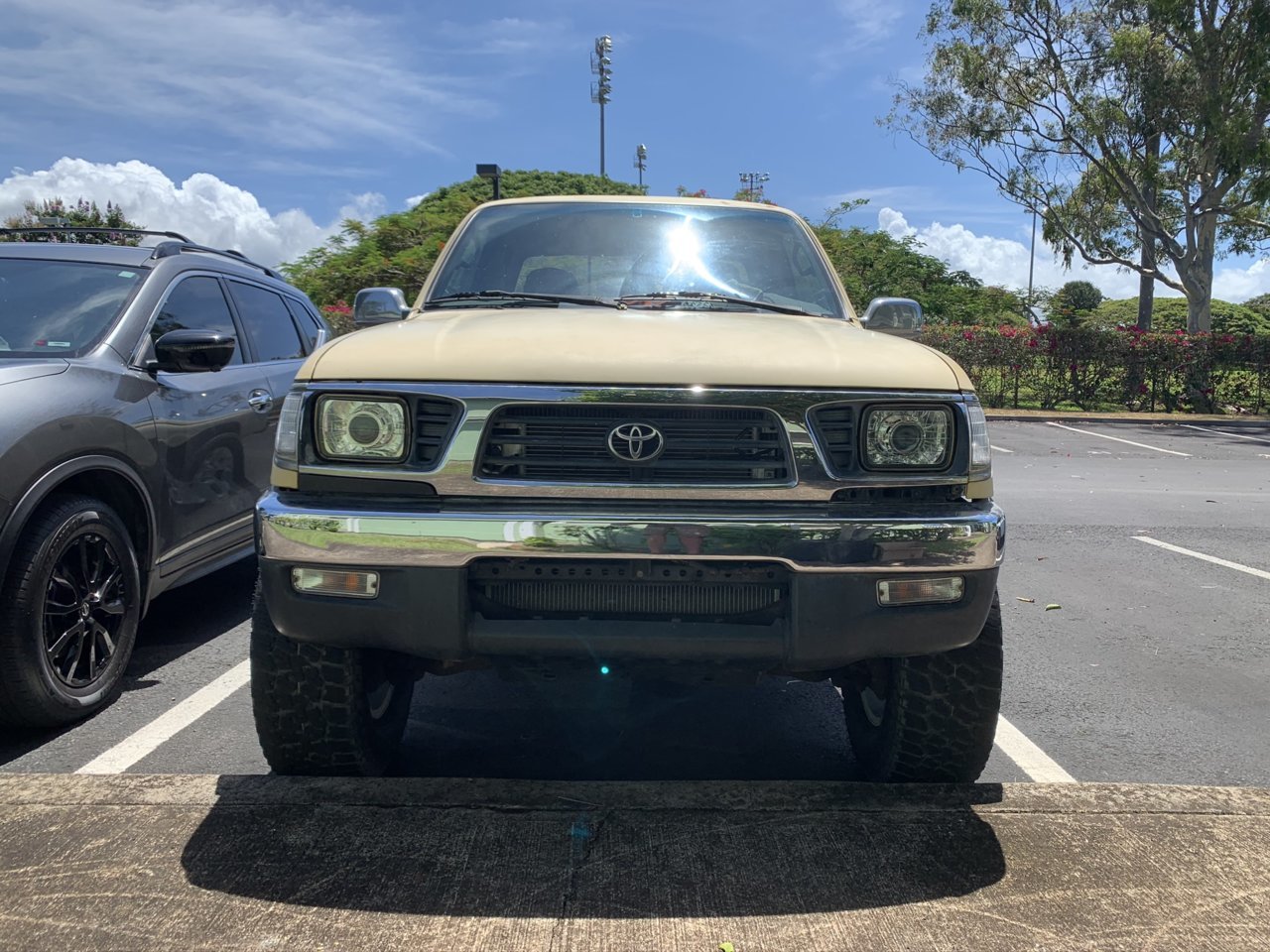

    Here’s mine I custom made. Cheap eBay housings and Amazon projectors
    Wulf likes this.
