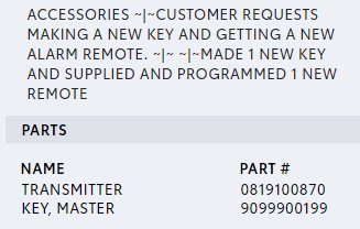

    I checked the service history of the truck and back in 05 a dealer in CA fixed an alarm short and cut a new master key and transmitter.
    Called dealer and they said that part number has been discontinued years ago. Is there another option I can use? I also don't have the master key, just the plain silver Toyota key, is the master needed to "program" the alarm to accept a new key fob if there's an alternative out there?

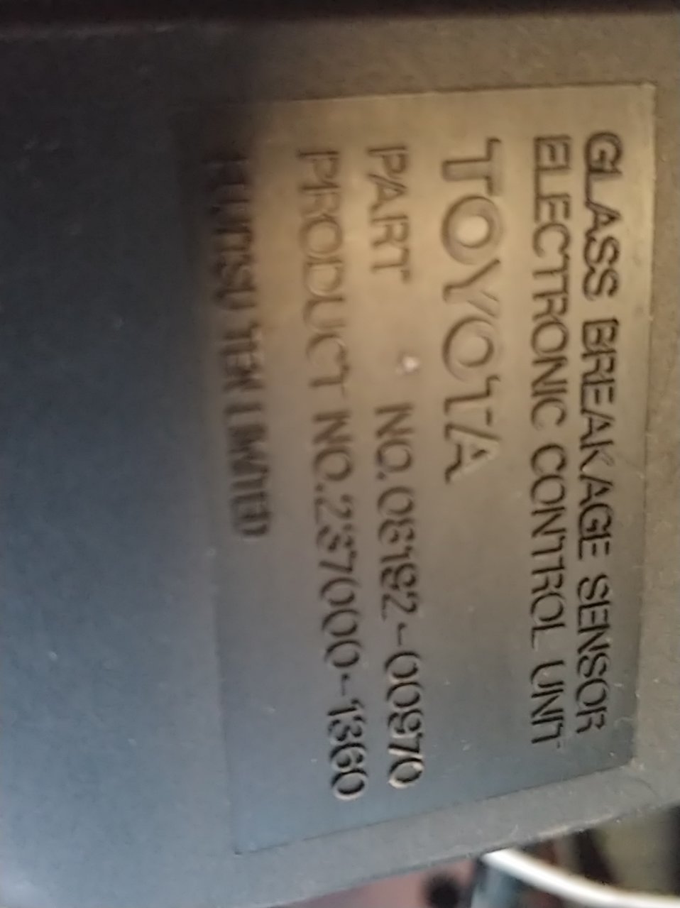

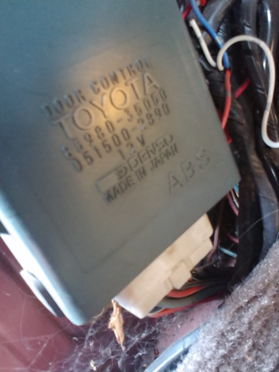

    is it different on a 95.5? i checked behind the driver kick panel and all i found was a Door Control ABS box and above that up behind the truck release lever was a glass breakage sensor. didn't see anything with FCC mentioned on it

    You can check the passenger but if you have cruise control that control box will be on the passenger side. Have a pic of the drivers side?

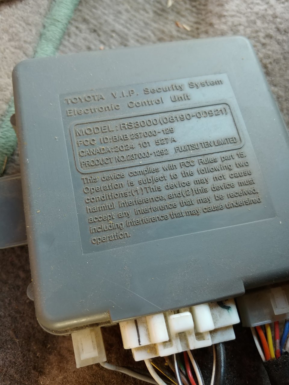

    Nevermind, i traced the wire from the little security dash light down long the door seal and found the box underneath the seat..is that a normal thing or was that custom ran?

    That's odd? I've never seen, but also never seen the abs there as I don't have it. And if it's the factory module mounted under the seat my guess is that it's factory. If you look at the wiring and mounting you should be able to tell if it was put there or not.

    So now the hunt for a key fob. it's an RS3000 system and from my googling so far i'm not seeing this specific FCC ID

    Thanks for that, i had actually found that but reading the description it doesn't actually sound like it's the right one. In the notes it says the FCC ID is BAB237131-022. Possibly mistyped it in the title. I did call my local dealer and they actually can order one for $58, i was just hoping to find one a little cheaper.

    That's the same one I have in my 97 Corolla. Same FCC ID, but my Product No. is 237000-1291 and yours is 237000-1292.
    Don't be an idiot like me and just order a remote based on it saying it works with RS3000. The transmitter changed in different years. I ordered a remote and it turned out to not work, so I had to send it back and they sent me the correct one. Just do yourself a favor and email or call wherever you are going to order a remote and let them figure out which remote will work. They will know a lot better than you what is going to work.
    Don't listen to these previous posts that say just order it and hope it works and if it doesn't you're only out "a few bucks". I'd go with the dealer part if it's not much more expensive if only so that you can walk in and return it if it doesn't work and get the correct part.
    After you get the remote do a search for RS3000 instructions. It will explain how to program it and everything else.

    I reached out to that company on eBay and this is what I got back.
    BAB237131-022 is the FCC ID on the original remote
    FCC-ID is BAB237000-129 is on Alarm box in the car
    I had a guess that might be why they had 2 IDs listed in ad. I ordered a 022 from Amazon and it gets here Friday. We'll see if it works, I'd it does was only $30, if not I'll send it back and grab the one from the dealer and be done with it.
    I've already looked up programming so just need the fob in hand and should be golden in 30 seconds, thanks guys
