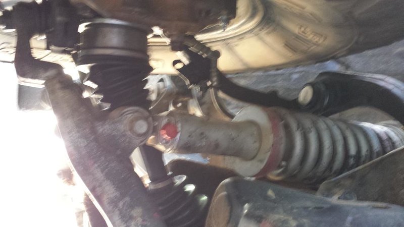

    Hello to all,
    Very aggravating issue with 4 wheel drive. This is my 4th toyota, but the first with IFS. I've replaced both cv axles and seals, cleaned the mud out of the vacuum lines and my vacuum actuator is working flawlessly. The 4x4 light comes on and the front drive shaft locks in and spins. There is no noise coming from the front differential assembly and while on jack stands I spin one wheel and the other wont move. Same effect spinning the other wheel. It feels like its engaging but obviously no 4 wheel drive... I put the axles in last night. Both are locked in with the clips but the driver's side has an 8th inch of play. Any ideas before I replace the differential?

    Ok... 4 wheels off the ground(4lo neutral) front wheels did not spin.
    Shut off engine...
    The passenger wheel catches sometimes and turns the driveshafts and back wheels (driver's side doesn't spin) engine off 4lo neutral.
    The passenger wheel will only catch something after moving it back and forth a bit, but when it does catch it will eventually let go if I dont keep momentum up by spinning it with my hand...
    Are teeth missing in my diff?

    Thanks for the link... after reading it, i am 100% certain the actuator is working... the puzzling part is the passenger wheel will catch if i rotate it by hand...(every now and then).
