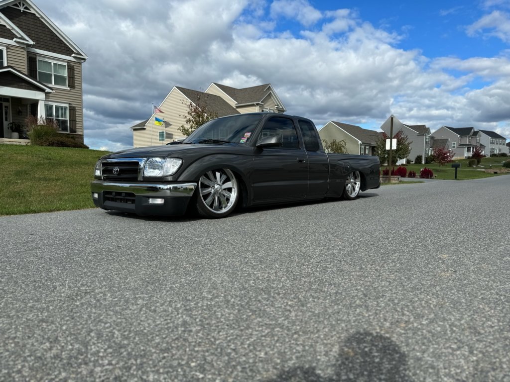

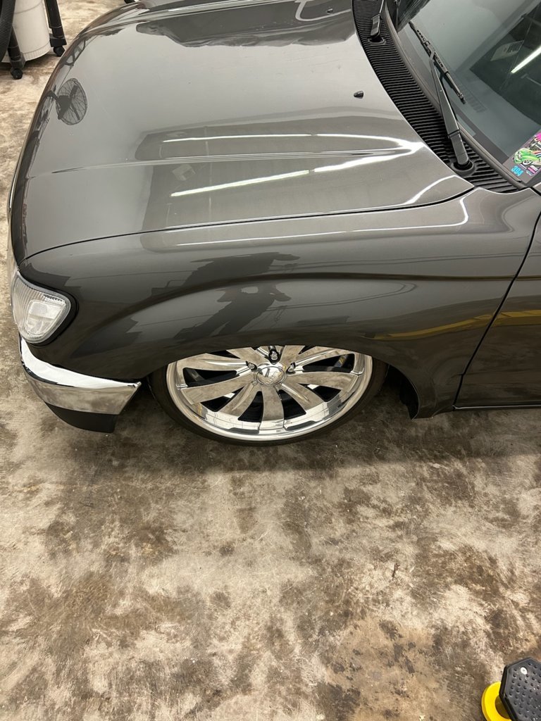

    Here's a picture of my 99 with the 95-97 4wd front bumper. I also have 4wd front fender on this truck.
