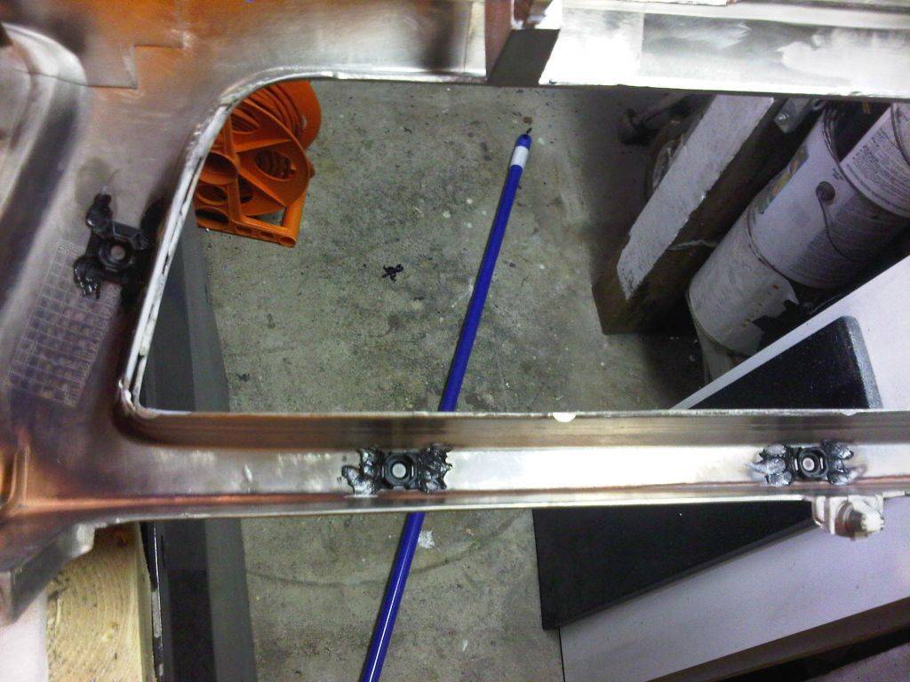

    The one-piece is really challenging... The 99' I did for MTgirl I was able to use the supports to mount the mesh but with this one there are only two on the top that I can use.:mad:

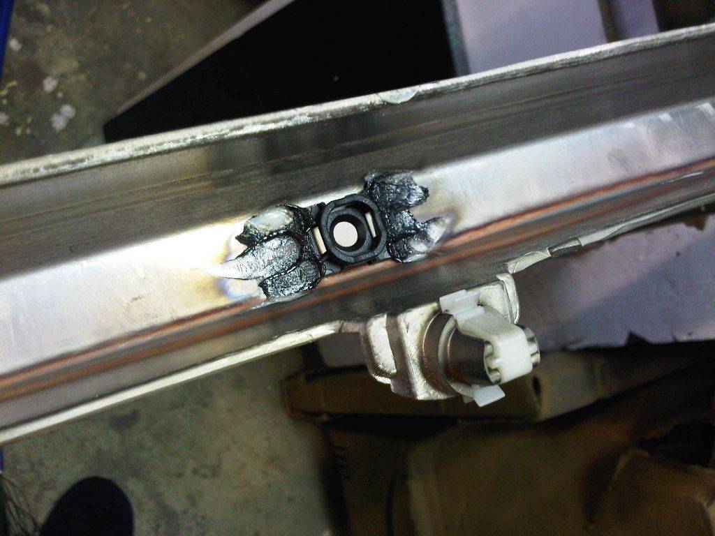

    Solution... Mounting tabs for the zip ties... I took the double sided tape off & plastic welded them to the back of the grill:

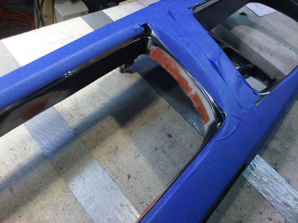

    Now, I had already formed the inner part of the main section, But since this plastic is such a PITA i had to resort to Bondo finishing putty to fill in some spots...
    I'll sand it smooth, then prime it an paint it flat black.
