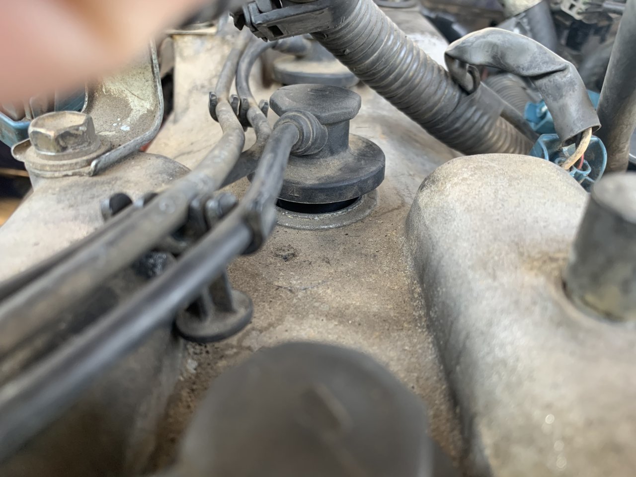

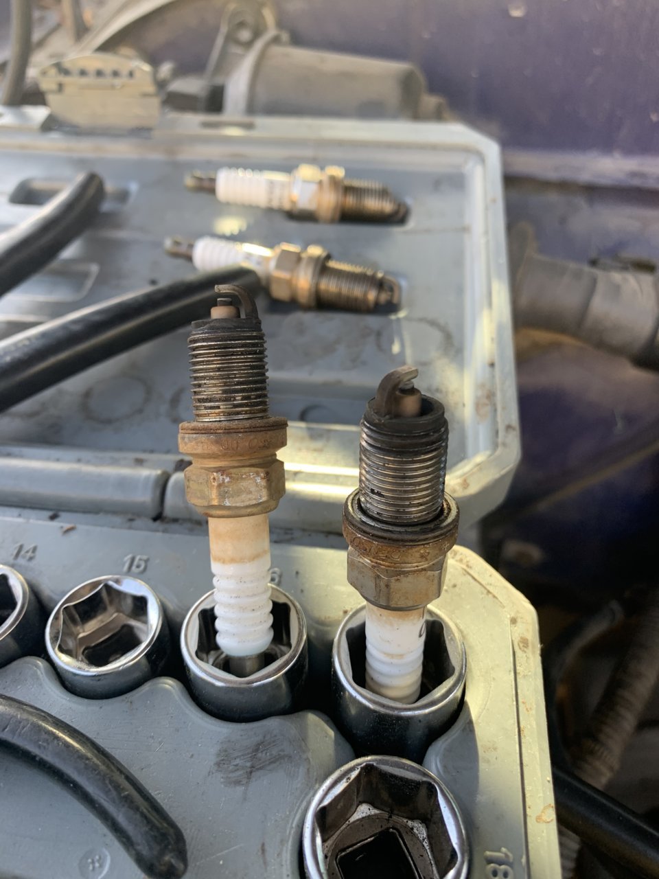

    Alright, today I installed my OEM injector back in and check on the spark and wire. The wire doesn’t sit flush to the valve cover and the spark plug has some dry wet fuel on it.
    So, after doing some quick cleaning and re-installing the old spark plug back in, the car was not hesitating or stumbling as bad. I made an order for a set of new ngk spark plugs and a Napa spark plug wire. I’ll install them tomorrow after work & update my outcome. Thanks for the help.

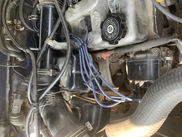

    Update. Got the new parts in and installed. Hooked up my scan tool and ran the vehicle around town and the hwy for roughly 20min with. Today temperatures outdoor was 93 degree. Finally, No more check engine lights, struggle from a complete stop, & engine death after warmup.
    This whole journey with this taco started with the “die in the heat after warm up” issue.
    Helpful replacement parts that slowly lead me to resolving this issue is:
    1. Replace IACV - malfunction after testing
    2. Replacing the ignition igniter
    3. Replacing the spark plug, wires, caps, & rotor. Hopefully this also helps other taco owner with this issue too.
    Thanks Tacomaworld friends for helping me to diagnose and resolve my issue.
