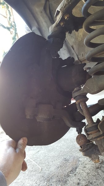

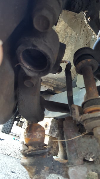

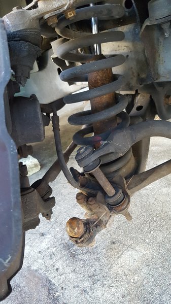

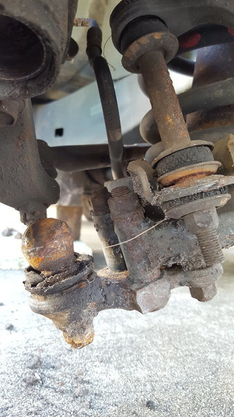

    Hey guys, now to this forum. I was given a 95 single cab for free from my wife's uncle. only down side is that the right front ball joints apparently failed on him. so he went out and got a new one, ha. I have pictures of the damage. I wanted to get opinions on how extensive the damage is and this is all I have for pictures .20161209_151709.jpg 20161209_151737.jpg 20161209_151756.jpg 20161209_151745.jpg 20161209_151709.jpg 20161209_151737.jpg 20161209_151756.jpg 20161209_151745.jpg

    Make sure tie rod and steering rack isnt damaged.
    Id replace both lower and upper balljoints just to be on safe side

    Well considering it is a 2wd 5lug the damage should be minimal. Check the steering rack to make sure it is still attached and not bent. Change all four BJs when you get around to it with OEM BJs.

    I would change both sides, lower and upper ball joints. Inner and outer tie rods also.

    You need to replace the rubber spacers on the sway bar, they look all cracked and rotting
