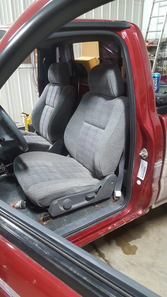

    Sneak peek I guess haha. I'll be a couple days before I get to final fitment and the whole process documented. 20170314_205512.jpg

    Damn they look more comfortable than first gen seats.

    They are fairly comfy. I don't think I'd recommend them to anyone who already has issues with leg room. They work for me because I had the bench a couple notches from full extention anyways. I just have to make a couple plates and figure out what I'm going to do for a console. 20170315_094058.jpg
