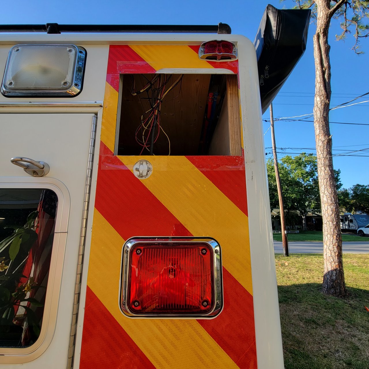

    So the red stripes are actually painted on the only decals are the reflective material/ flags.

    I made covers out of 1/8" aluminum that replaced the lenses and used the existing gaskets as they were still watertight. Everything worked (lights & sirens) when purchased but now only sirens work. All of my switches are in the center console. I will post a pic on my next update.

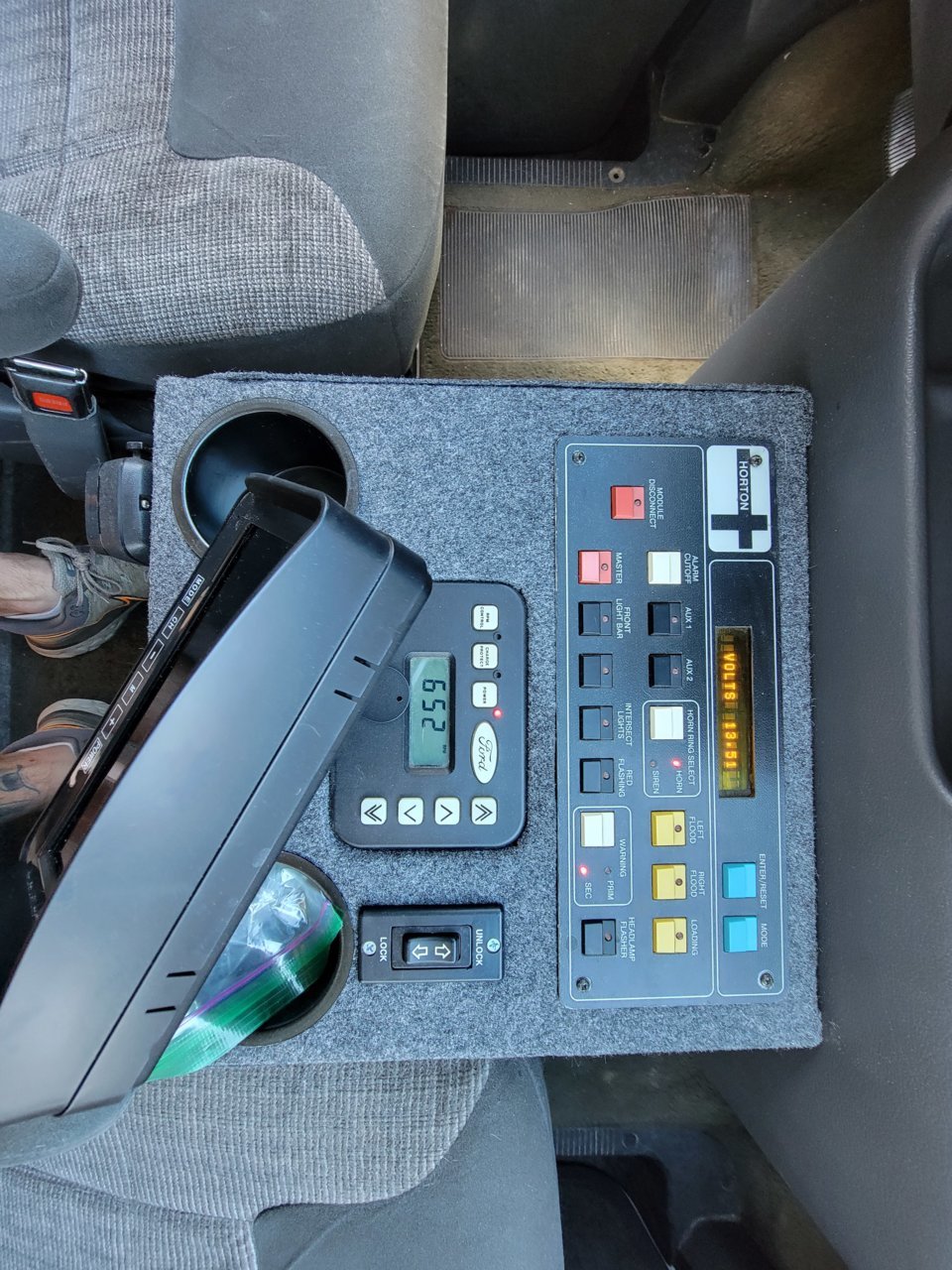

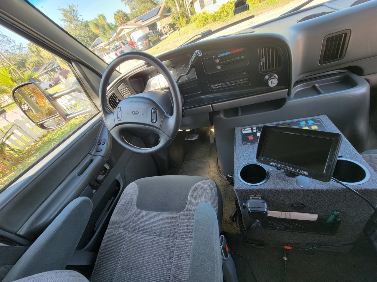

    The center console was one of the first things I made for the ambulance. The original one was small, made of aluminum and didn't have cup holders. Plus, it blocked the factory cup holders.
    Now I have the factory dash pull out and two in the center console.
    The console is attached to the doghouse via the existing brackets from the old center console.

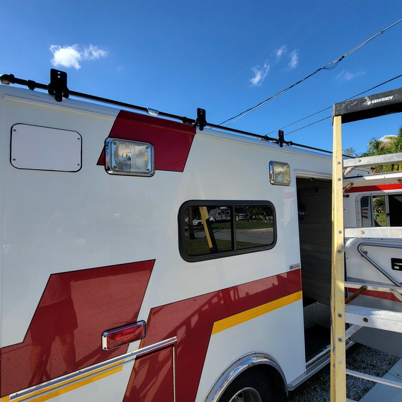

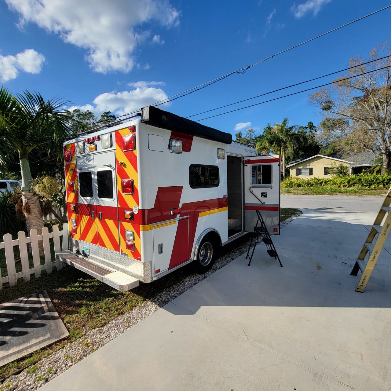

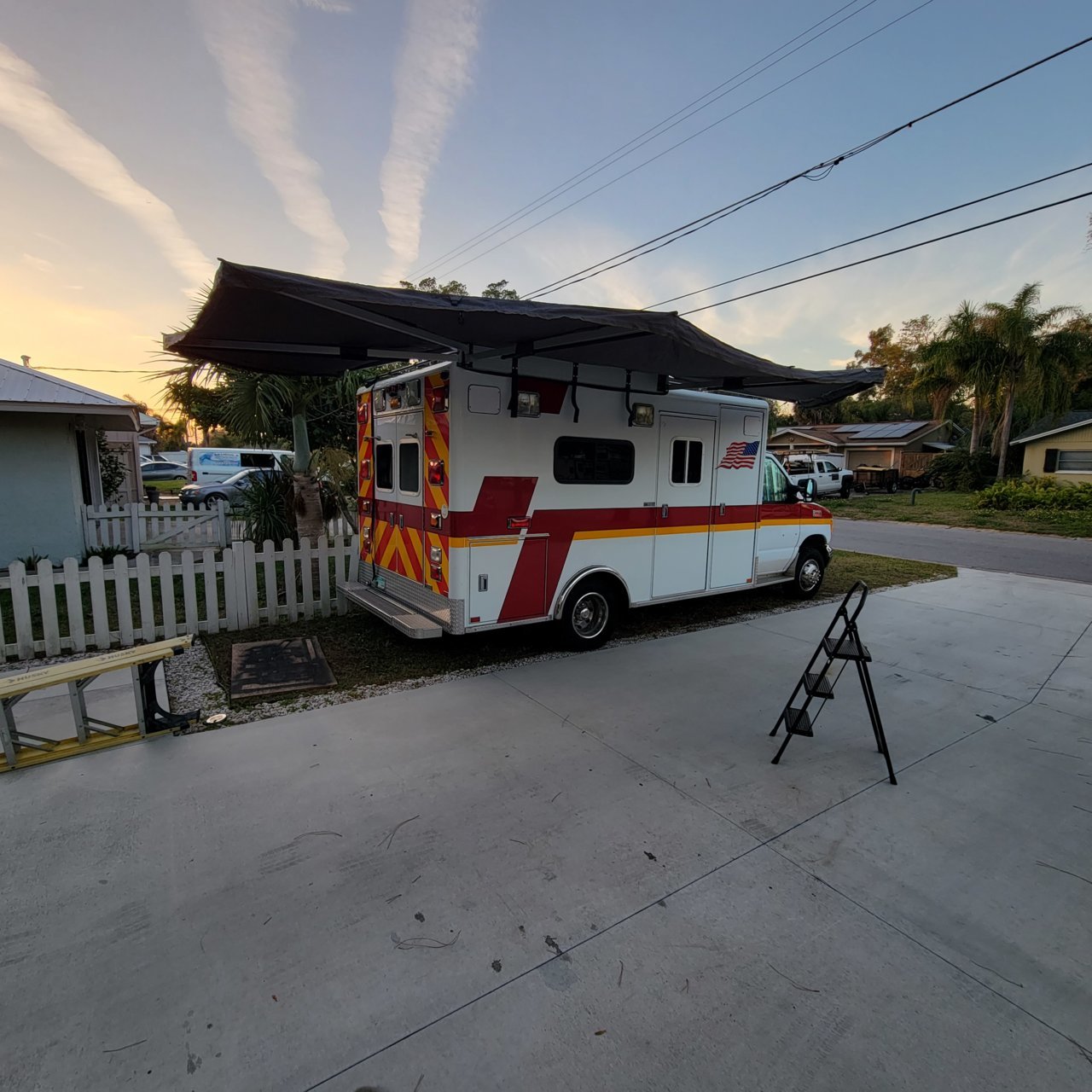

    Awning came in last night and I didn't have work today so that got installed!
    The awning is a Overland Vehicle Systems Nomadic 270 awning.
    Brackets installed.
    Awning installed.
    Pictures of it open are gonna have to wait though, it's super windy and face the gusts right now. But I did open it and it's huge lol.

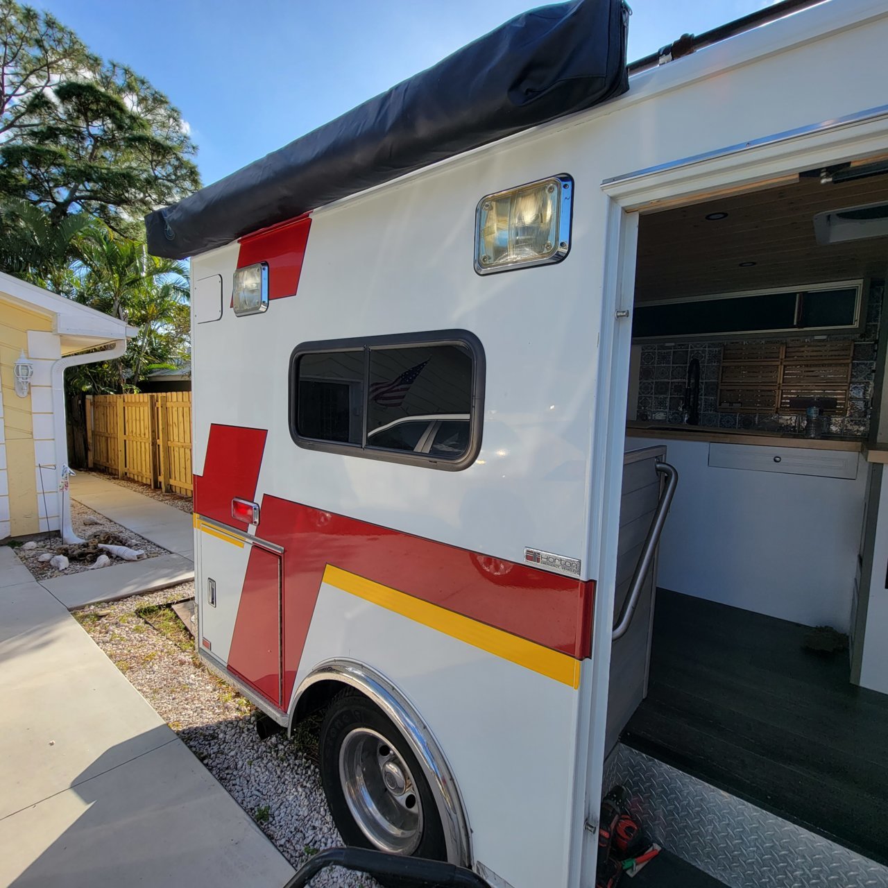

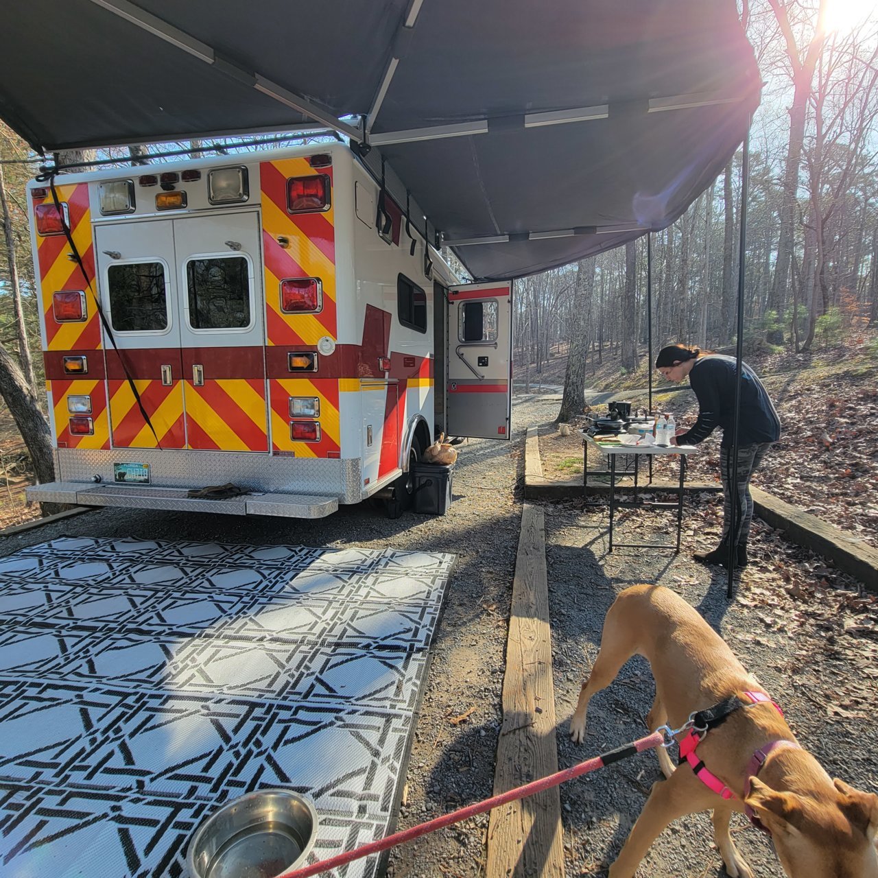

    Well winds have died down so I popped the awning open again. Super pleased with everything so far. Opening and closing is a breeze and even getting everything out back in the cover is easy.
    There is a rain guard I need to put on that covers from the door forward. But man is this thing huge.
    Biggest selling point for me was that I don't need to use the support poles unless conditions become unfavorable.
    Also plan on getting the zip on walls either through this manufacturer when they become available, or I will just get some made.

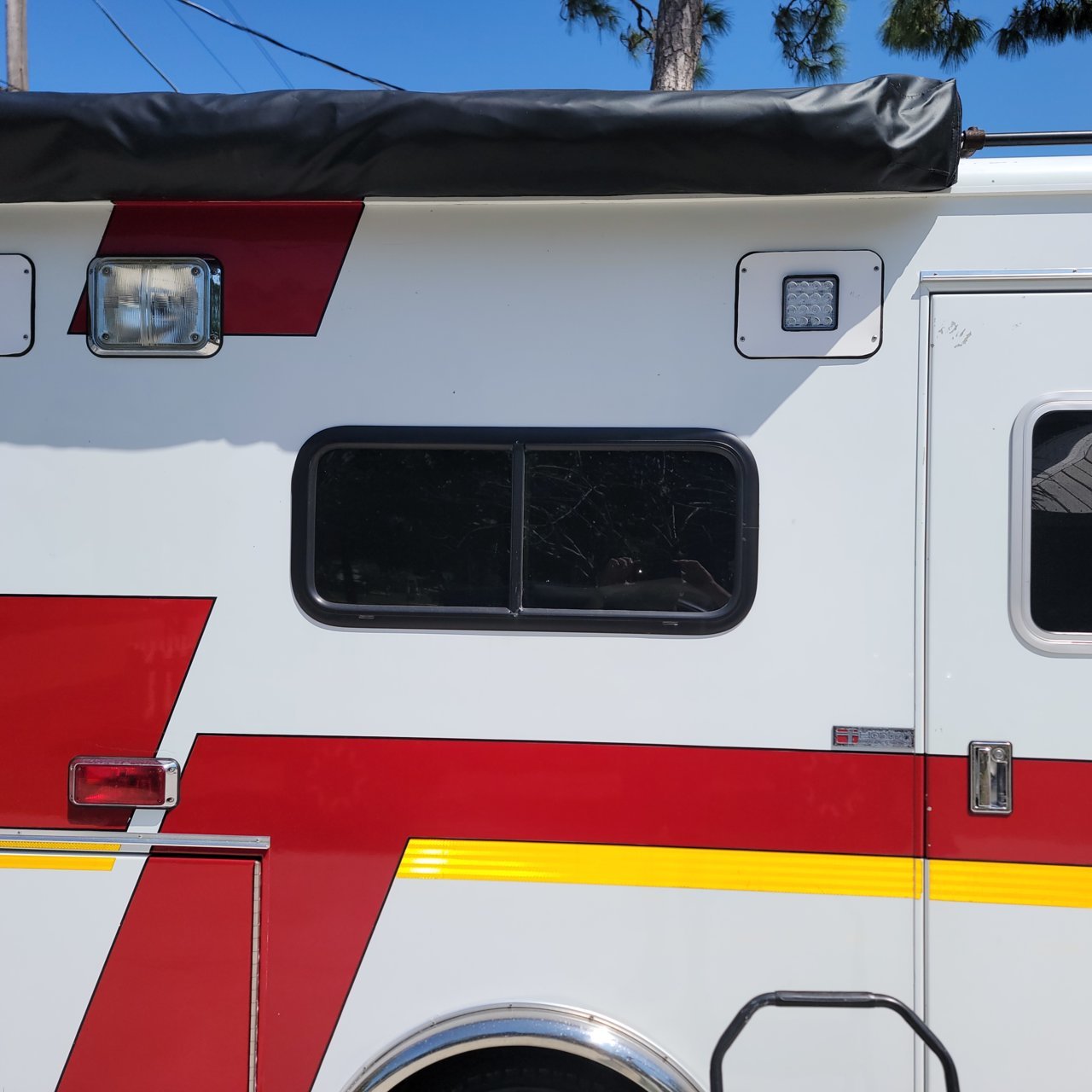

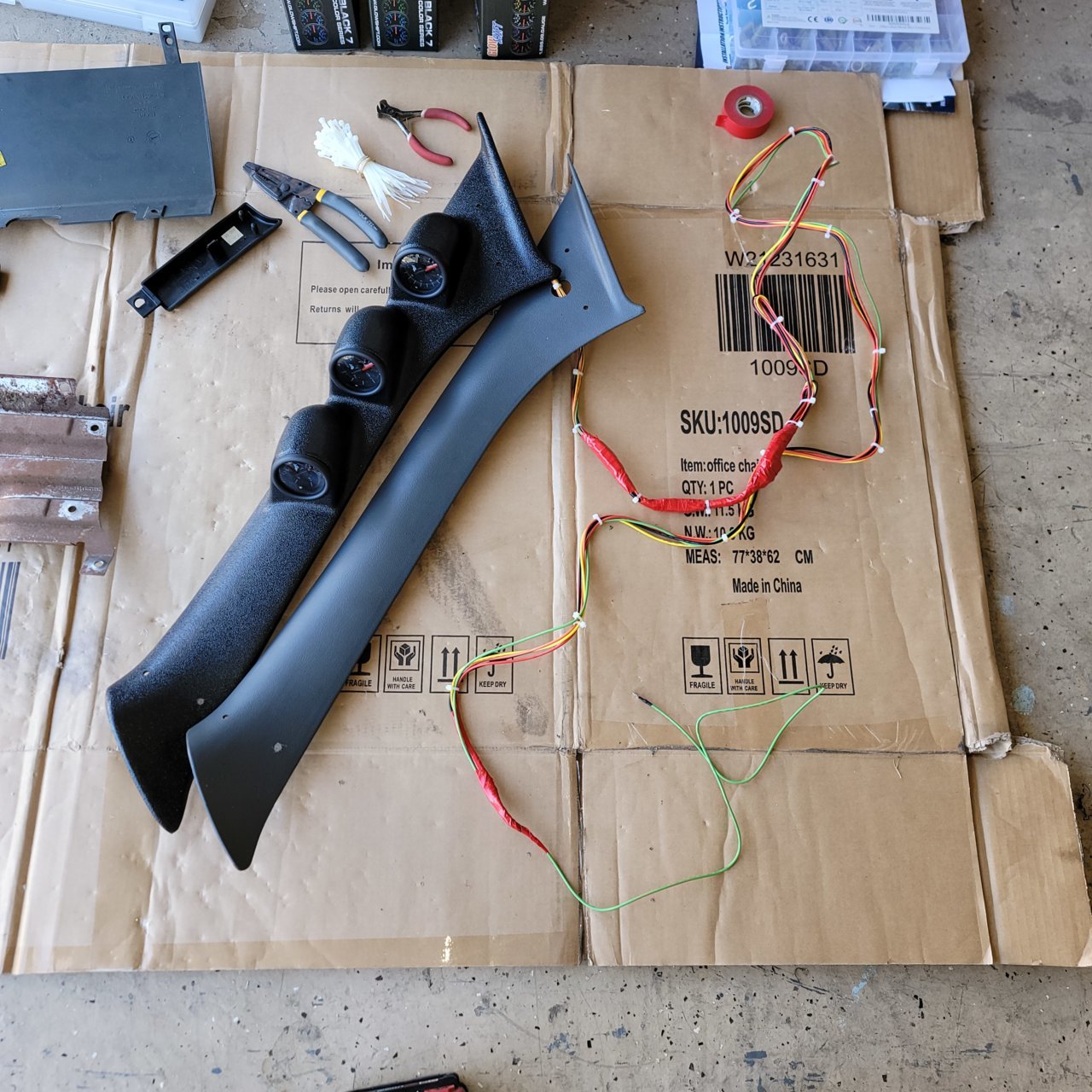

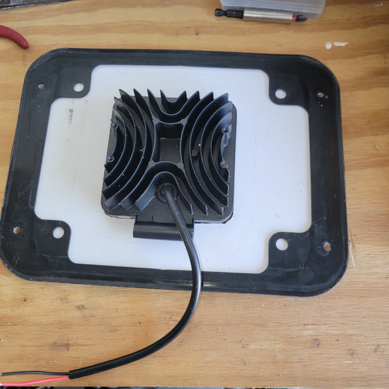

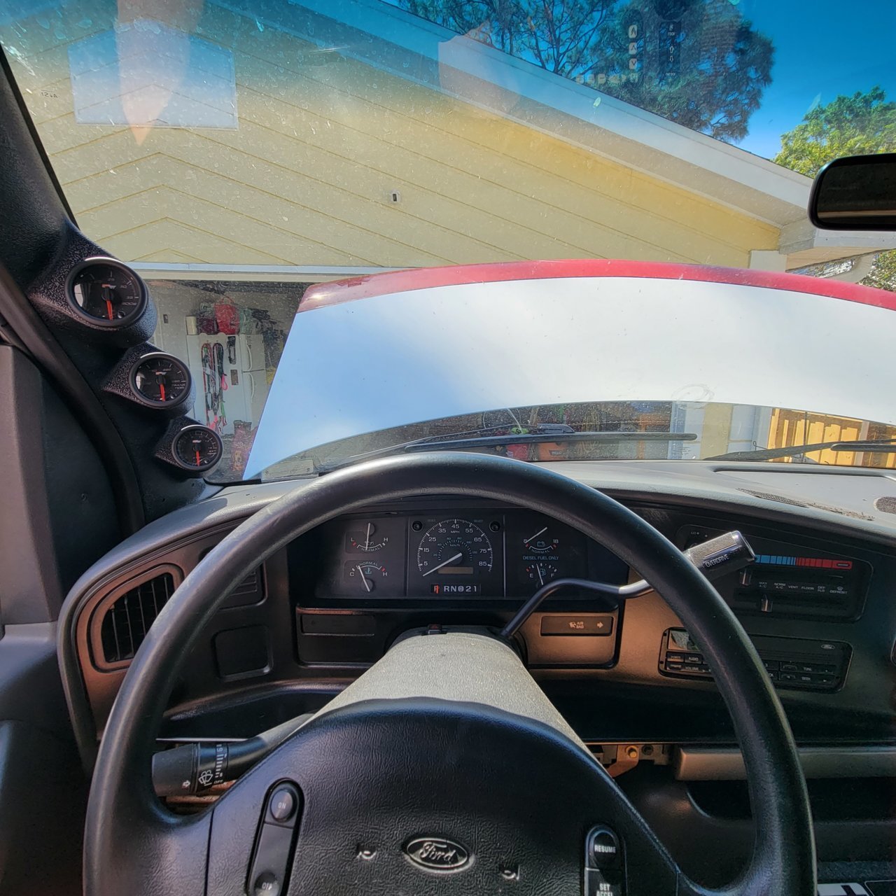

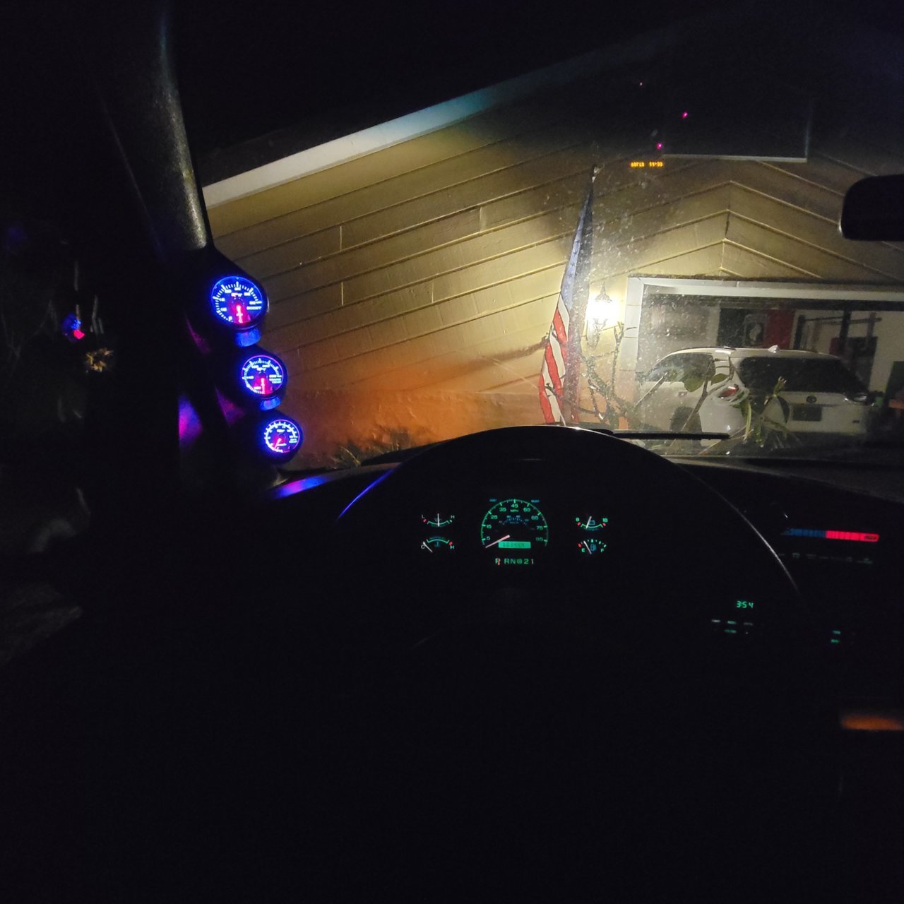

    Added some gauges so I can monitor trans, egt, and boost.

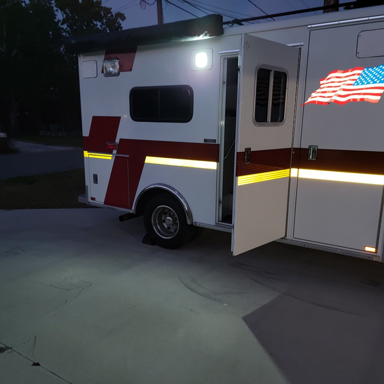

    Also changed out one of the scene lights with an led flood lights. Made a plate that uses the same gasket and holes as the lights and cut a hole in it for the led.
    Was gonna put two on each side, but one is pretty bright.

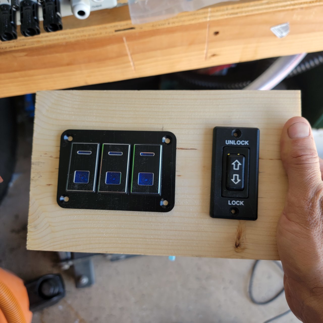

    3/30 Update:

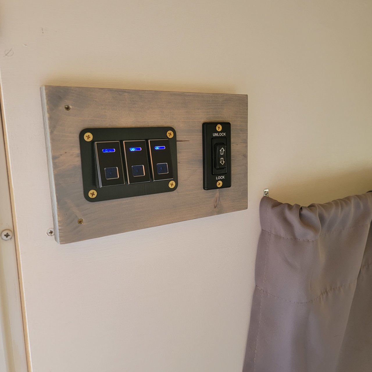

    Changed out the switch panel for the flood lights and interior lighting.

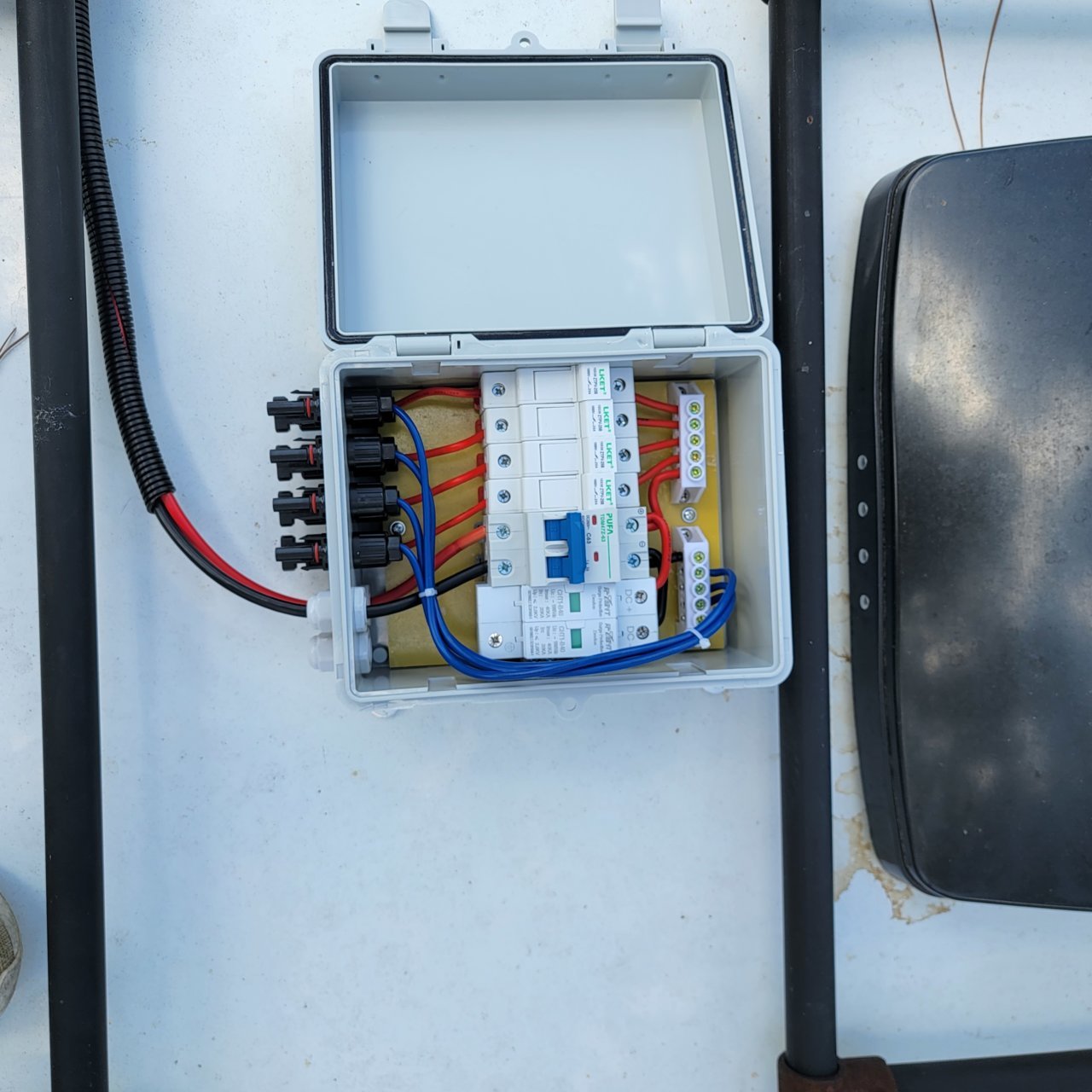

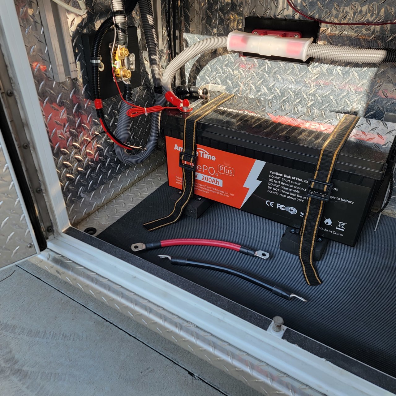

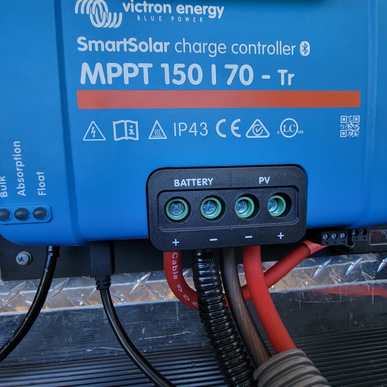

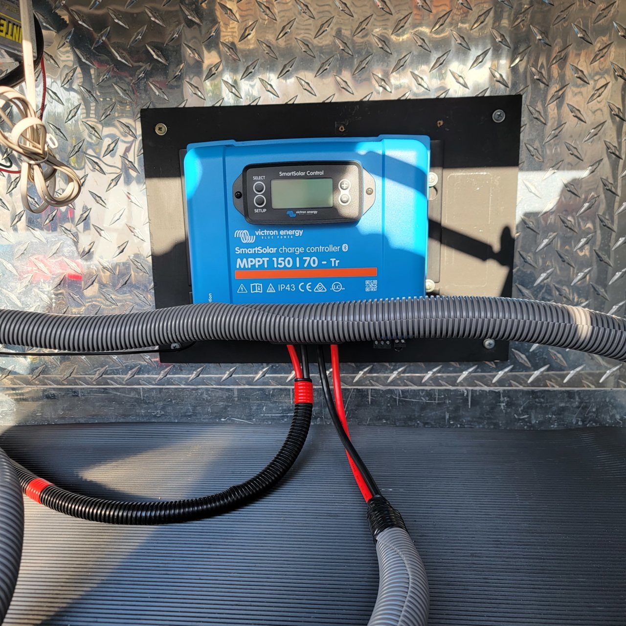

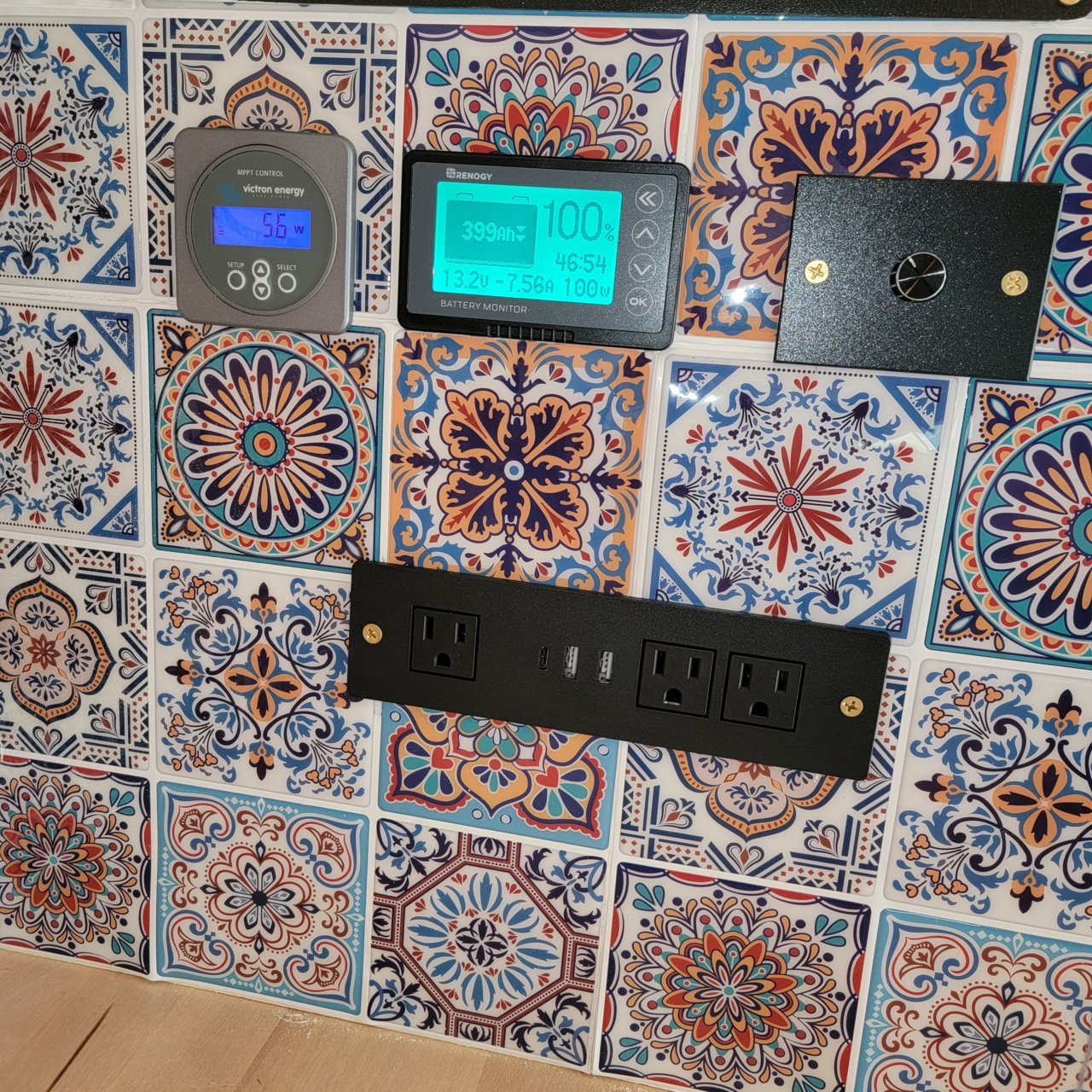

    Also started installing the solar components.
    Solar pv combiner / breaker box.
    Solar Charge controller.
    Just waiting on my second battery to arrive this weekend.
    Panels will probably go on this weekend as well.
  16. Apr 13, 2023 at 5:20 PM
    #56
    Tanselow
    Tanselow [OP] Well-Known Member
    Dec 2, 2013
    #117781
    276
    22 trd or

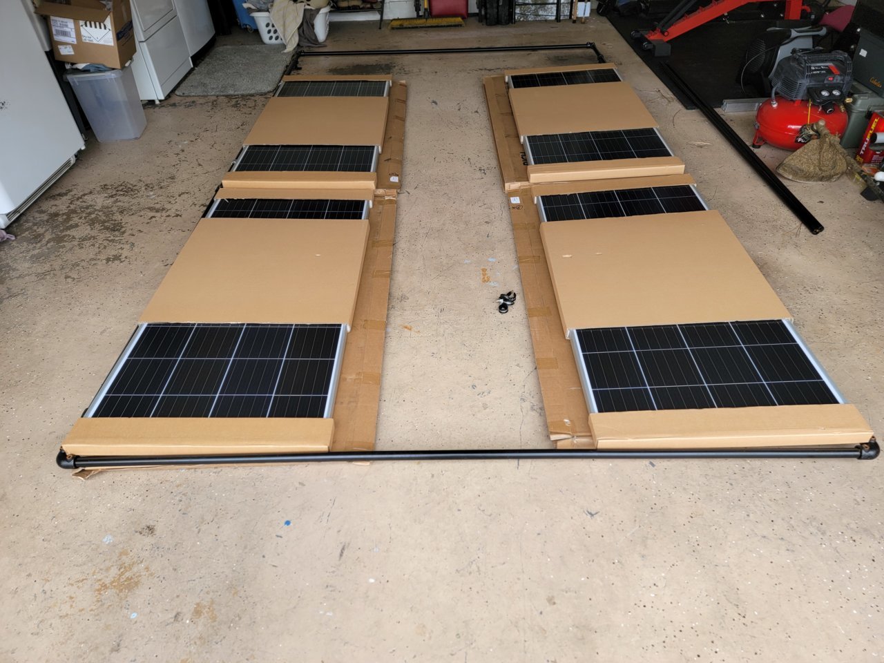

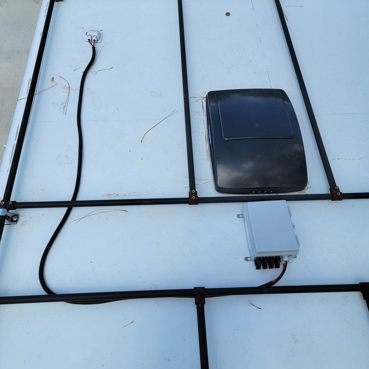

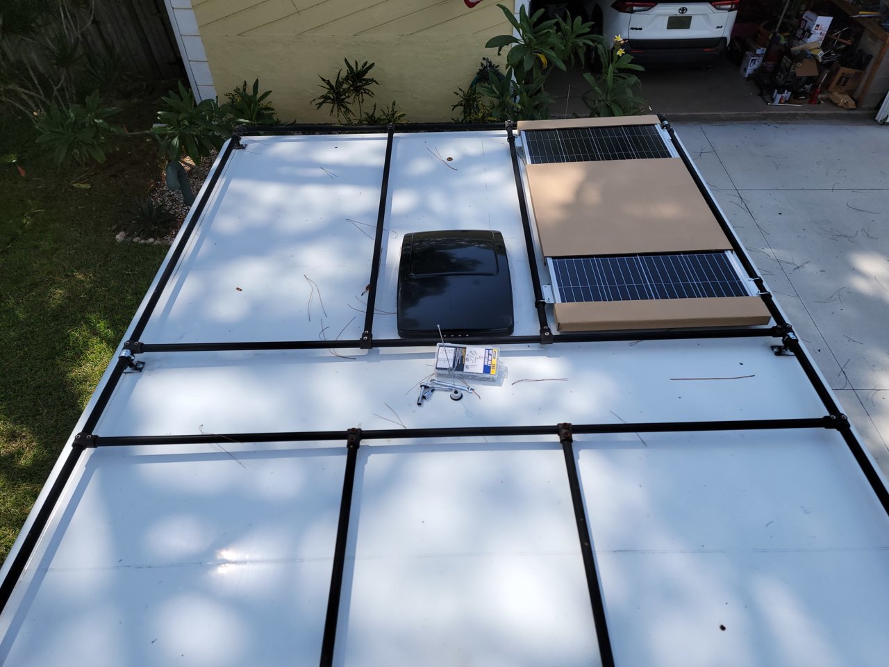

    4/13/23 Update:
    Ended up changing out all the wiring for the solar to 4 awg from 10 awg.
    Also got most of the panels installed.
    Also got both batteries hooked up. 400ah total.
    And some little interior changes.

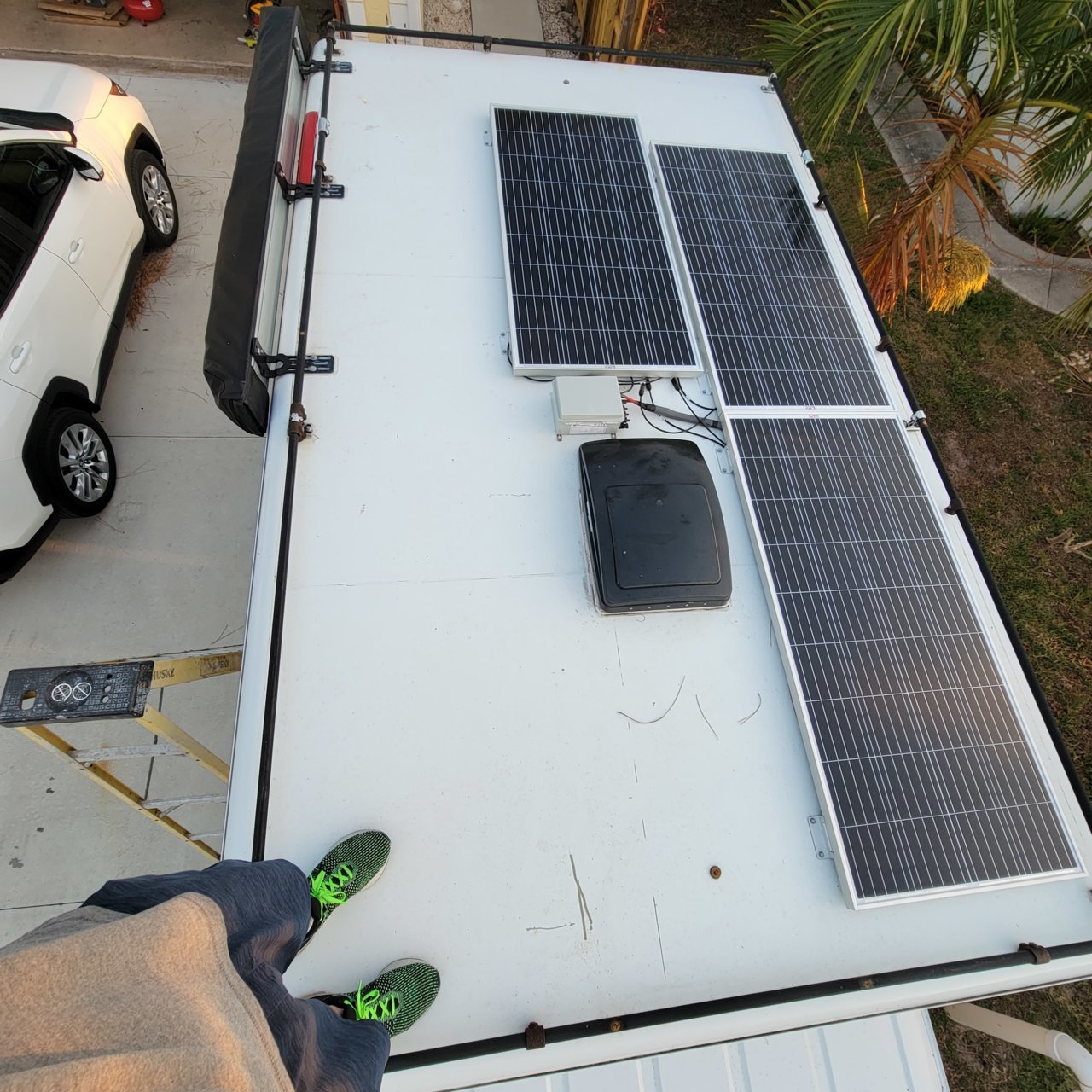

    4/15/23 Update:
    Plugged in the solar this morning. Only 3 panels installed right now (600w).
    Turned on all my 12v in the box with batteries turned off. Everything runs with just solar power. Obviously any real load on the inverter will require battery power. And at night *

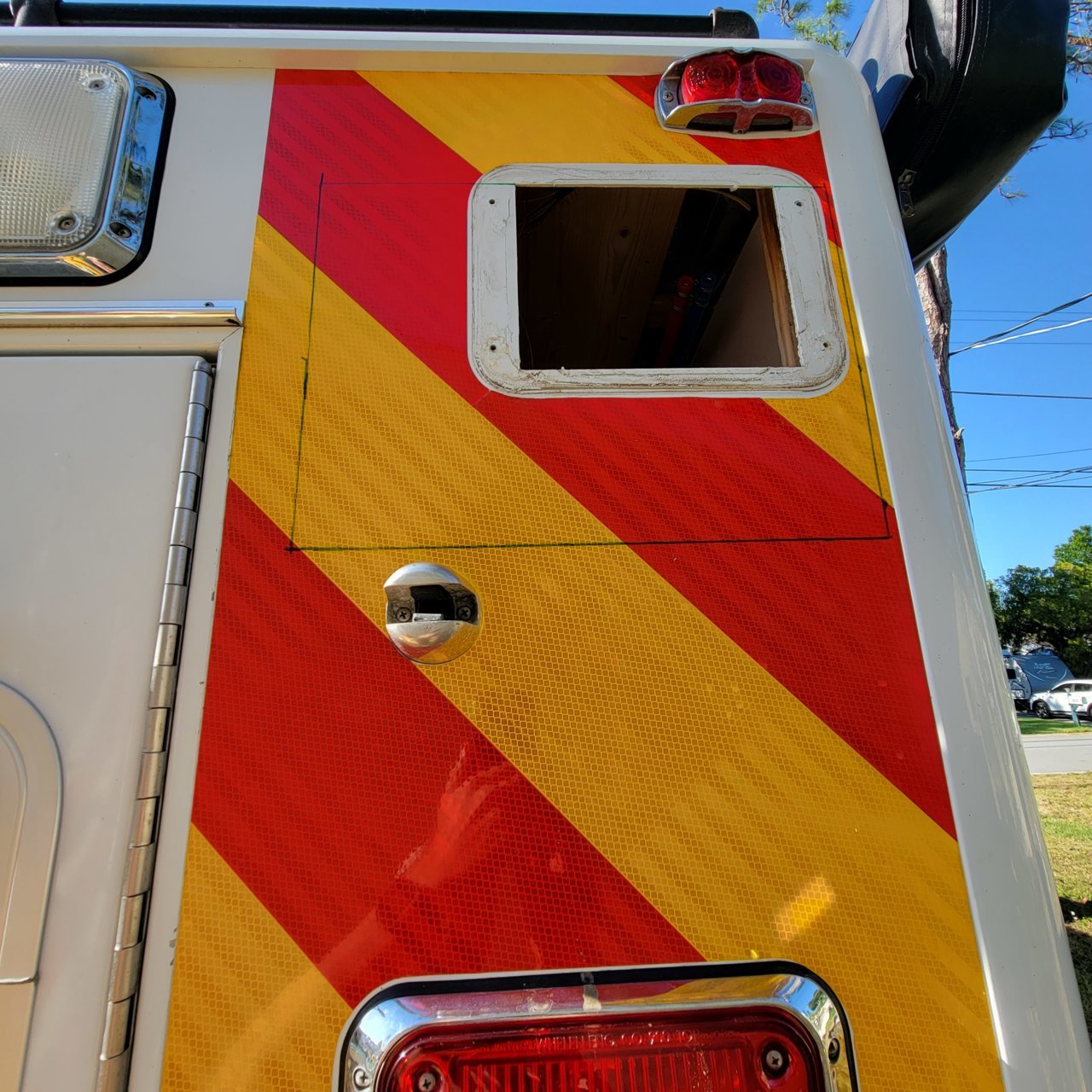

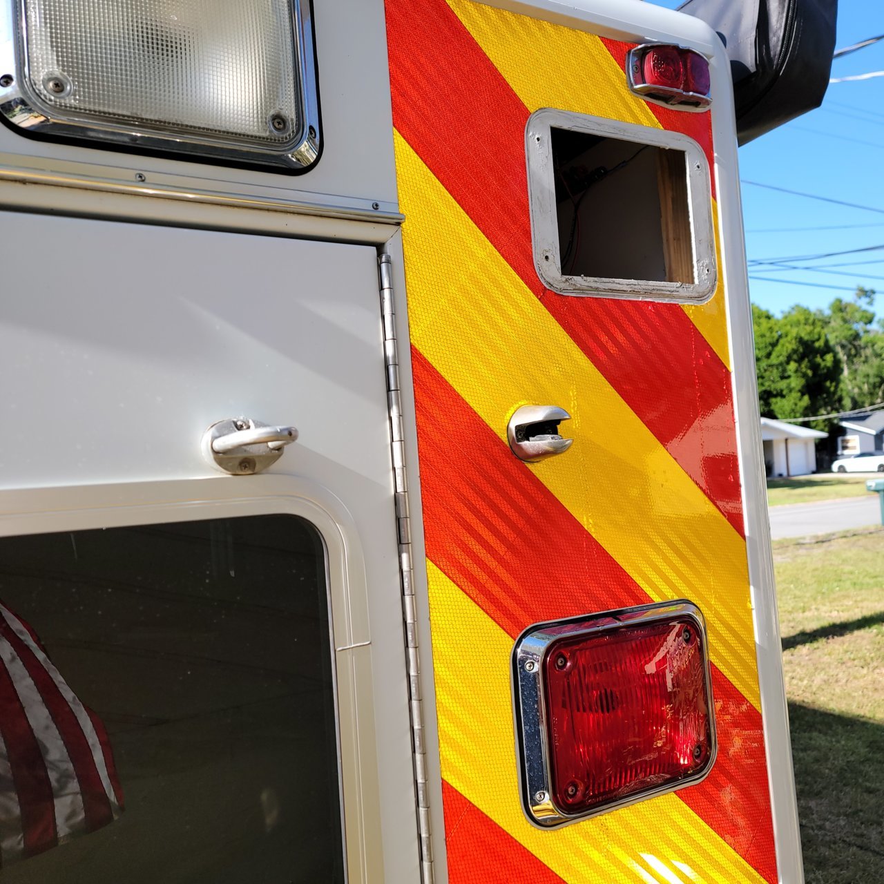

    4/17/23 Update:

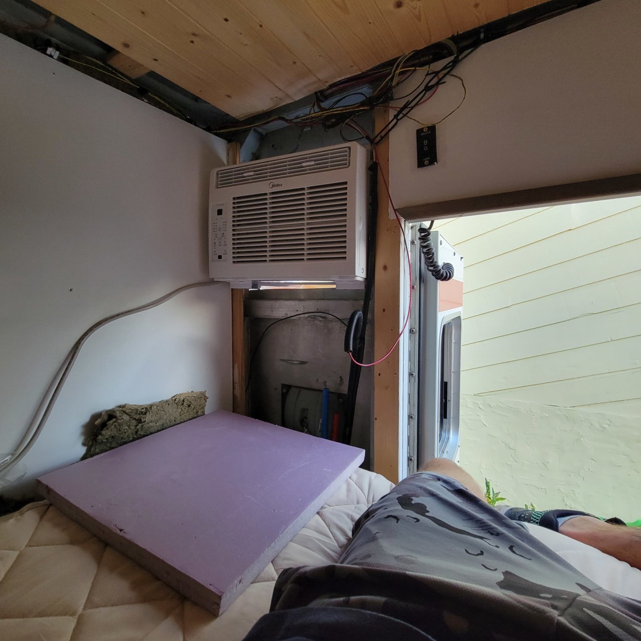

    Bought a little window unit air conditioner over the weekend to try and find a place it could fit before buying a roof unit. I wanted to go this route because it's a lot cheaper and the window unit is only 537 watts, which means the solar should be able to handle it for the most part which would be awesome. (Daytime, sunny)
    Removed an unused strobe and housing.
    Measure once and send it.
    Too late to change my mind now lol.
    Fits like a glove.
    Hopefully will wrap this up tomorrow and get power ran to it by the end of the week and get everything put back together.
