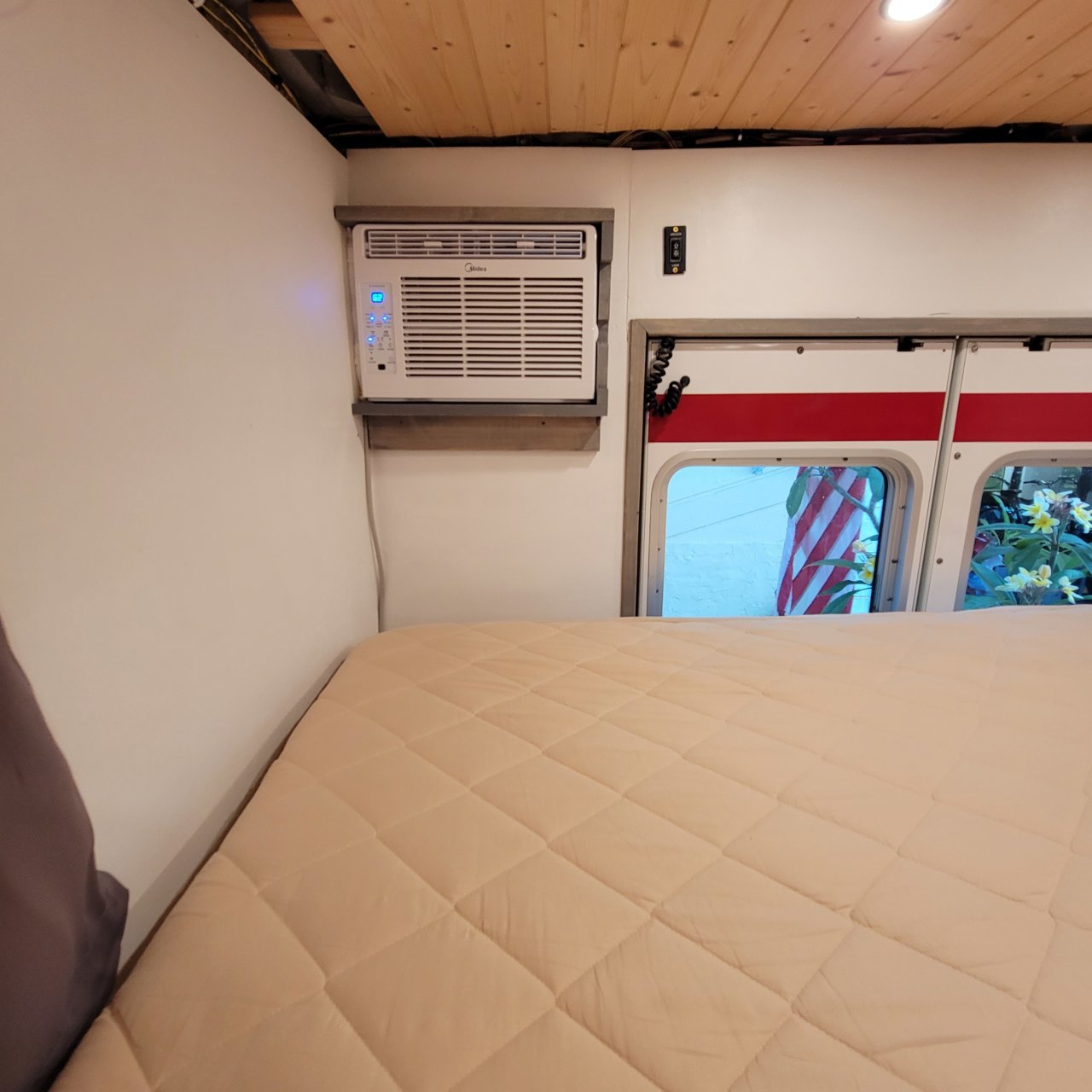

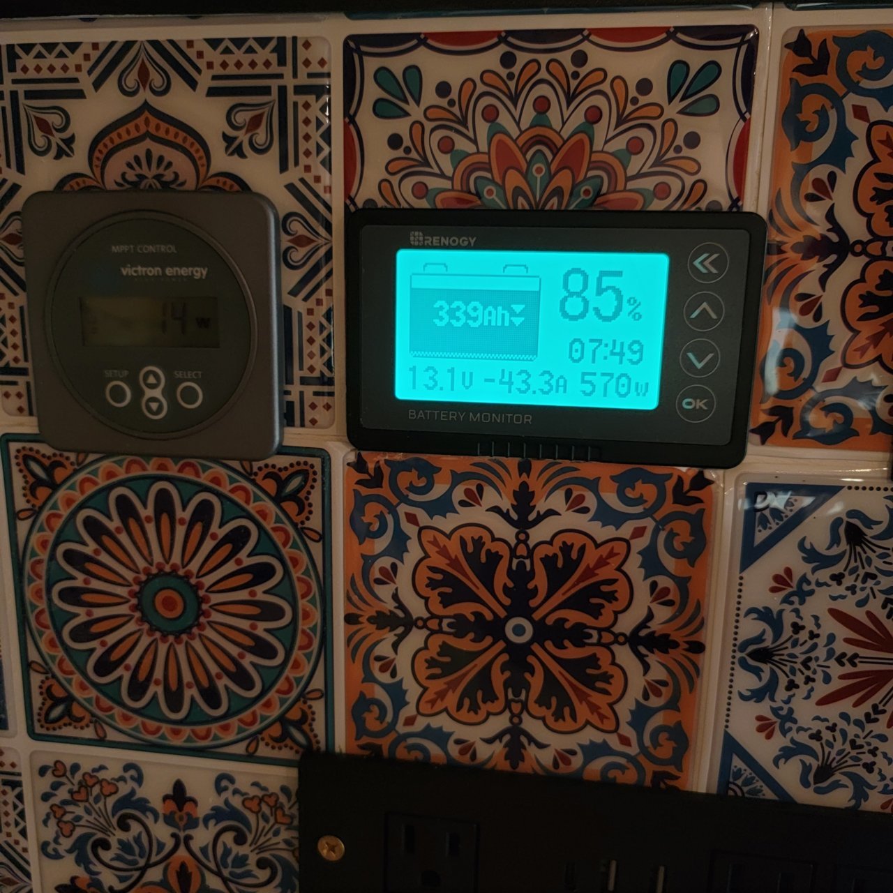

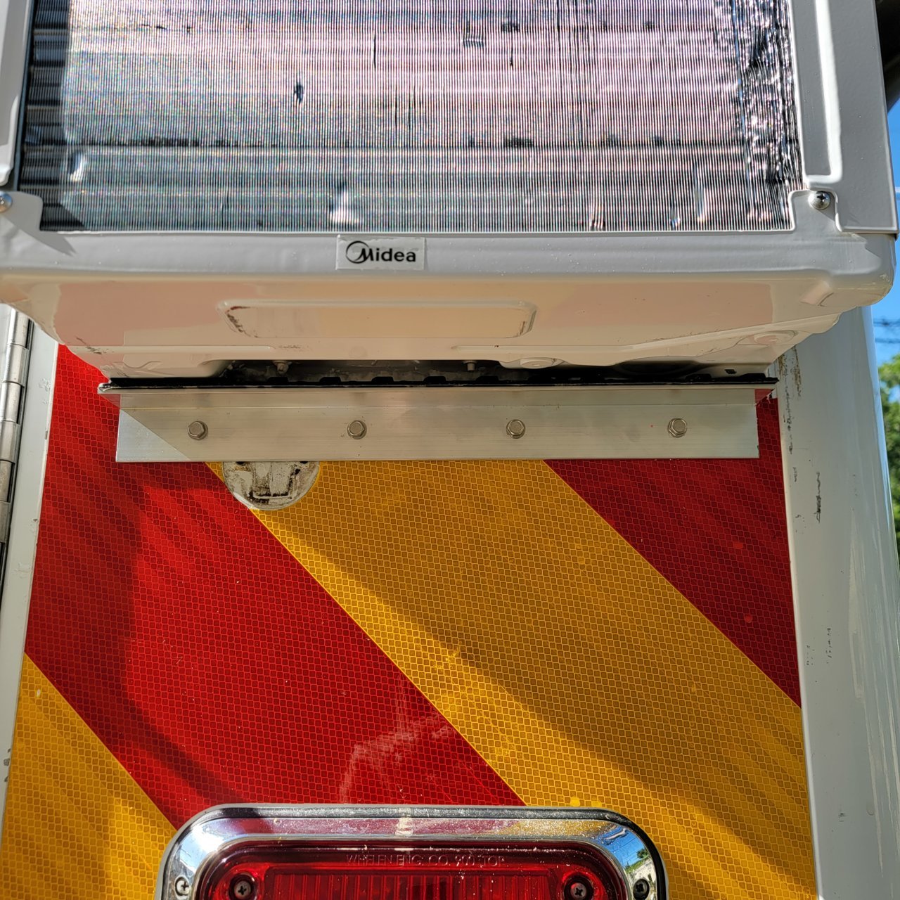

    4/22/23 Update:
    Got everything buttoned up with the ac.
    Only uses about 530 watts with the compressor on.

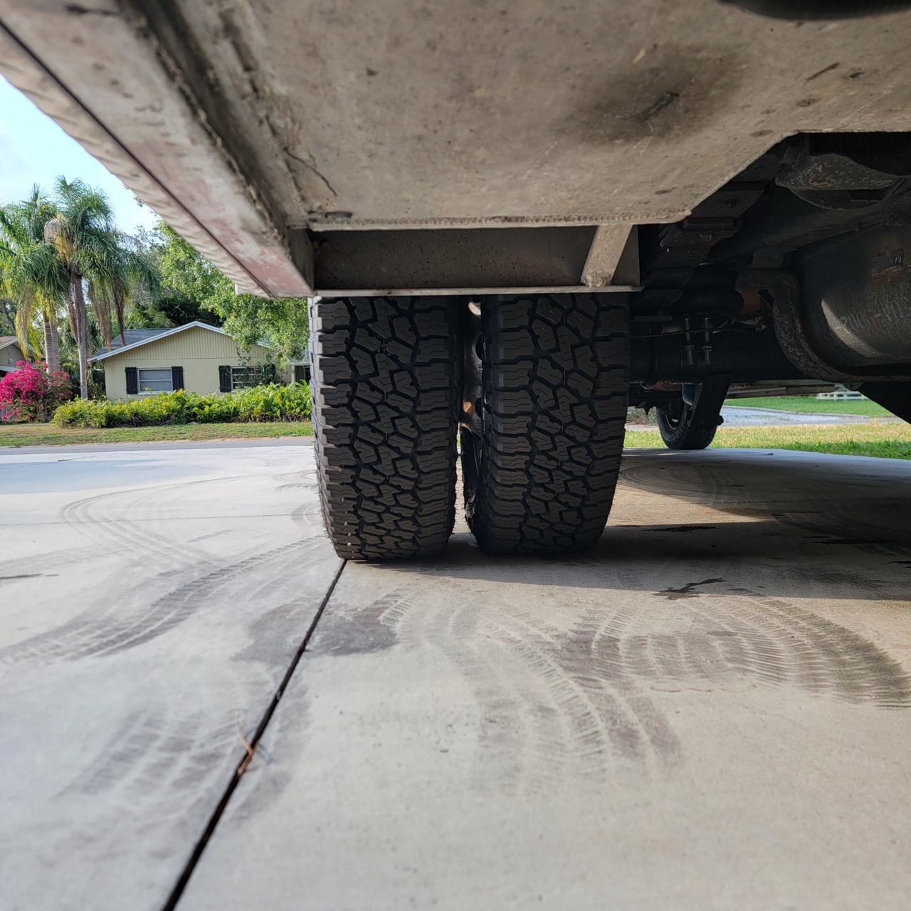

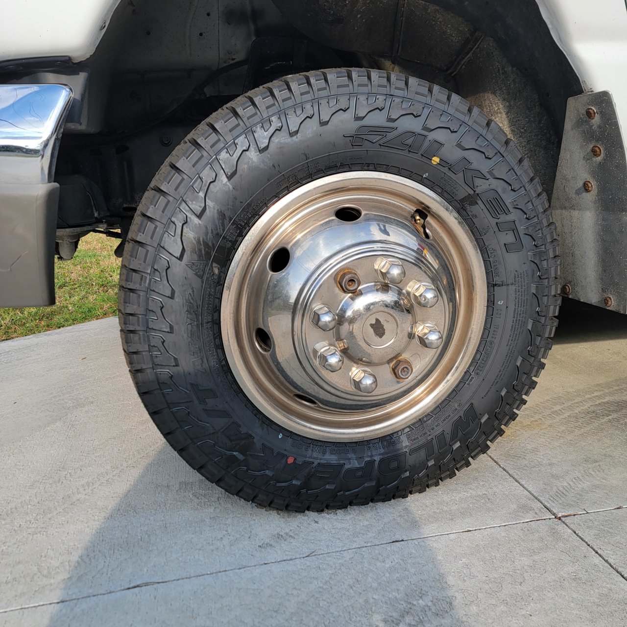

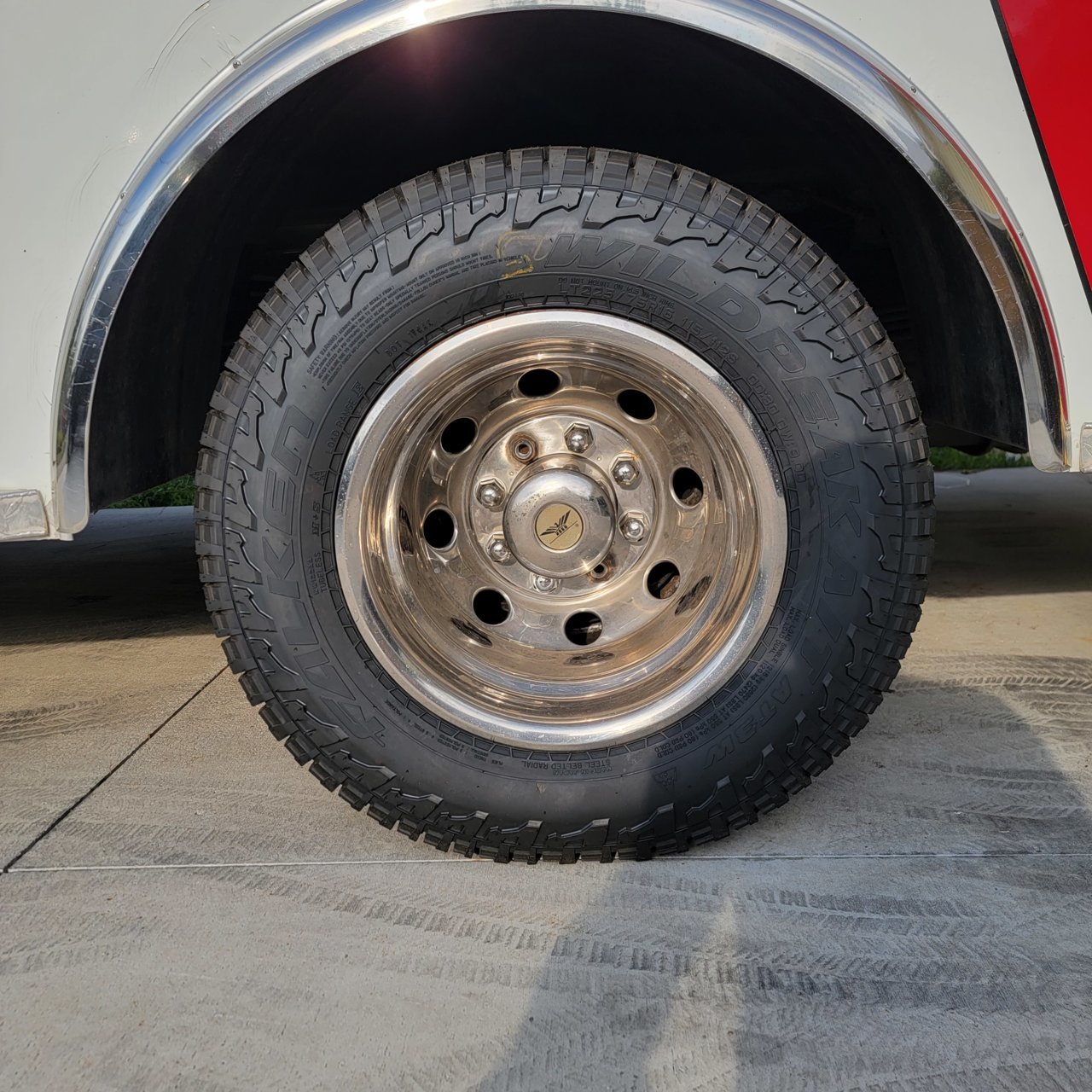

    5/16 update:
    Got some new tires installed last weekend.
    Also got an oil change and fresh fuel filter.

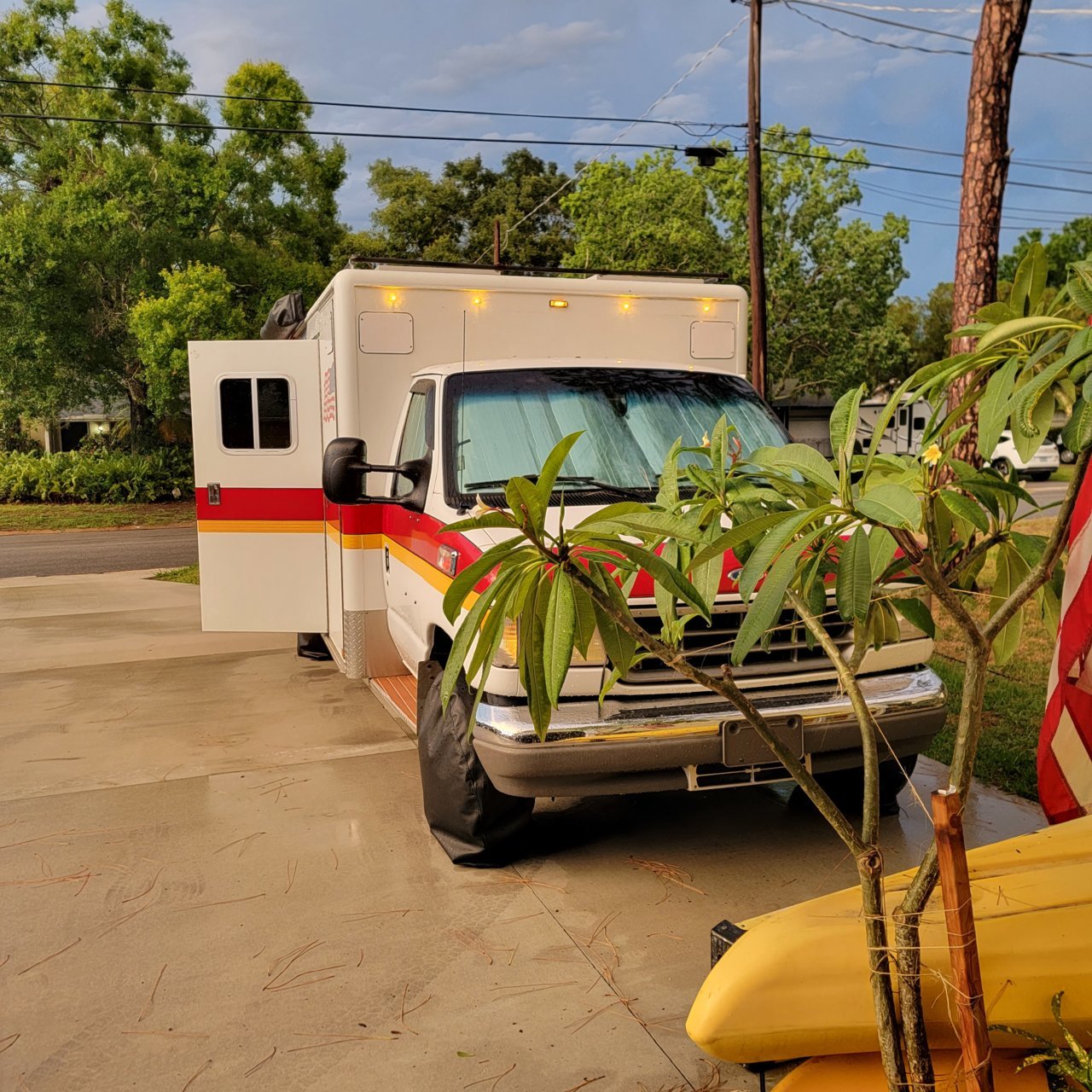

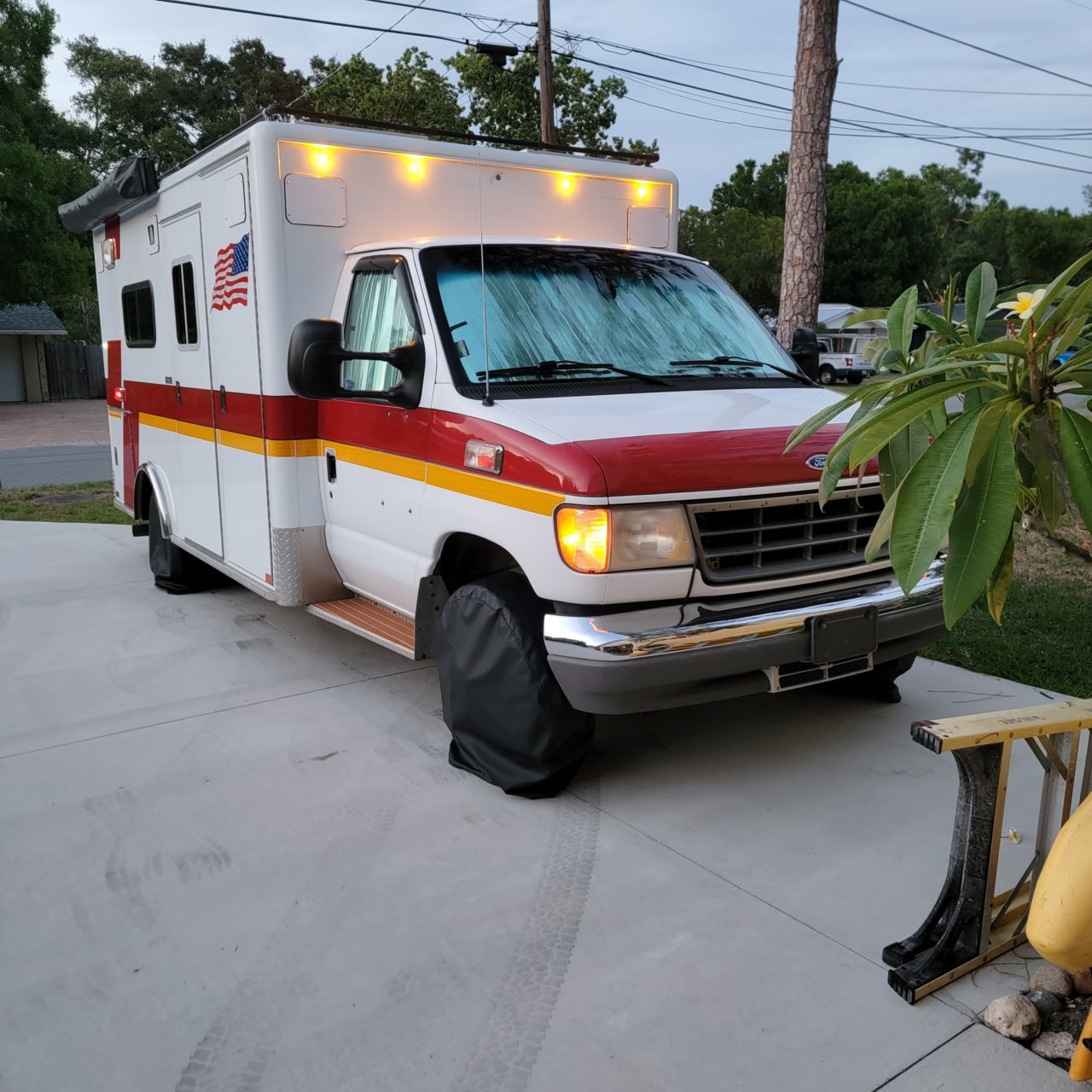

    5/21/23 Update:
    Added some window vent covers on the cab and wired in some new marker lights. I utilized the existing holes from the light bar. Have a triple led for the center that should be in tomorrow.
    Also got some new tires covers. Makes me want black rims lol.

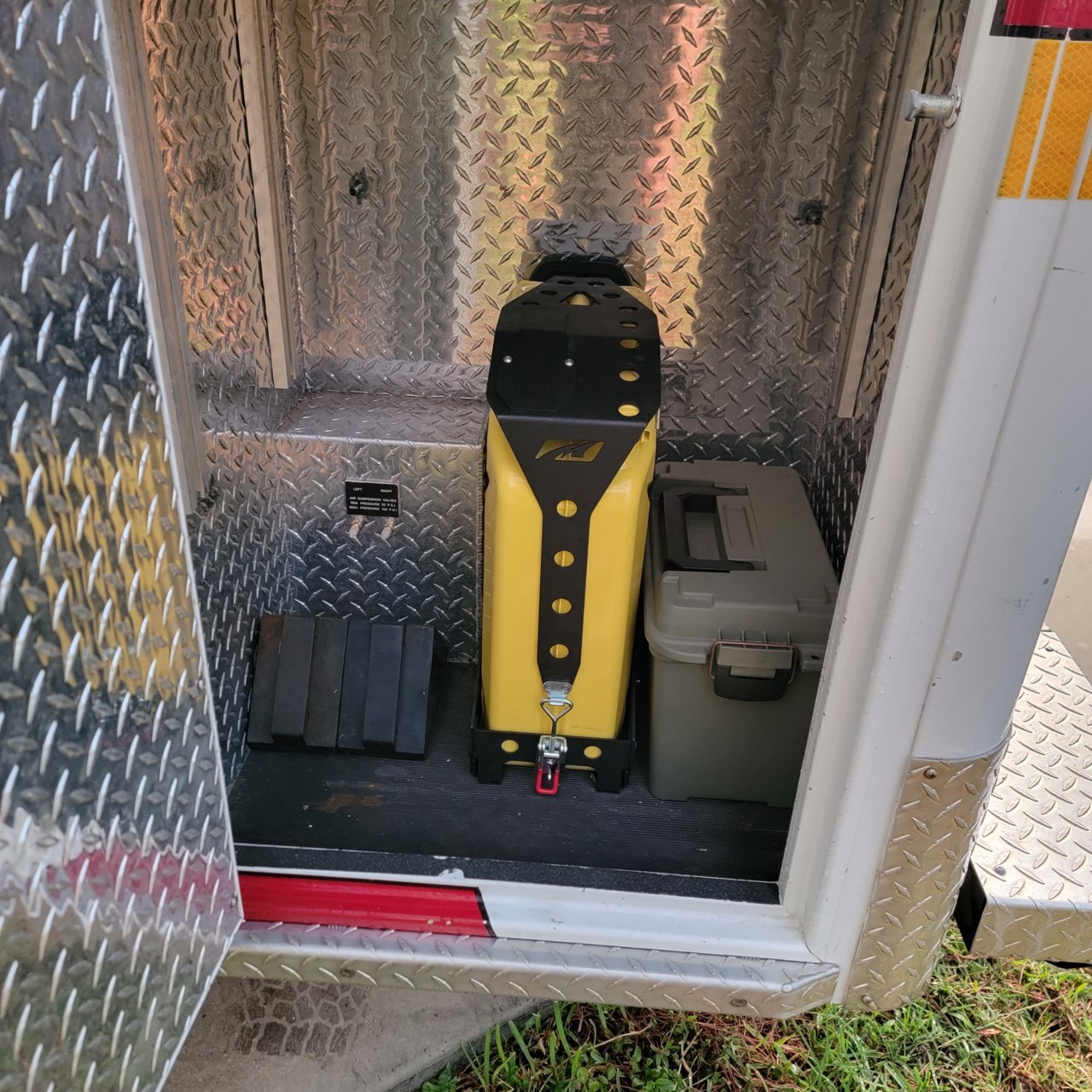

    5/25/23 Update:
    Added a 5 gallon jerry can for spare fuel. It is secured by a motobilt cage.
    Also got my center clearance lights installed.

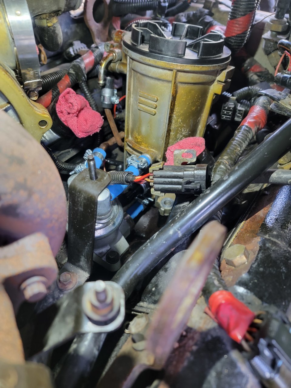

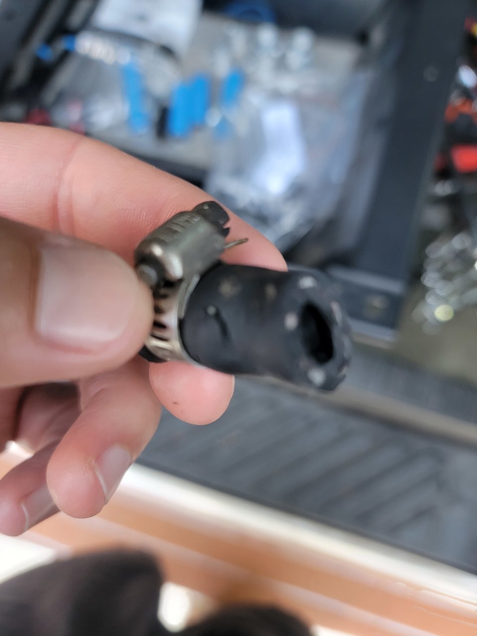

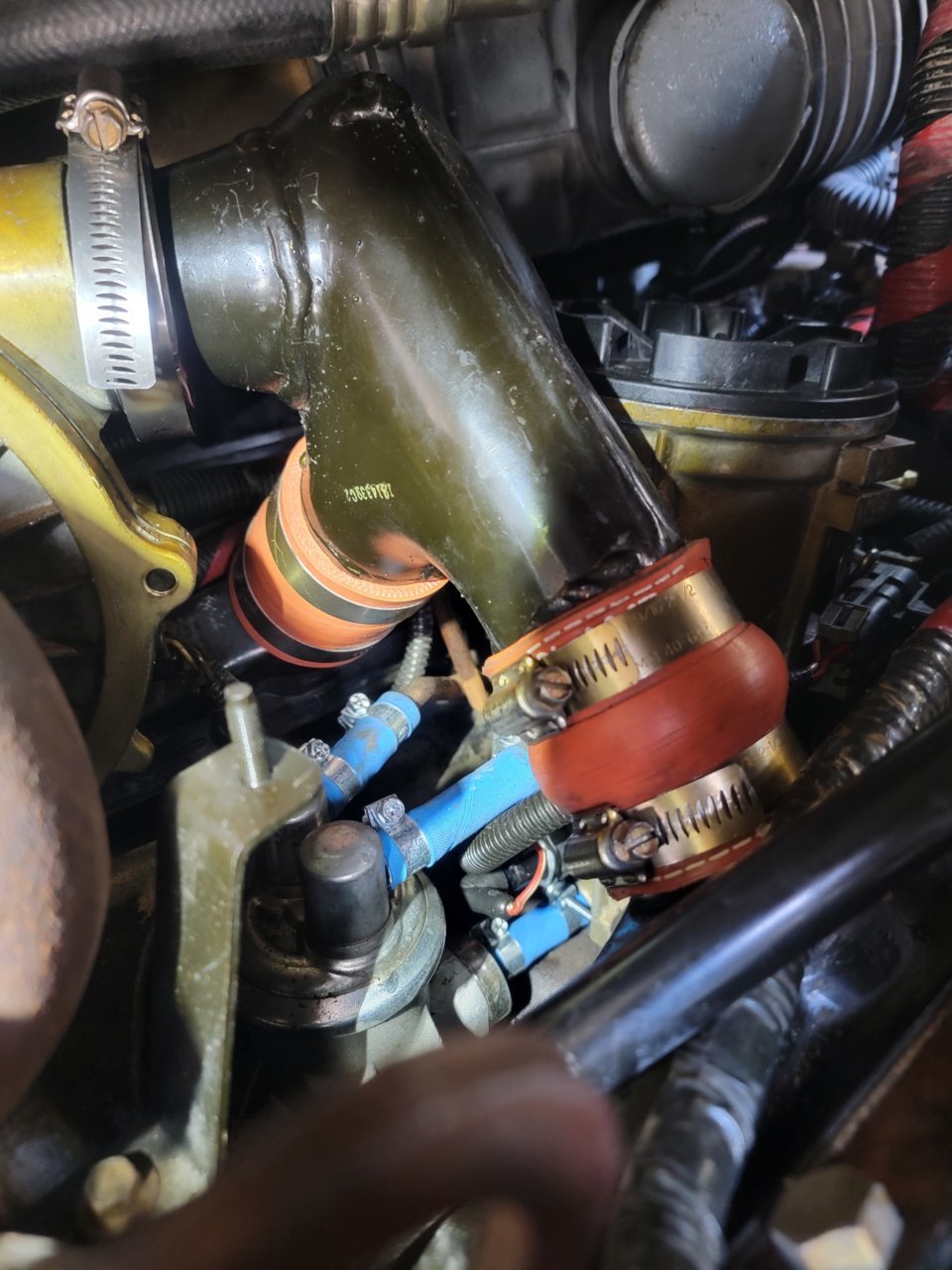

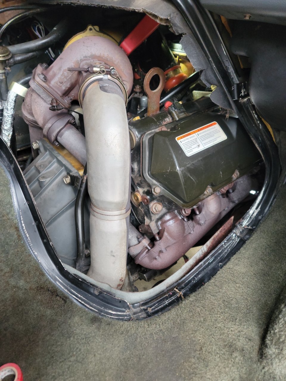

    8/17/23 Update:
    Have been busy trying to clean up the rig after our trip.
    Catching up on some maintenance.
    I have been trying to chase down an oil leak (or so I thought) which turned out to be a fuel leak. Well I finally found it! Had to take everything apart and watch it run lol.
    Time to order some more parts!
    Also plan on pulling the carpet in the cab finally, and soundproofing the cab as well as putting in new carpet.
  16. Aug 17, 2023 at 4:25 PM
    #76
    Steves104x4
    Steves104x4 Well-Known Member
    Apr 17, 2010
    #35468
    17,154
    Steve
    Buffalo NY
    2010 RC 2.7 4x4
    BUCKLE UP! It makes it harder for Aliens to pull you out of your Truck.
    A thing of beauty. Well done!
  17. Sep 7, 2023 at 2:34 PM
    #77
    Tanselow
    Tanselow [OP] Well-Known Member
    Dec 2, 2013
    #117781
    276
    22 trd or

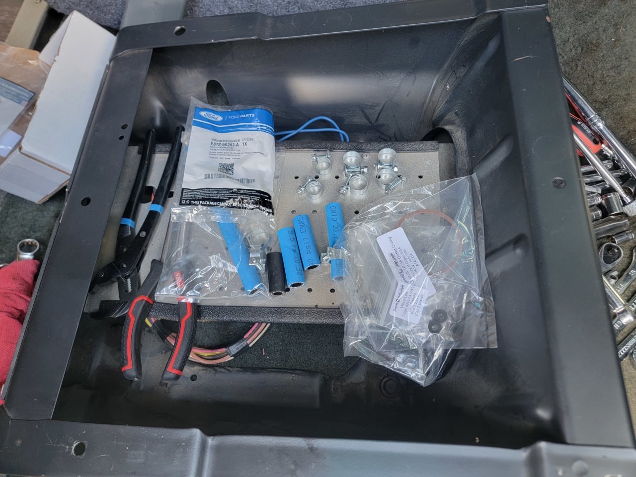

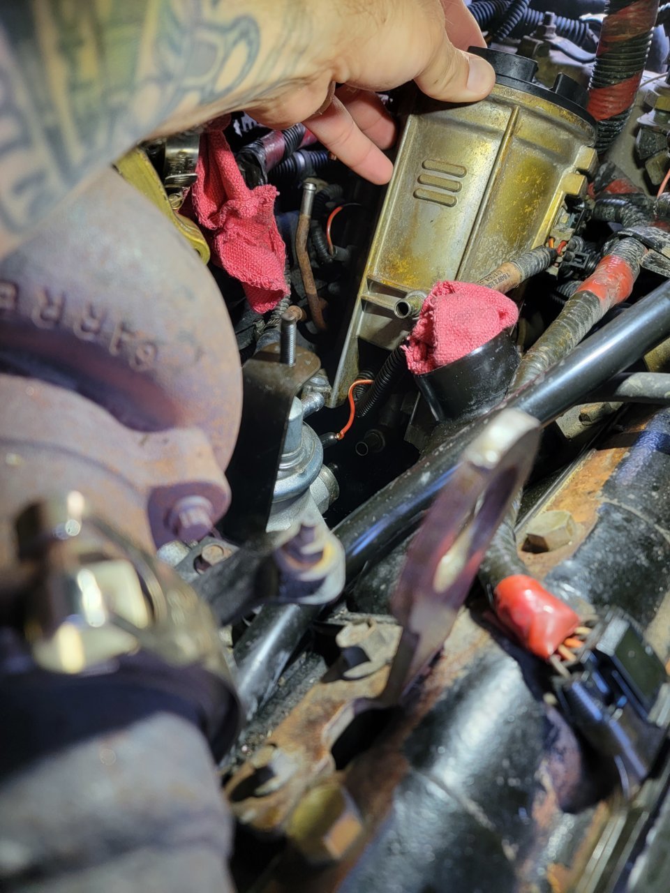

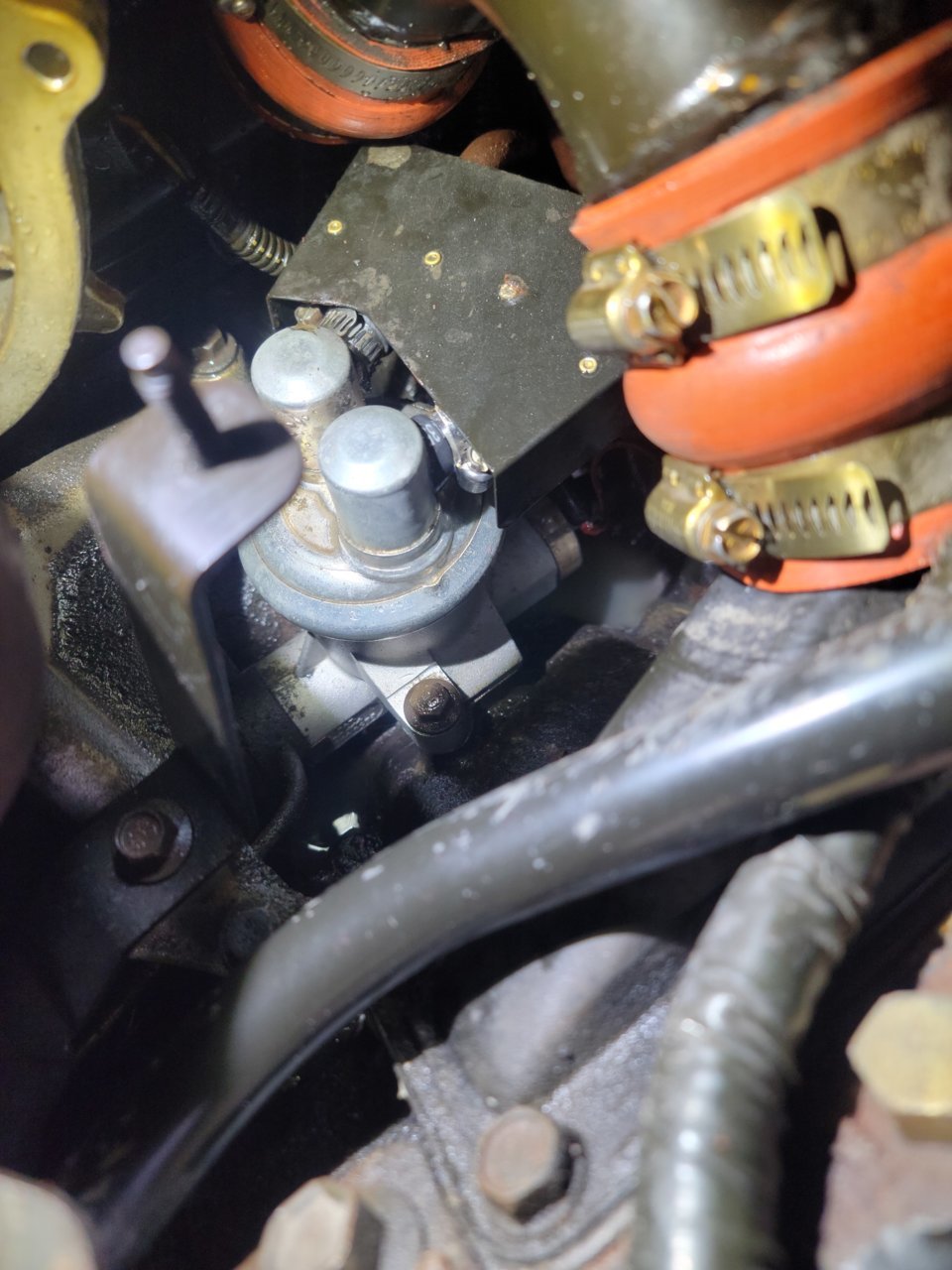

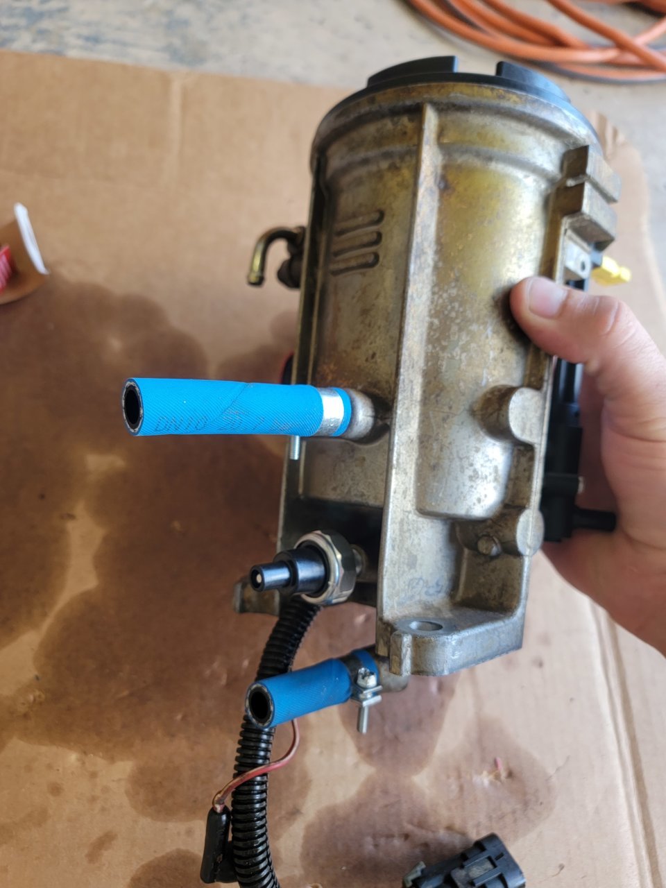

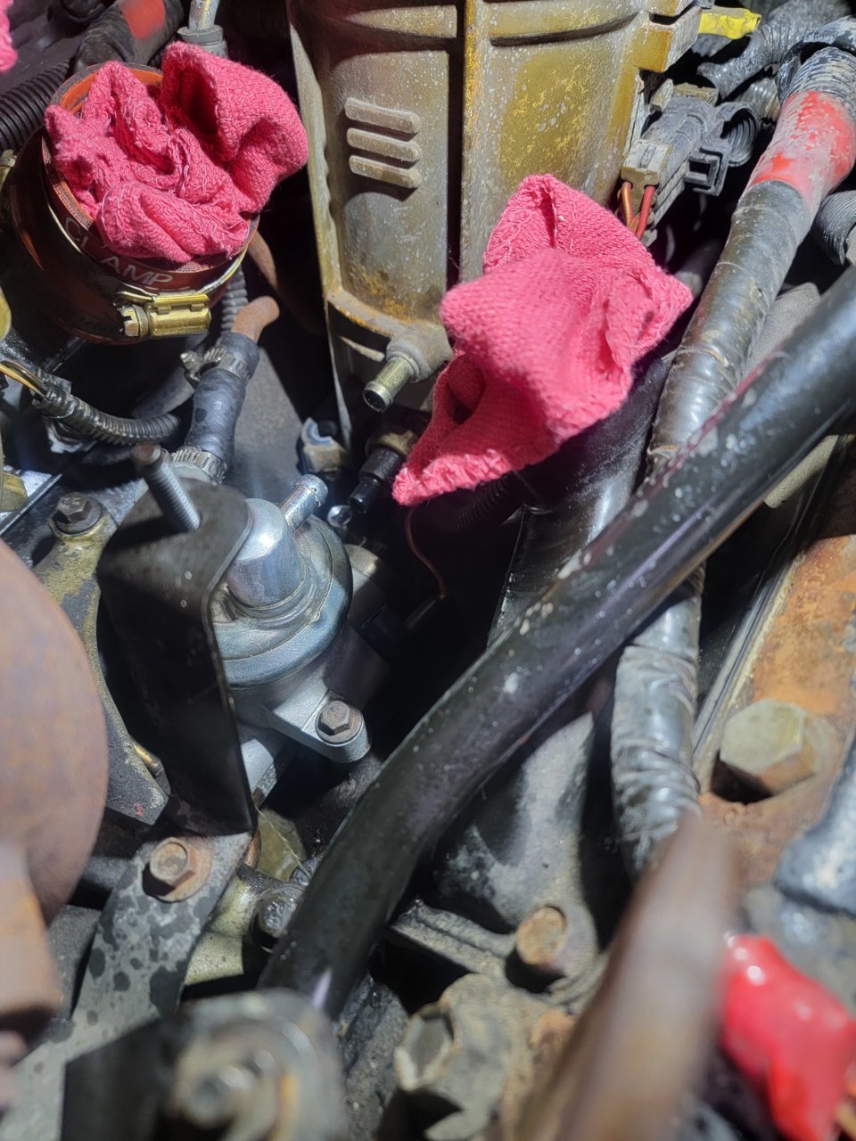

    9/7/2023 Update:
    Finally got the leaky hose pulled, but it's too tight to get the new hoses on.
    Decided to pull the fuel bowl out to make my life easier.
    Not the easiest spot to work on in this thing that's for sure!
    Got all the new hoses put on as well as the fuel filter sensor and fuel/water drain valve.
    Have all new O rings for the fuel bowl and a few other goodies coming in this weekend so hopefully I can wrap this up and move on to ripping out the interior.

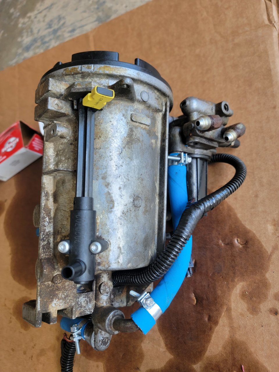

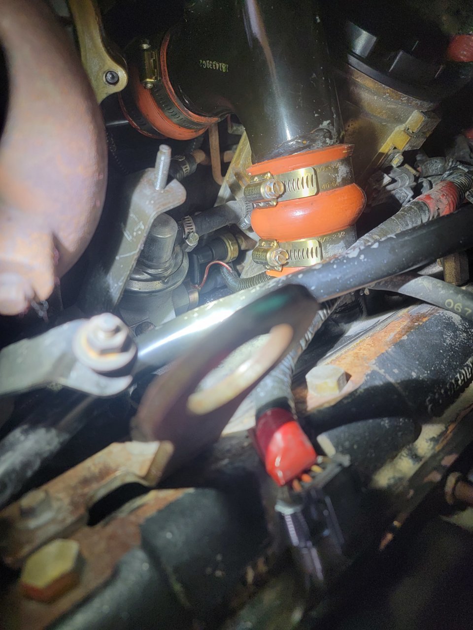

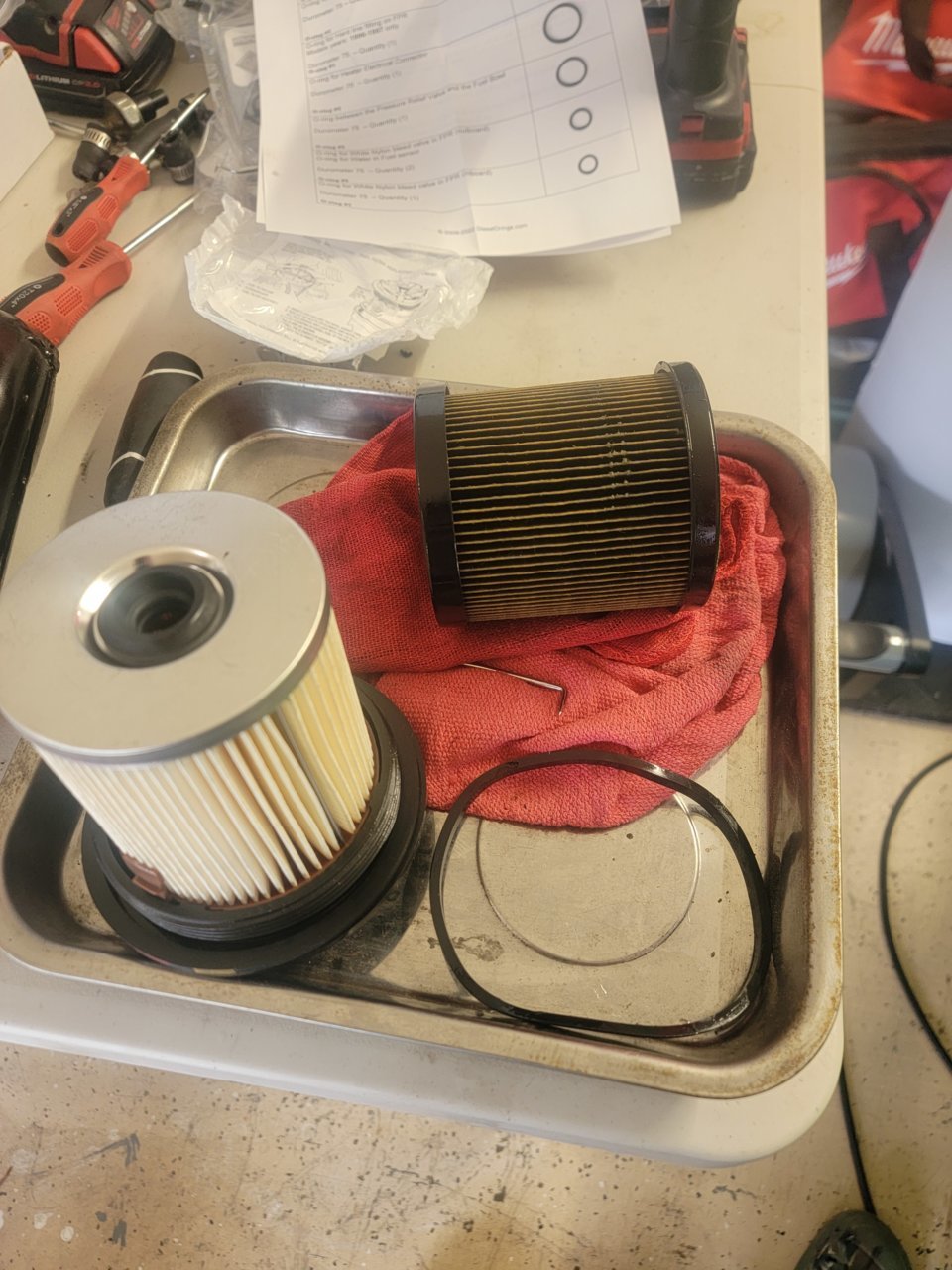

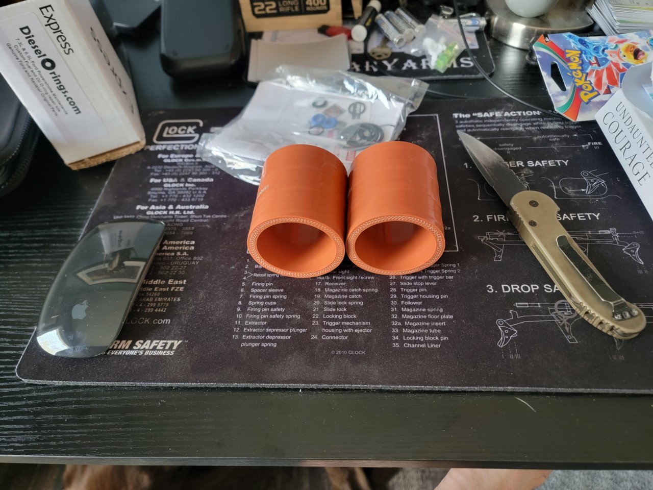

    09/12/2023 Update:
    Changed out the fuel filter, maybe 10k miles on the used one.
    Also got some new intake boots and an Oring kit for the fuel bowl.
    Got everything swapped on the fuel bowl and cleaned real good. Had to slide everything in as one assembly and line up all the hoses at the same time. Quite a mf'er.
    All the YouTube videos I've found for this job were for the truck model so it was a little different with workspace but everything else was basically the same.
    Ended up only using one new boot for now. Couldn't get the new one on. But, ol girl started right up and we are ready to move onto our next project!

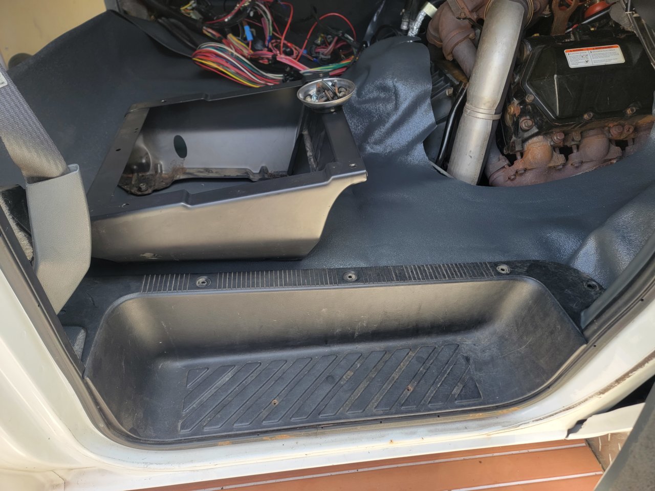

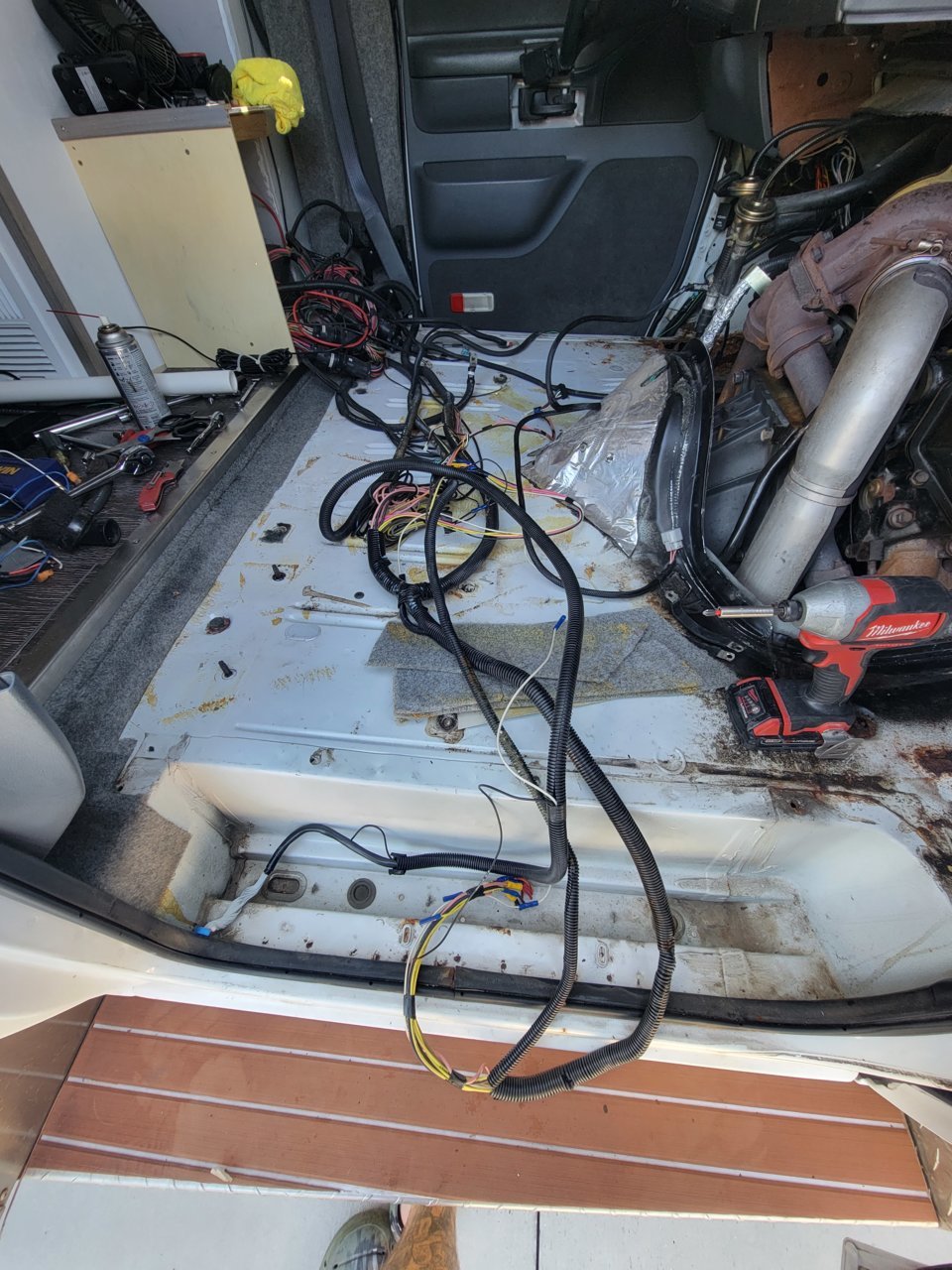

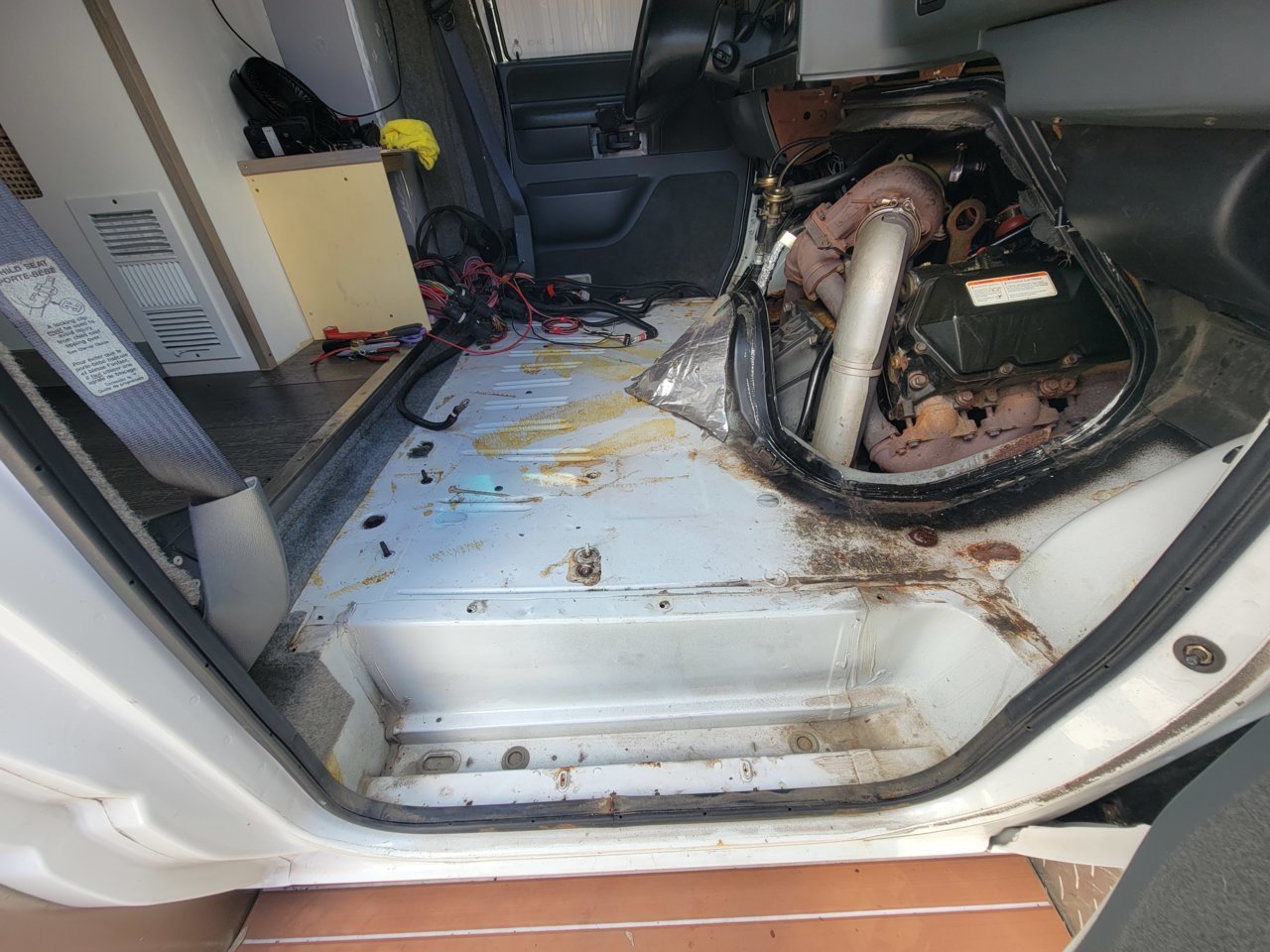

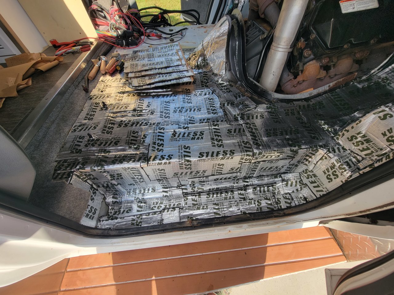

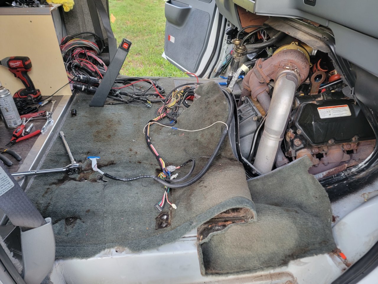

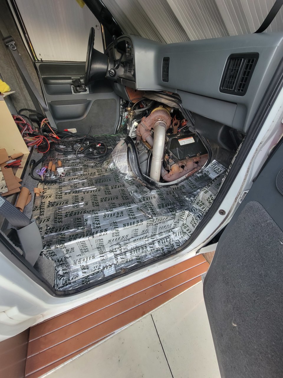

    09/17/2023 Update:
    Finally time to rip out the cab interior. Pulled the seats, bracket and seat belts.
    Lots of wires running under the carpet. Most for the siren and ambulance controller, both of which are being deleted.
    Went through and removed the no longer meed wire runs. Most wires are labeled so its a pretty straightforward process.
    Hit everything with the shop vac and wiped it all down. Put down this sound deadener everywhere I could reach.
    This is the 80mil thickness. One box was 36 Sq ft and 30 sheets. Just enough to do everything I had exposed and had one sheet leftover.
    Next up is the new vinyl flooring. Still have to run a few wires to where the center console will be before I get the drivers side put down.
    Have some more wiring to clean up then I can finish putting down the flooring and get the interior put back together.
