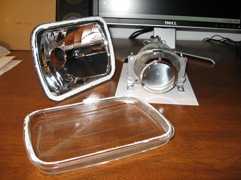

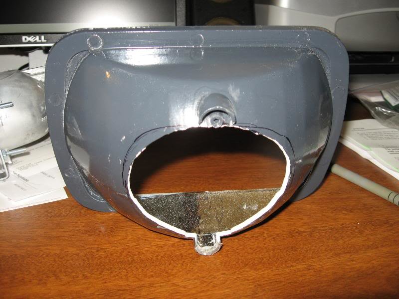

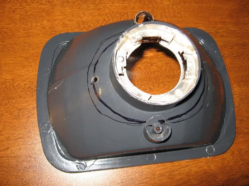

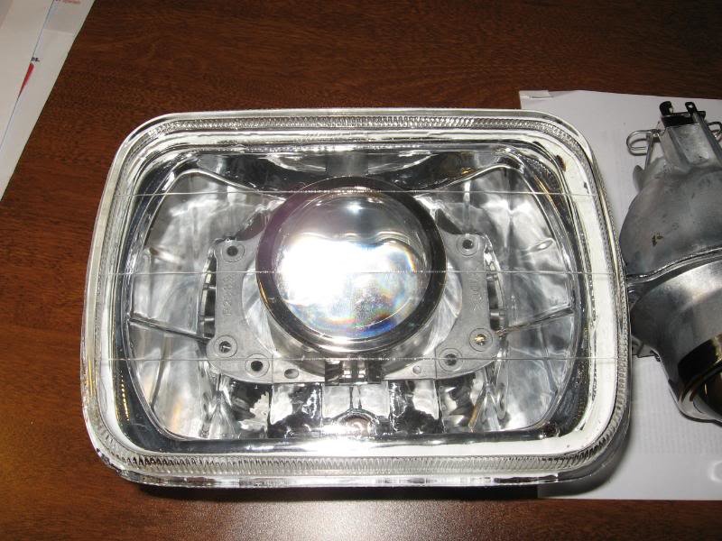

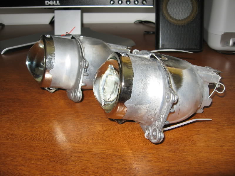

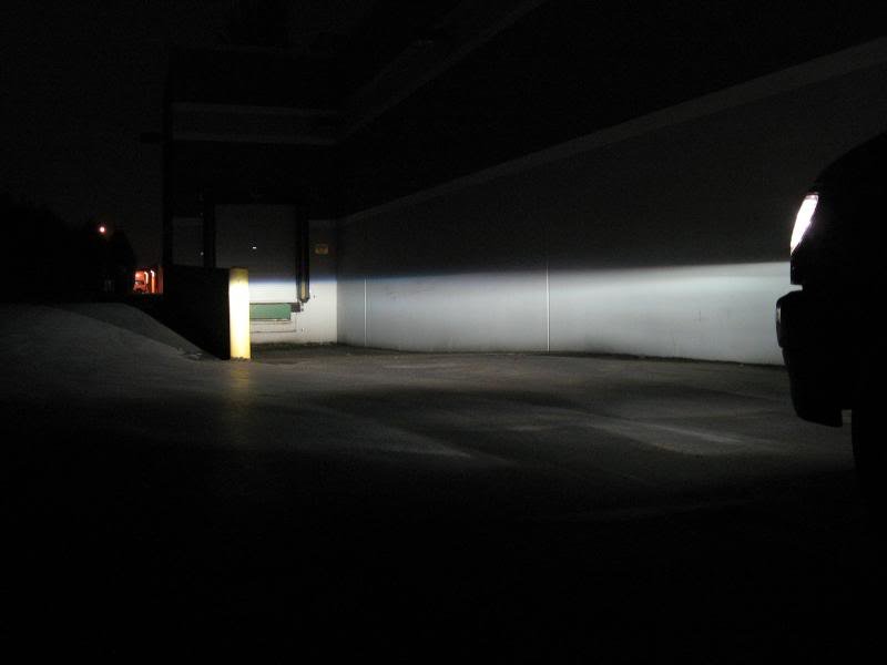

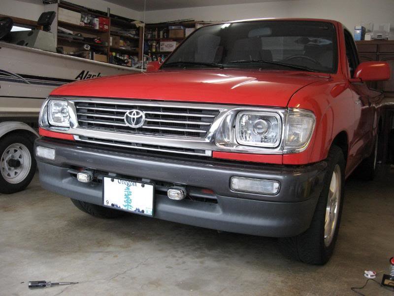

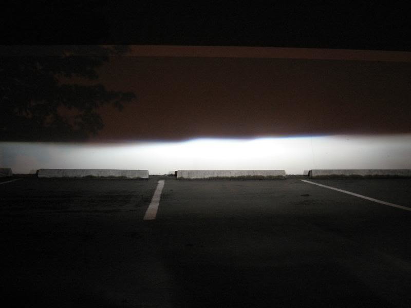

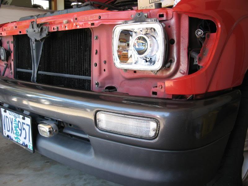

    Hey, I had a 96 and did a retrofit. The pictures speak for themselves.

    Sorry man. When I bought the new Tacoma, I took my retrofit apart and sold some parts. I kept the d2s bulbs, harness, and ballast. I plan to use them to do an FX-R retro on the new Taco. :D

    People who throw HID bulbs into halogen housings make me shake my head. They produce an INSANE amount of glare to oncoming drivers. It is a major safety concern when you blind an oncoming driver. Do the bloody research and spend the necessary dollars to do a proper retrofit like ppham444. A projector is the ONLY way to do a proper HID conversion.
