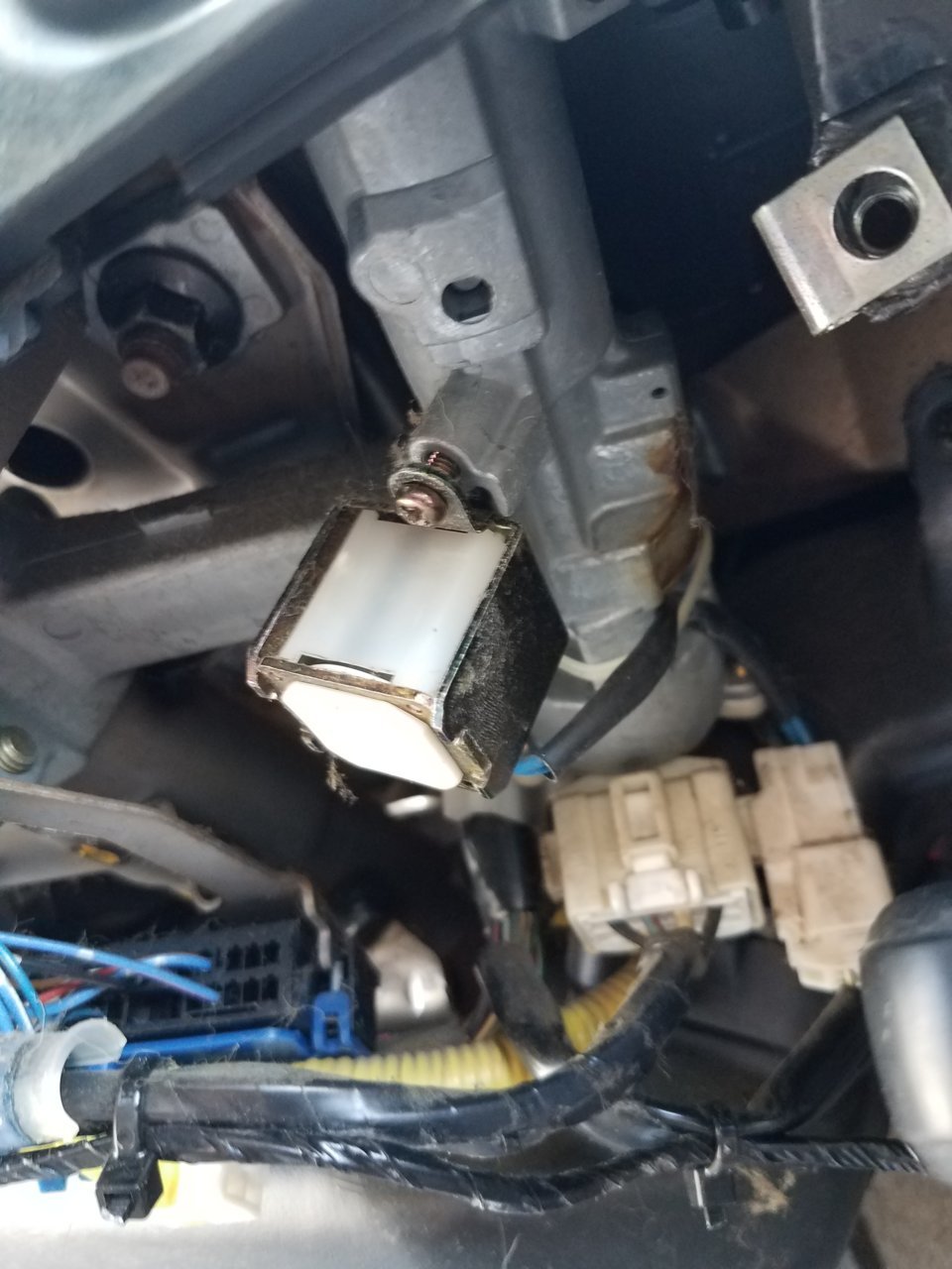

    20200507_161013.jpg 20200507_161013.jpg I just had this happen today. Fortunately it was at home in my driveway. I pulled the lower cover under the steering wheel to gain access to the ignition switch. Then I took a guess that the thing in the picture had to do with locking the key from turning to the lock position. All I had to do is loosen the two screws holding it to the switch cylinder and now the key functions normally. I suppose I no longer have the safety feature preventing the key turning to lock and being removed while I'm driving, but I'll take that chance.
    It's the white square thing, seems to be a solenoid with a plunger that engages the switch, keeping it from turning all the way off. It could have been a real inconvenience if it happened somewhere else.

    automotive locksmith: Our ignitions and doors use split wafers at two positions to offer added security. As these split wafers and the plug as well as your key wears, the wafers fail to align and block the sheer-line. If your key is turning smoothly both clockwise and counter, the wafer (lock cylinder) is not the problem.
    As you have found, the park solenoid is bad ad will prevent the key from being removed. Another solution to removing the key with issue or problem solving is to temporarily disable the solenoid by disconnecting the battery, then removing key as solenoid is de powered.
    Lots of customers come into my shop thinking they have ignition cylinder issues due to park solenoid issues on auto trans vehicles.
