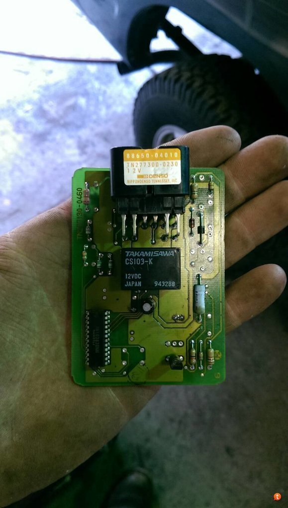

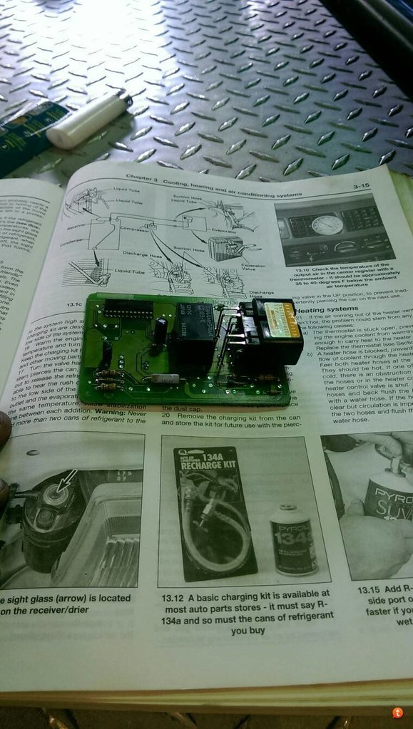

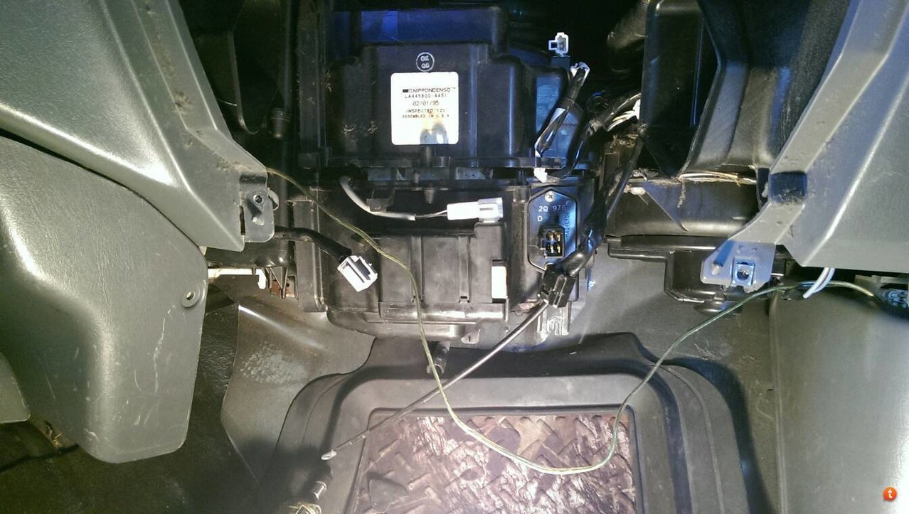

    Ok folks... At a stand still and need help. Tore into the dash this afternoon and dropped the evaporator after draining the system. The coils were slammed pack with debry! Cleaned the best I could, replaced the pressure switch and buttoned her back up. Clutch still sporadically engaging on and off with no consistency, regardless of temp or pressure. Started checking wires and harness... Finally pinpointed the problem!
    The AC amplifier pack has a computer board in it. Pulled the board and tested connections between posts and all were good expect the relay! Put a test light on it and cranked it up, you could see the inconsistency in the signals it was sending.
    So with this being said, I've researched online and the big auction website with no luck yet. So if anyone has a website or link to a 1995 taco AC amplifier or has a parts truck they want to just pull the board out I'd MUCH appreciate it! I found one online that sold awhile back for $40-$50, I''ll be happy to pay for it. It's VERY easy to remove with out taking anything apart, you just look under the glove box. I have a part number if needed. So anyone think they can help me out? Thanks guys.

    One last update, a Google search of what I'm assuming is the part number (Orange and white sticker) of 88650-0410, comes up ac assembly/cooler stabilizer. They only provide vague parts schematics without actual part photos so not sure if it's what I need? Guess I'll try the dealer worst case. Thanks guys.

    The sensor in the evap with a probe that sticks between the fins is not a pressure sensor. It's a temp sensor. Pressure sensor is in the high side line or in the "h" valve. Been while since I had one this old in front of me.
    Have seen the ac amp give a system fits but I can only sit back and assume the sensors were checked correctly and the pressures were good to activate the system.
    The parts view really stink and that is the correct set of numbers you posted.
