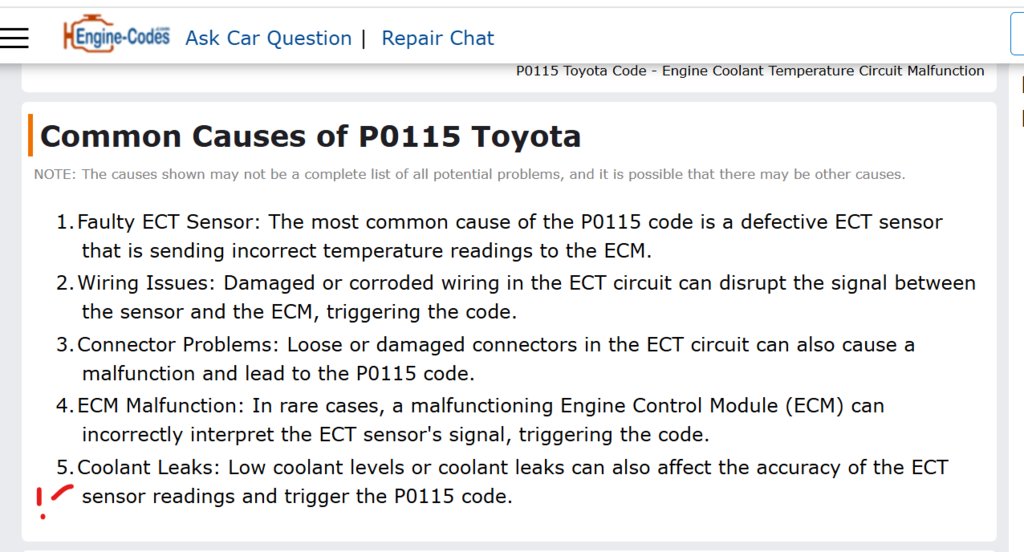

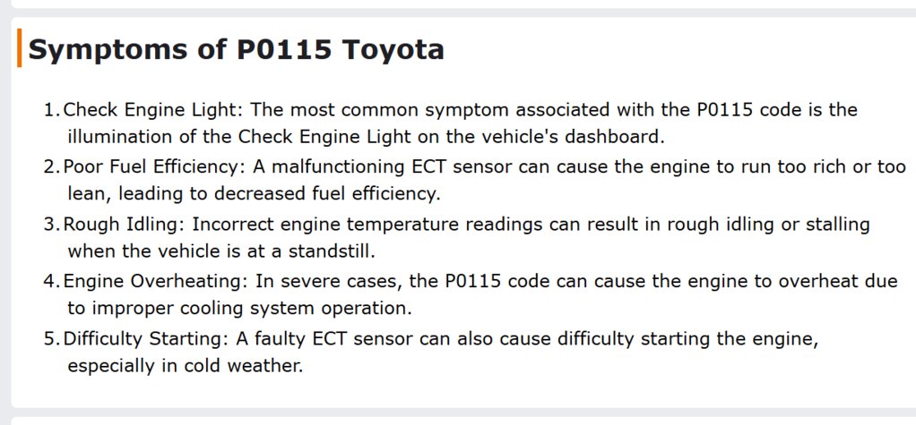

    FYI.....i installed a new cheap $15 CTS.......failed in 3 months
    here are some other causes and symptons
