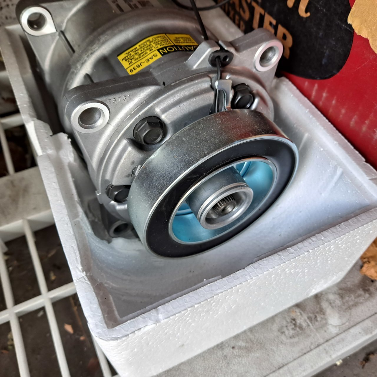

    I'm about to start pulling the old one out but the new one says it has 3 ounces pre loaded and I'm supposed to add more before installing but it doesn't say how much
  19. Jun 29, 2021 at 9:27 PM
    #19
    95Babyota
    95Babyota [OP] Well-Known Member
    Nov 6, 2020
    #345993
    141
    Kenneth
    95 Tacoma reg cab
    the new ac has 3 oz of oil pre loaded and the instructions say to make sure its the right amount so I had one guy say I need to add one oz because its supposed to have 4, another guy said I don't need to add anything and another said to drain the old one and make sure the new one has the same amount.. I drained the old one and there was only about an oz so I just installed the new one as is and started it, turned the ac on, added 47 psi of freon and nothing, the clutch still doesn't turn on.

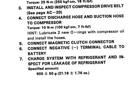

  20. Jun 30, 2021 at 7:00 PM
    #20
    Wsidr1
    Wsidr1 Well-Known Member
    Jul 11, 2018
    #259004
    3,079
    Indiana
    2 x 95.5 Ext 2.7L & 3.4L A/T 4x4
    1995 FSM says add about 3/4 oz of oil:
    Refrigerant amount
    Other info:
