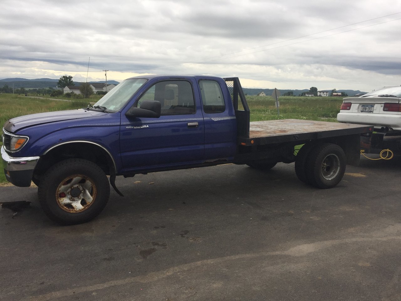

    This is what it looks like as of right now. Not done but useable for what i need it for. More mods to come but ill save that for later.

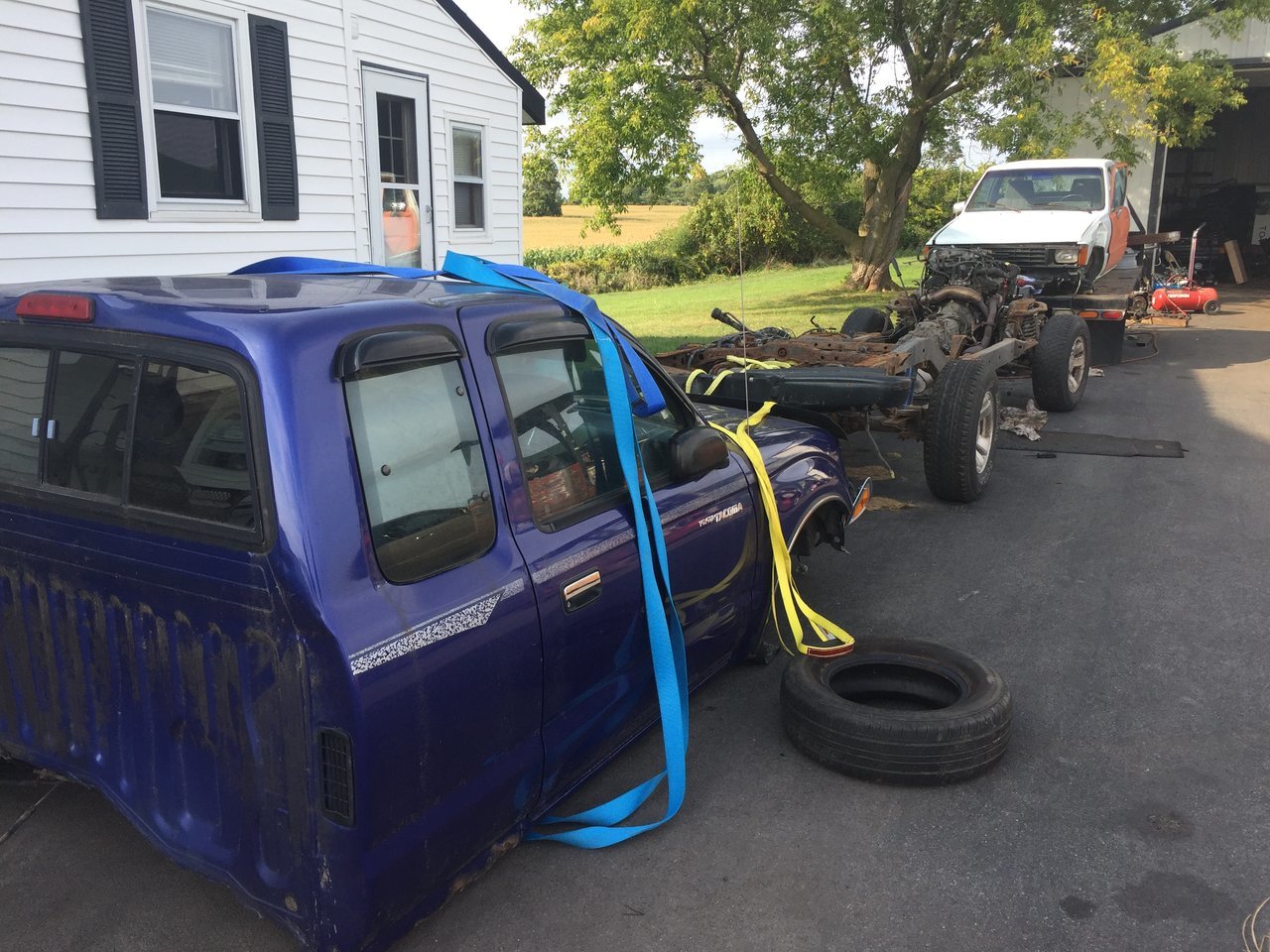

    It started here

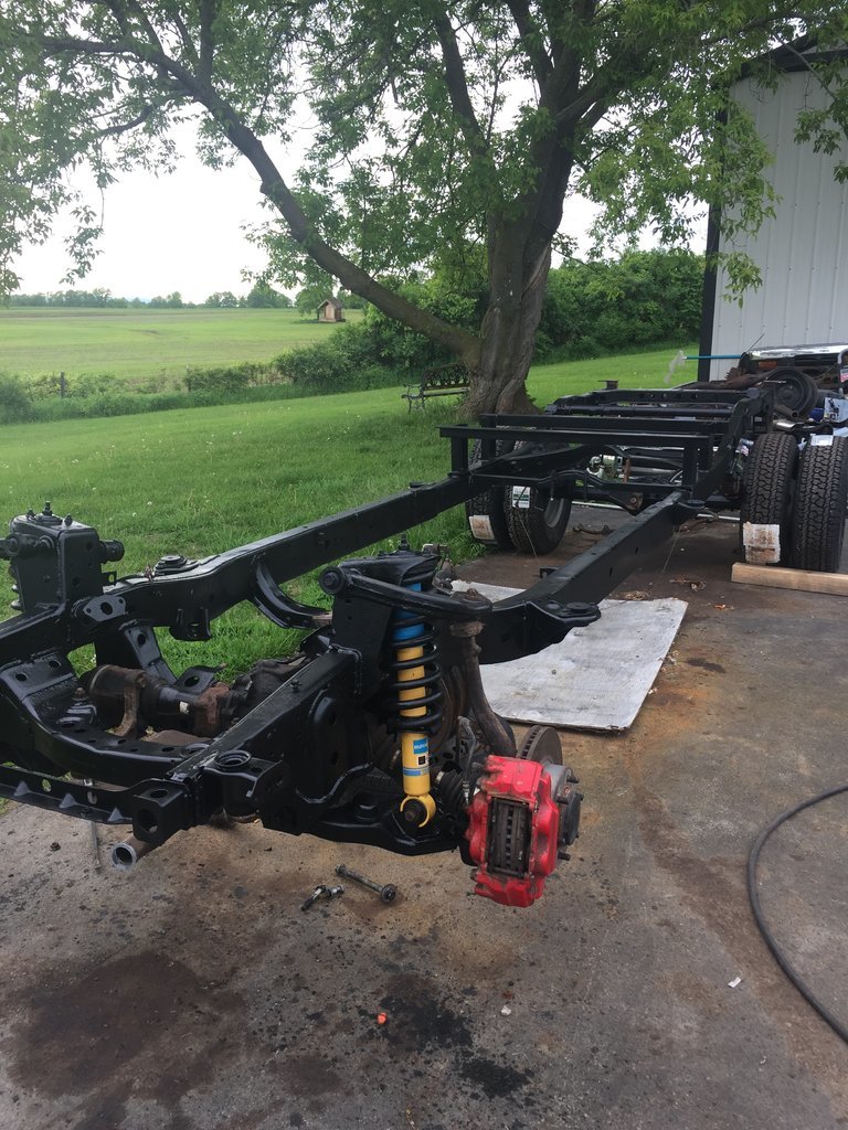

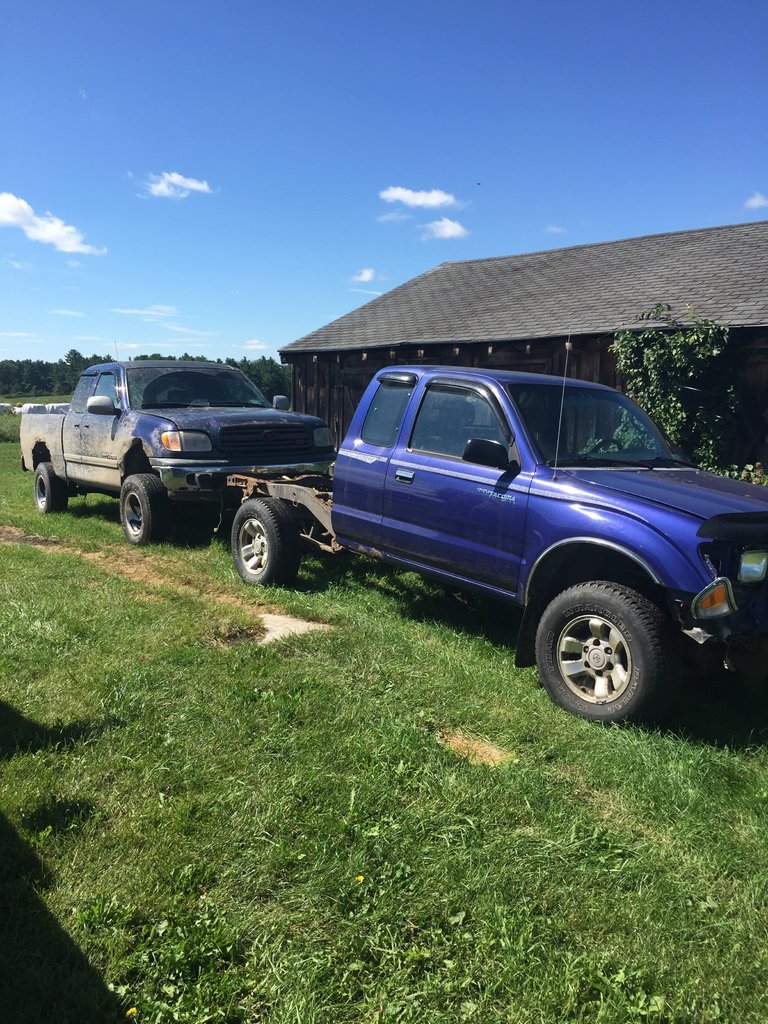

    Picked this dually up on the cheap with no title. Its an old uhaul truck with 30k on it. I was going to cab swap it and solid axle it. But the more i thought about it the more i wanted an extended cab and more creature comforts like rack and pinion steering. Thats when i found this truck also on the cheap

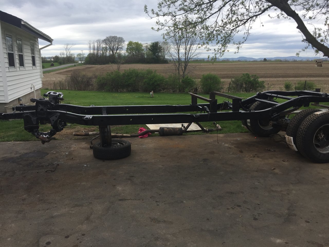

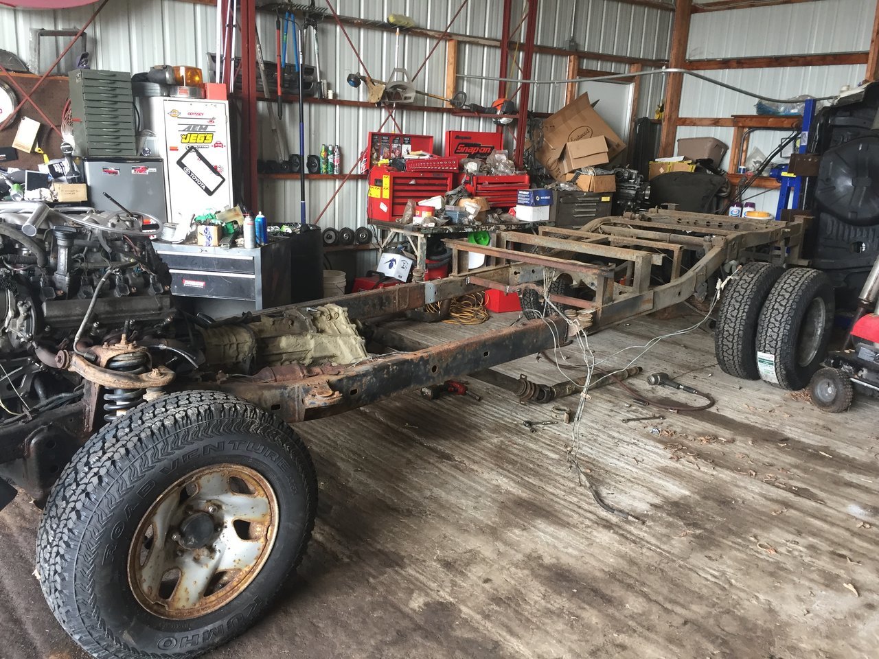

    Back half of the frame soft front half solid. I then had the crazy idea to cut both trucks in half and make one. So i did

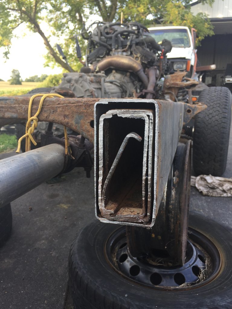

    Oddly enough the one ton frame fit inside the tacoma frame. Here is a small section on dually frame inside tacoma.
    I cut both frames longer than I needed. I ended up with a foot of overlap.

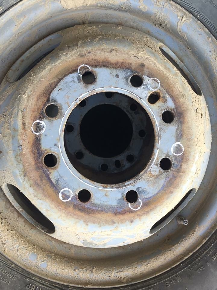

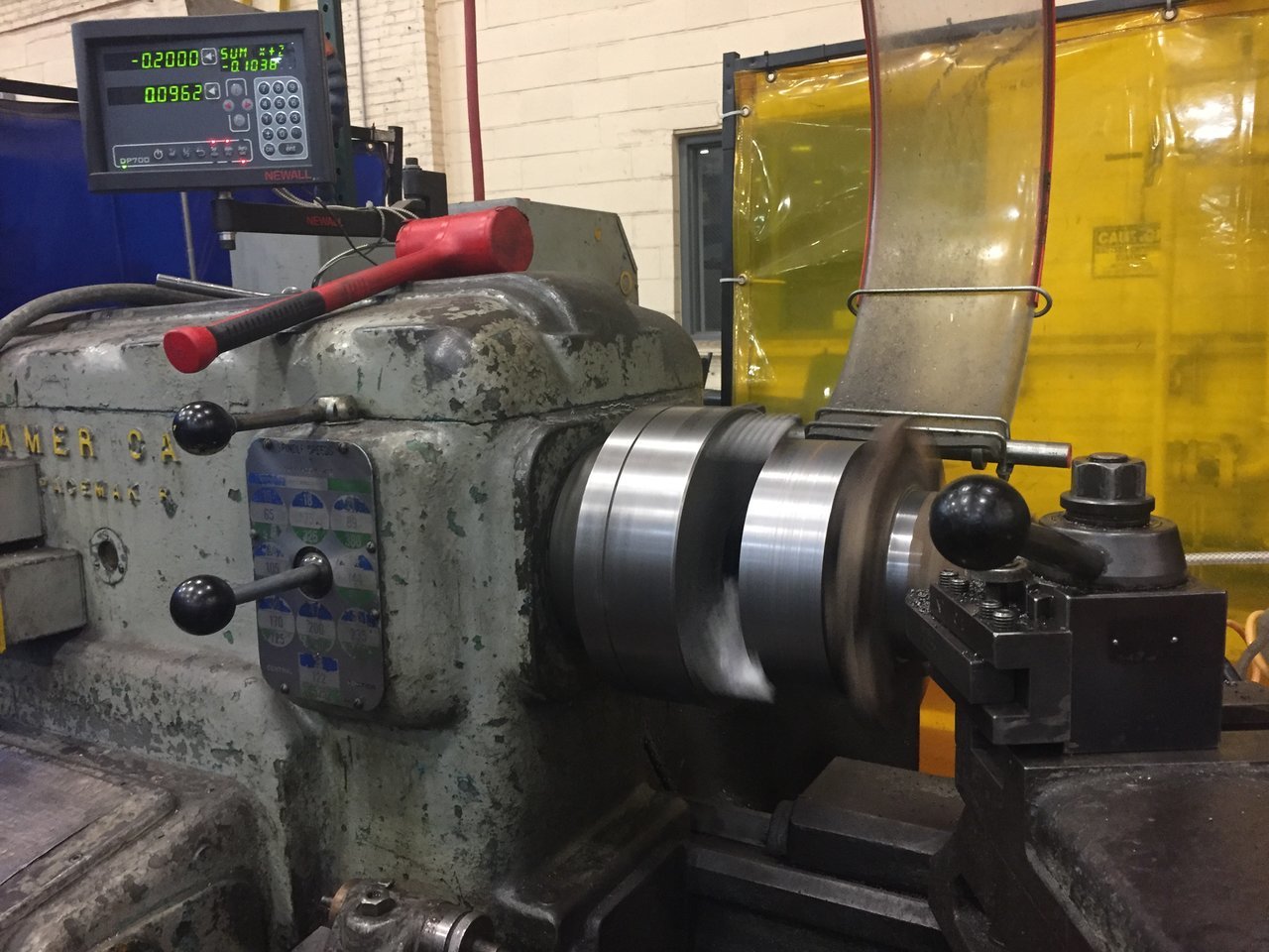

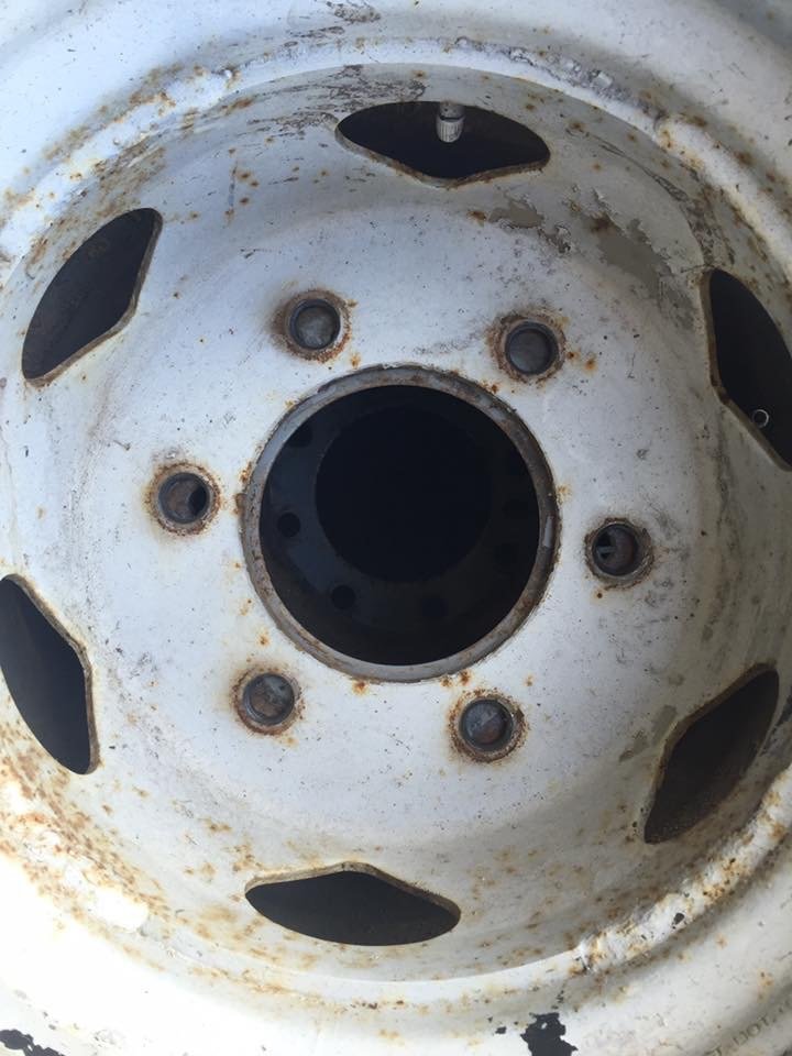

    Also the dually came with 14" wheels. That simply wont do so i found a set of dodge wheels on craigs. Turned my hubs down at work and redrilled the wheels.

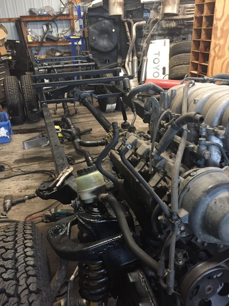

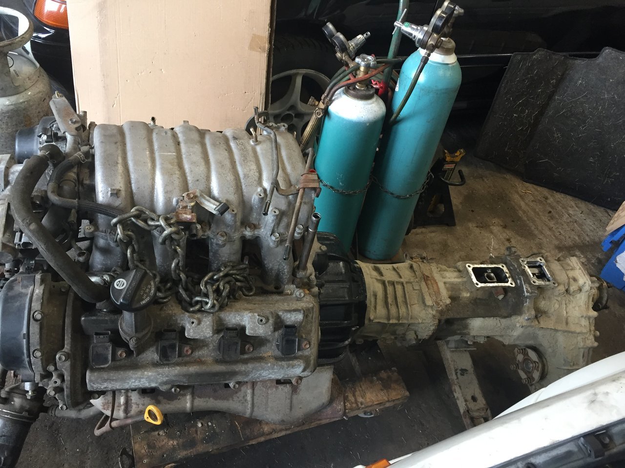

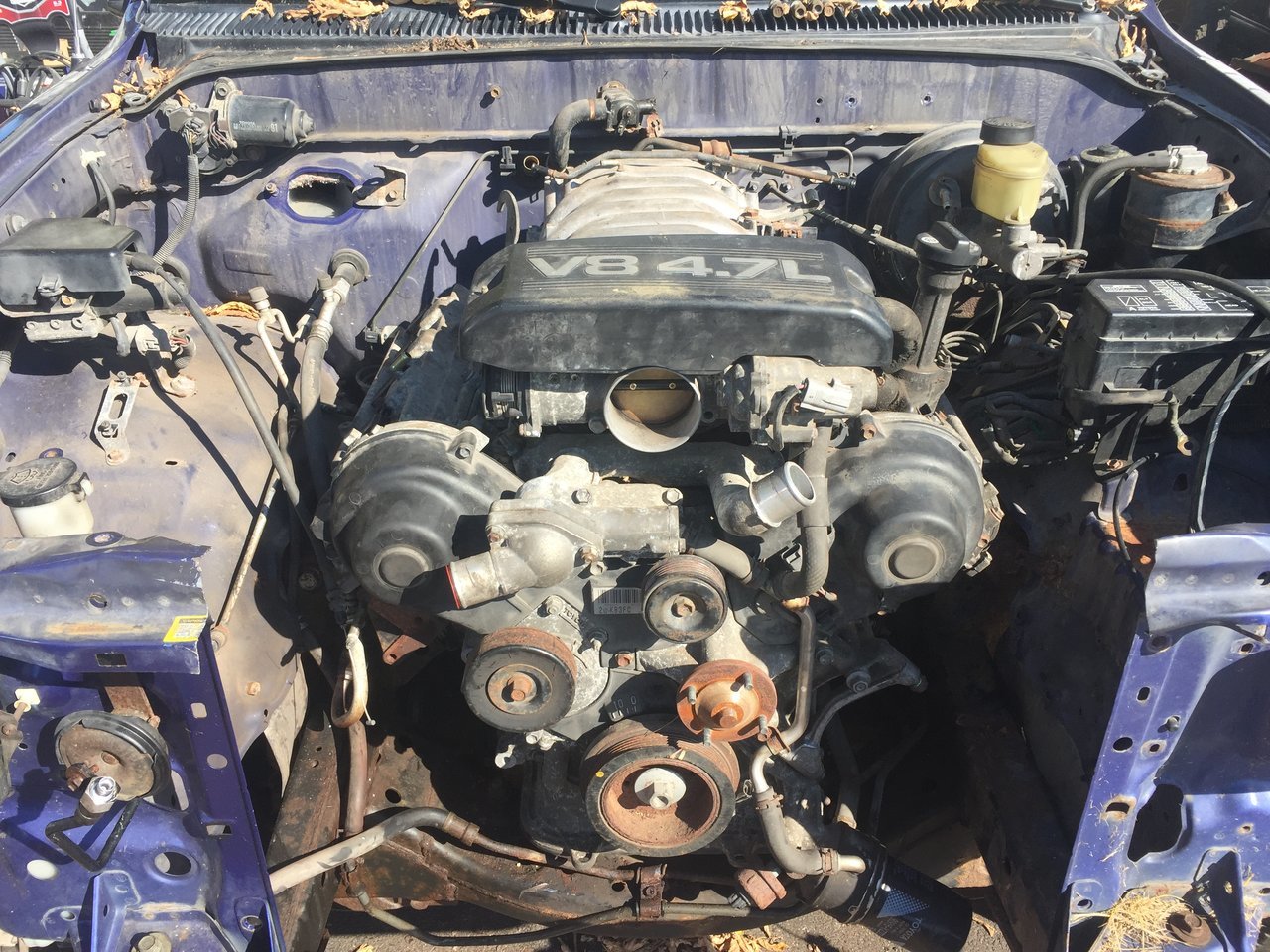

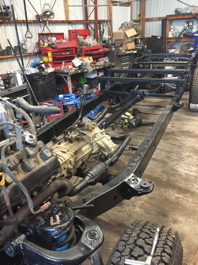

    The 2uz swap consisted of the ebay bellhousing, 3s modified flywheel, and 3s clutch. The motor mount brackets are off a 03 4runner with a 2uz. I used the right one on the left side upside down and the left side on the right side upside down. I mated them up with 5vz motor mounts and it just bolted in.

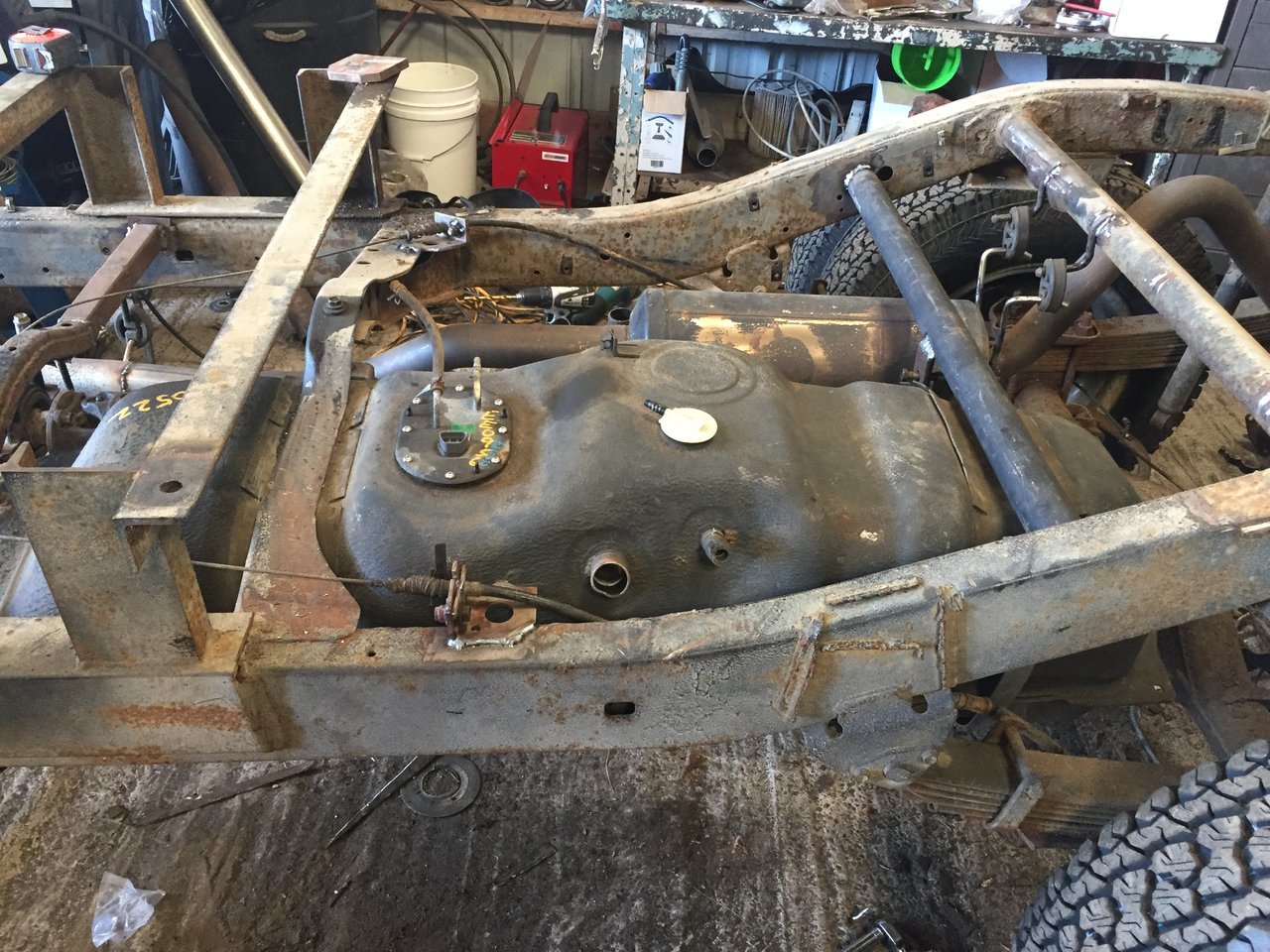

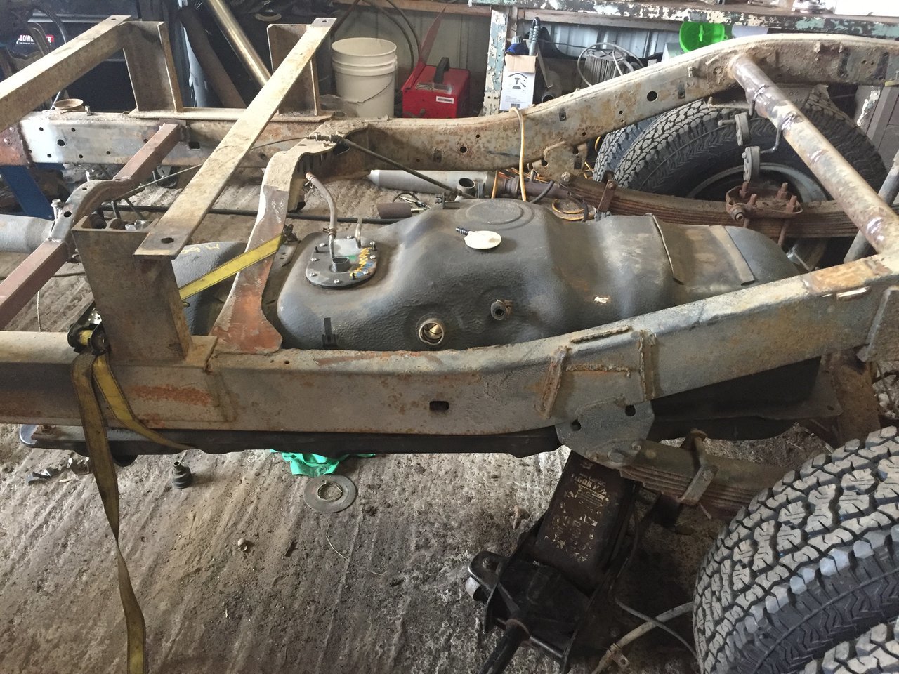

    Fuel tank is a tundra unit.

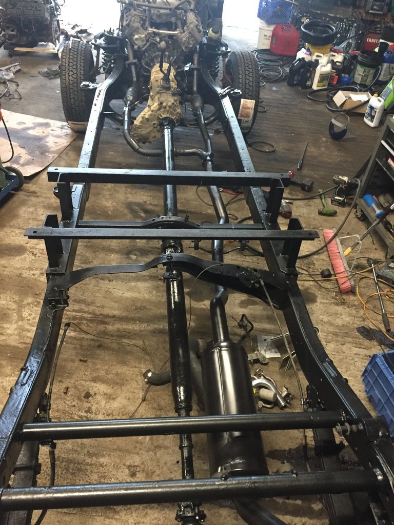

    After all that was sorted I just put the puzzle together

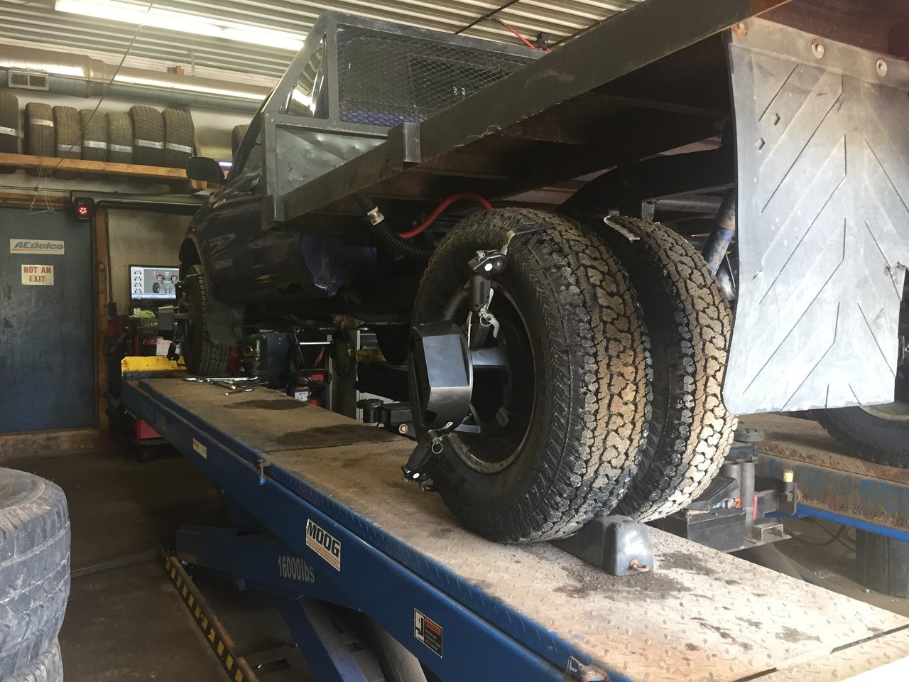

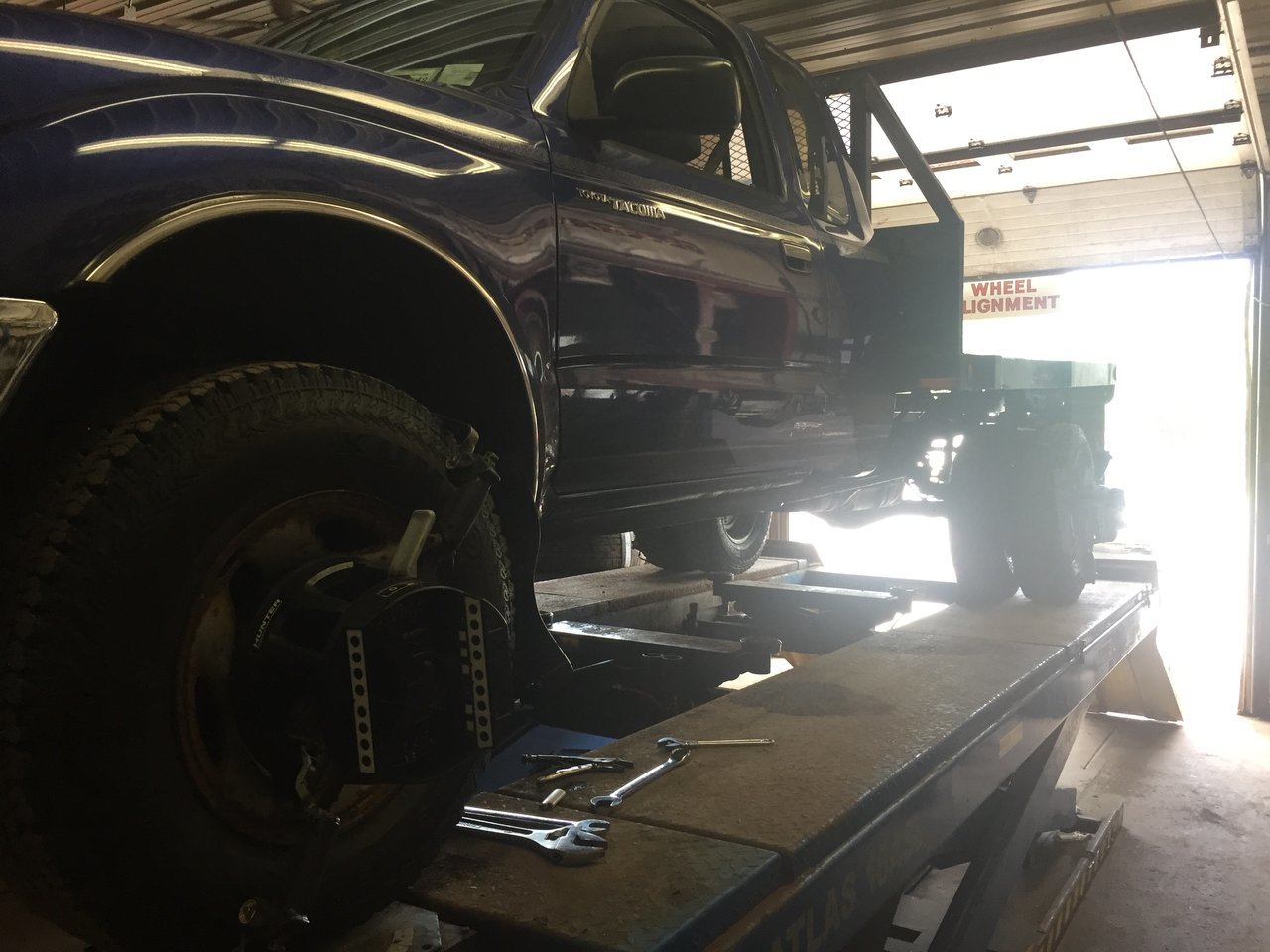

    Last step alignment

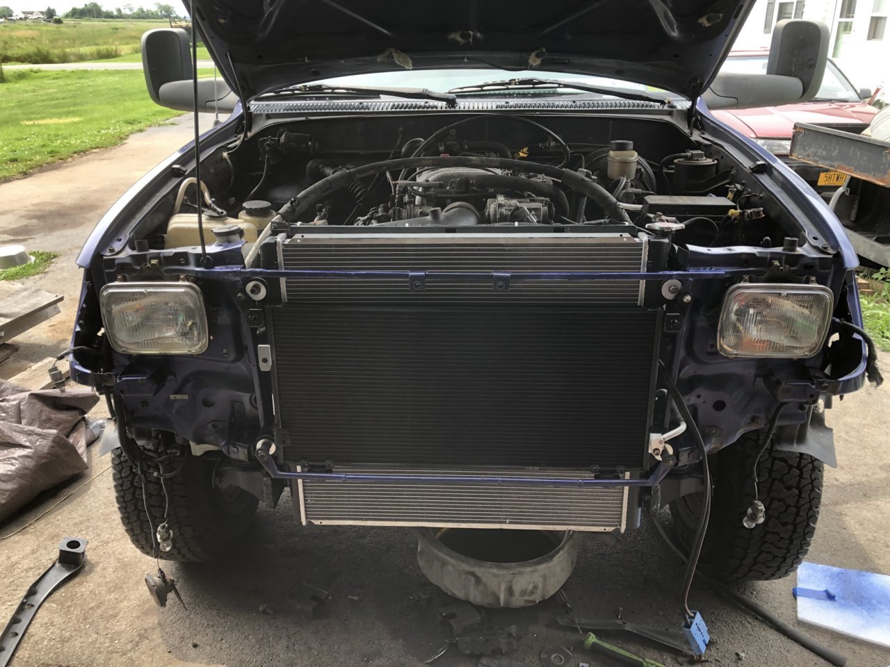

    Update

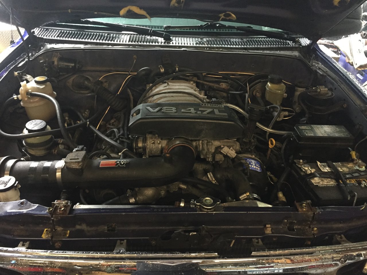

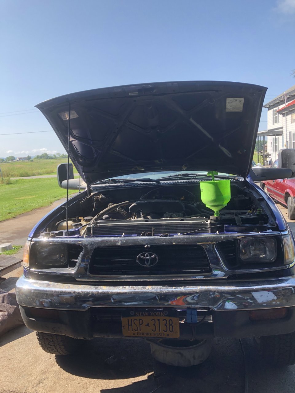

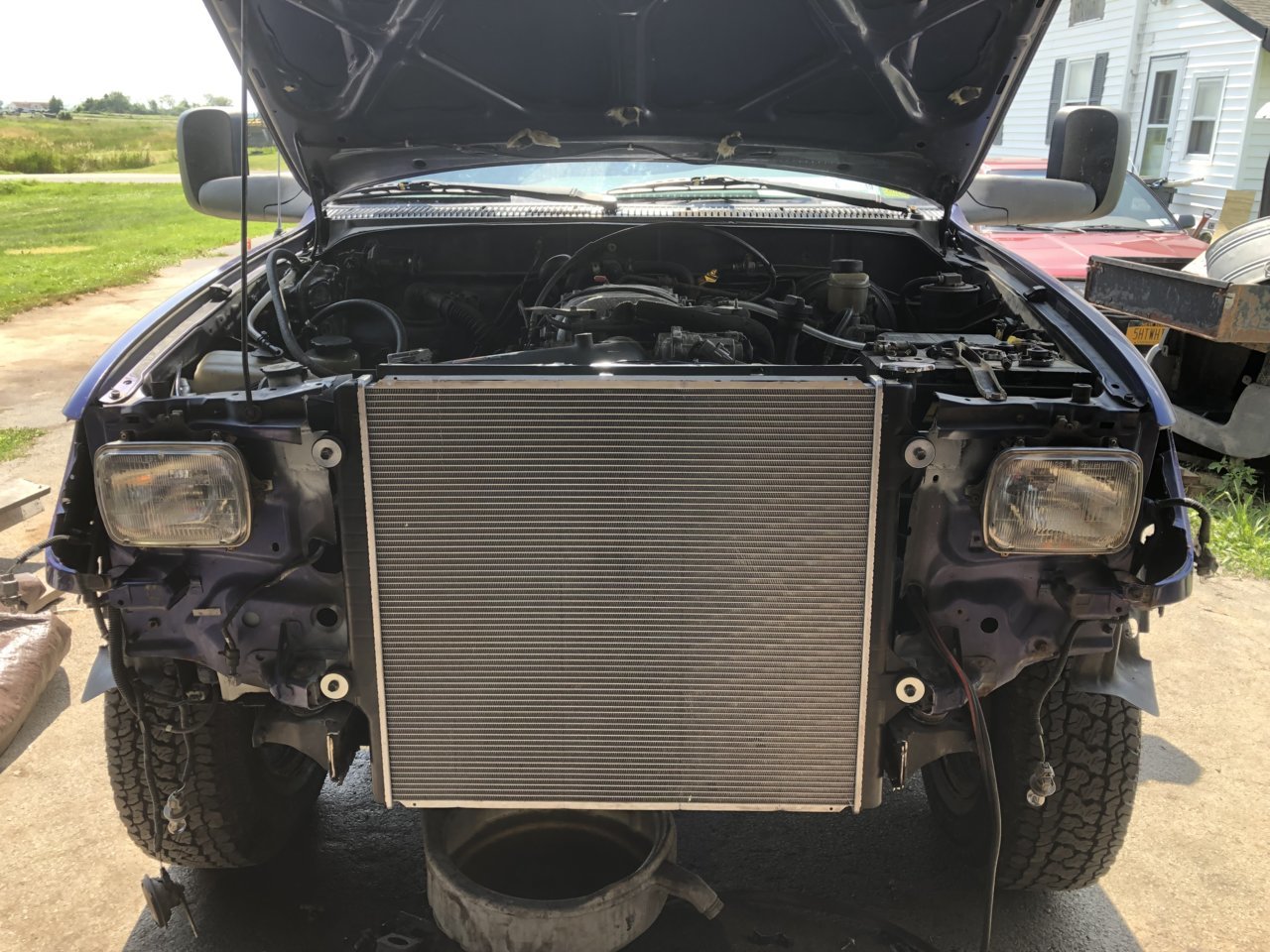

    I’ve been putting the miles on the truck and it has been serving me well. I do not get notifications for this thread idk why. Ive fought with the cooling system for some time and finally got it sorted out. I ended up using a 03 4runner v8 radiator, shroud, and clutch fan. I had to notch the frame a little for it to fit. But i no long have overheating issues on hot days. Im also trying to get the a/c working here are some pictures
