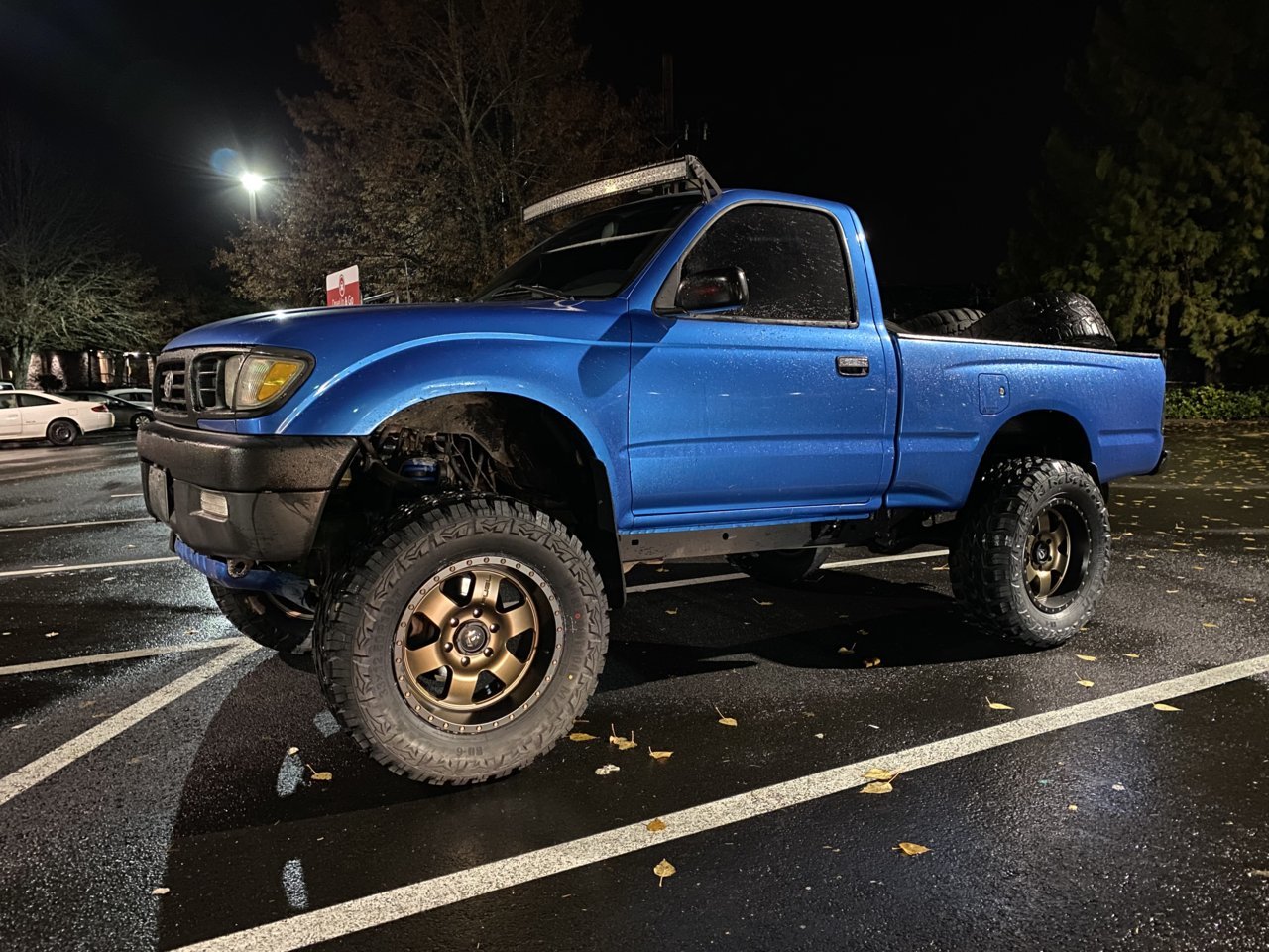

    I have a 4wd 95 Tacoma reg cab w/ 245k that shakes when I’m going 60 but seams to shake less when I go faster or slower than 60, it’s enough that it shakes my voice when I talk. It has brand new balanced and re balanced tires and I’ve checked them for out of round, I replaced the tie rods, ball joints and a few other front end parts, greased the drive shafts U joints and got an alignment, there’s nothing else wrong with the truck other than slightly loose steering and a rear main leak, there’s no sounds, I can’t feel it in the steering wheel or petal and it doesn’t change if I push in the clutch or change rpms.
    do you guys have any idea what could cause it?

    Wow , good size rubber on that critter .
    I am assuming they must be very difficult to road force balance using the Haweka adapter .
    Are those aftermarket rims lug centric or hub centric ?
    Have you rotated them from front to back to see if there is any difference ?
    I agree that using the factory rims and tires for an initial test balance would be great idea .

    I’m not sure, I bought them from a tire shop but this is what I found online, mine are 18s though. One of the tires looked about a quarter inch out of round so I had it swapped out but it didn’t make a difference. I had them balanced during install then I went back and had them all balanced again. I’ll have them rotated when I’m done working on the drive shafts that’s a good idea. I had an alignment done after I replaced the front end parts and they did a good job (local alignment shop not teenage les Schwab or Firestone workers) I removed the front drive line to replace the U joints but driving without the driveline made no difference. I’m going to re install it and do the rear driveline this weekend, then I’m going to do the steering rack bushings.

    I also have have 1 1/2” spacers

    I’m experiencing a similar issue with my 99. For what it’s worth, sounds like we have a similar setup. I have 3”, 285s on 17” sport wheels. I have 1” spacers in order to fit the wheels. Anyways, within the year I’ve had the entire front end replaced. Just shy of $2k and I put new tires on at the same time. After all that work and fresh parts the shake was still there... I’m not insinuating anything cause the truck has 325k on it. All that work needed to be done and those parts replaced. It was time. Just saying, all that and the shake was still very much there. I came on here to get answers and someone suggested warped wheels. I thought that was silly as hell and I never would’ve considered that... some miles later, I rotated my tires and while doing so I noticed one wheel/tire had an ungodly amount of wheel weights on it. So the fella that suggested that might’ve been on to something. I have yet to address the issue, but you could say I’m in the market for some 17” sport wheels.

    Being a regular cab, you have a single driveshaft.
    How much lift do you have?
    Is the rear lifted with blocks?
    I suggest checking your pinion angle.

    i have a 1.5” body lift and 2” blocks, I drove around without the front driveshaft and it didn’t change anything so that would narrow it down to the rear but sometimes I’ve noticed it seams to shake at lower speeds as well. If the new brake system doesn’t work I’ll look into that, Rn my front brake is dragging so it needed to be replaced anyway.
