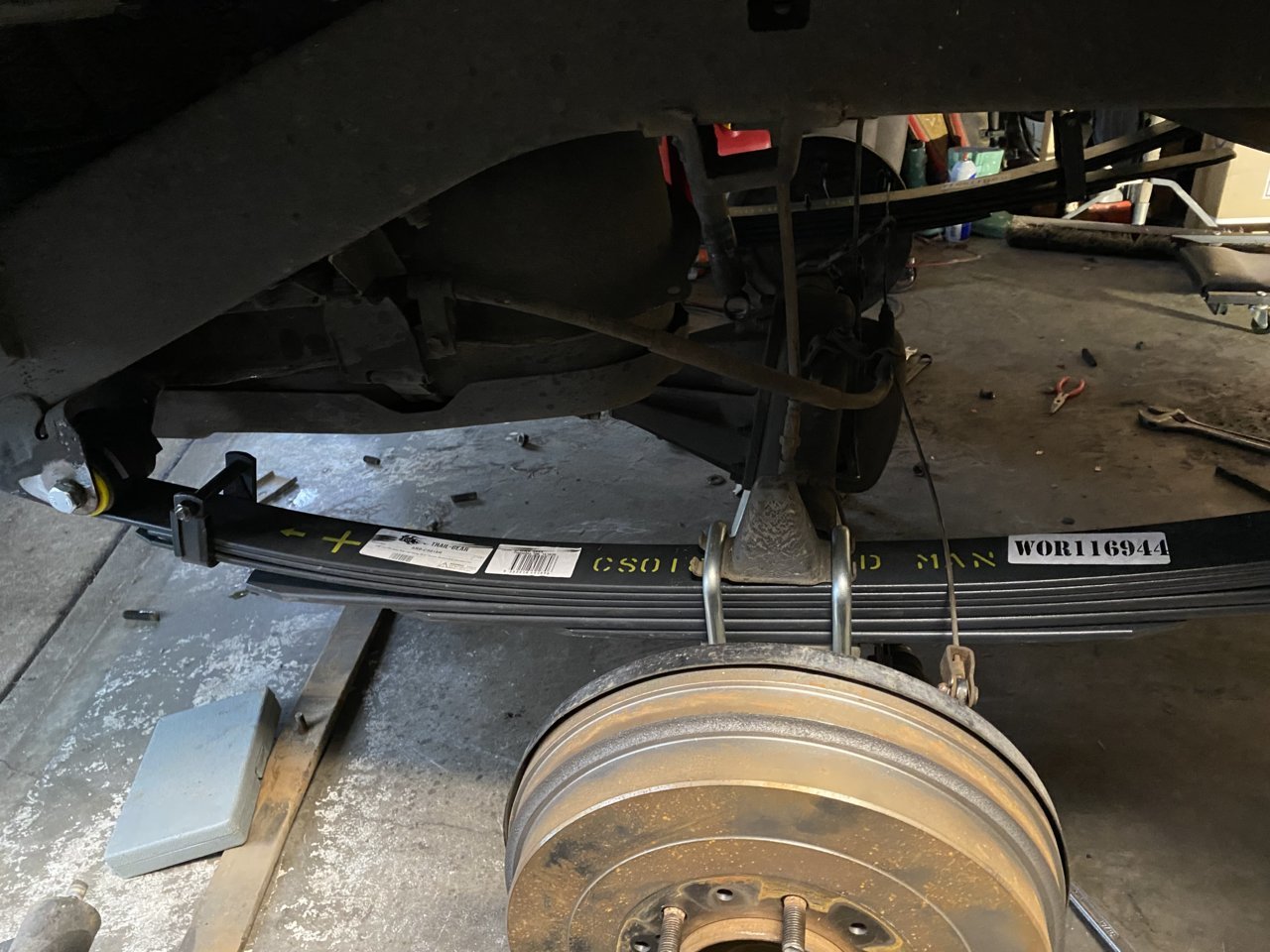

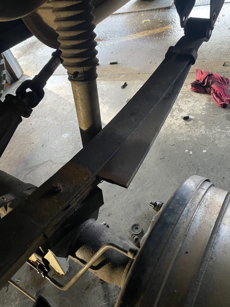

    In case anyone one was wondering, after replacing every part on the truck I narrowed the shake down to a broken leaf spring. I swapped the springs out with some Old Man Emus and now it rides like a new truck.

    Also as you can see the shocks were upside down.

    New springs
