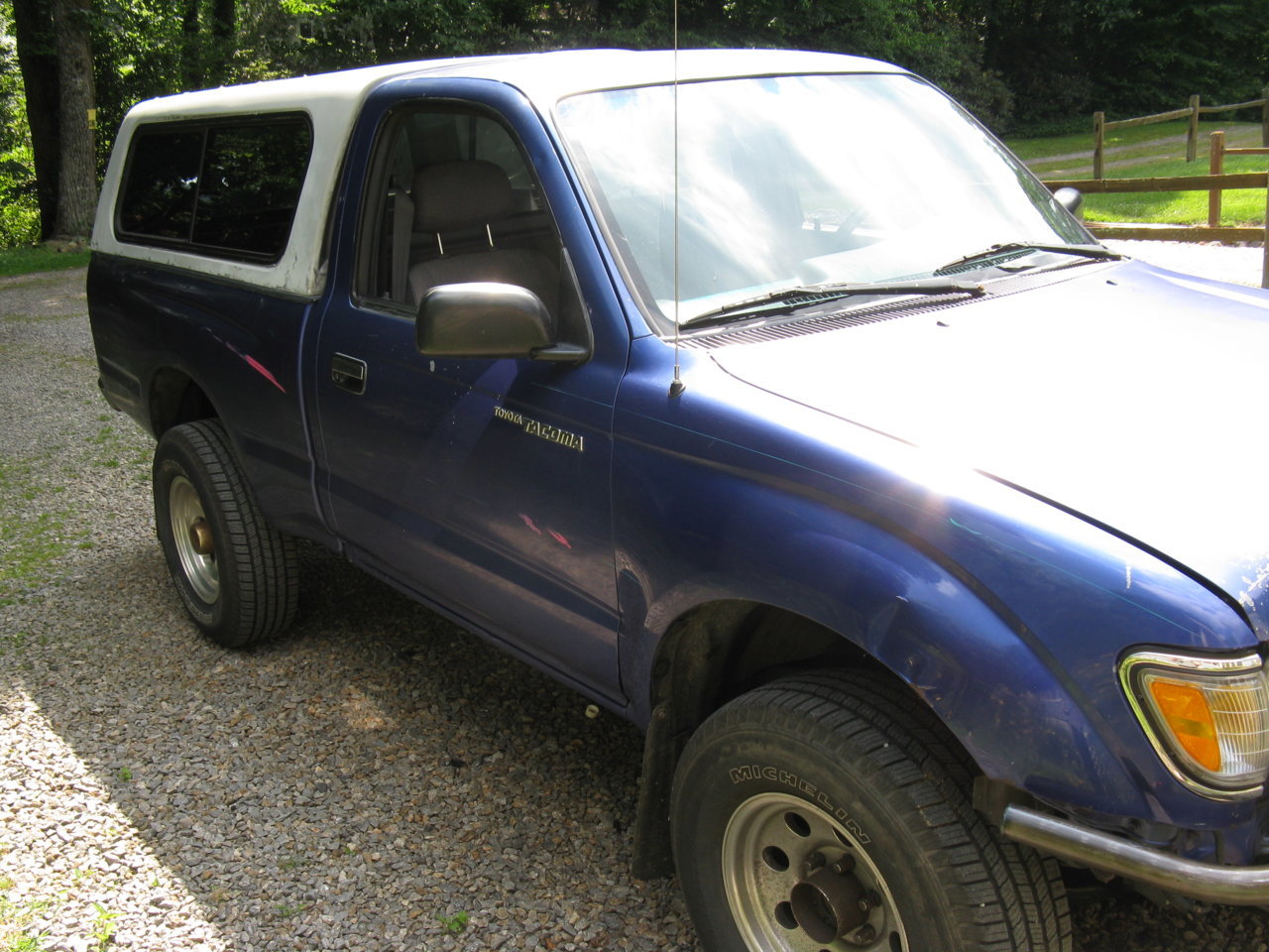

    Picked this up about a month ago. 255k miles, all stock except the funky bumper. Had an 87 Yota truck back in high school (I'm 36 now), but otherwise this is my first Toyota since. Most recent vehicles are an '05 Outback, '86 W150, and 95 Grand Cherokee. I may pick up another highway car, but for the foreseeable this truck will be my one and only - daily driver and adventure-mobile. I'm working my way through the truck bit by bit as I can afford. When it makes sense to upgrade parts I will do it. So far I've just done fluids and the front bumper.

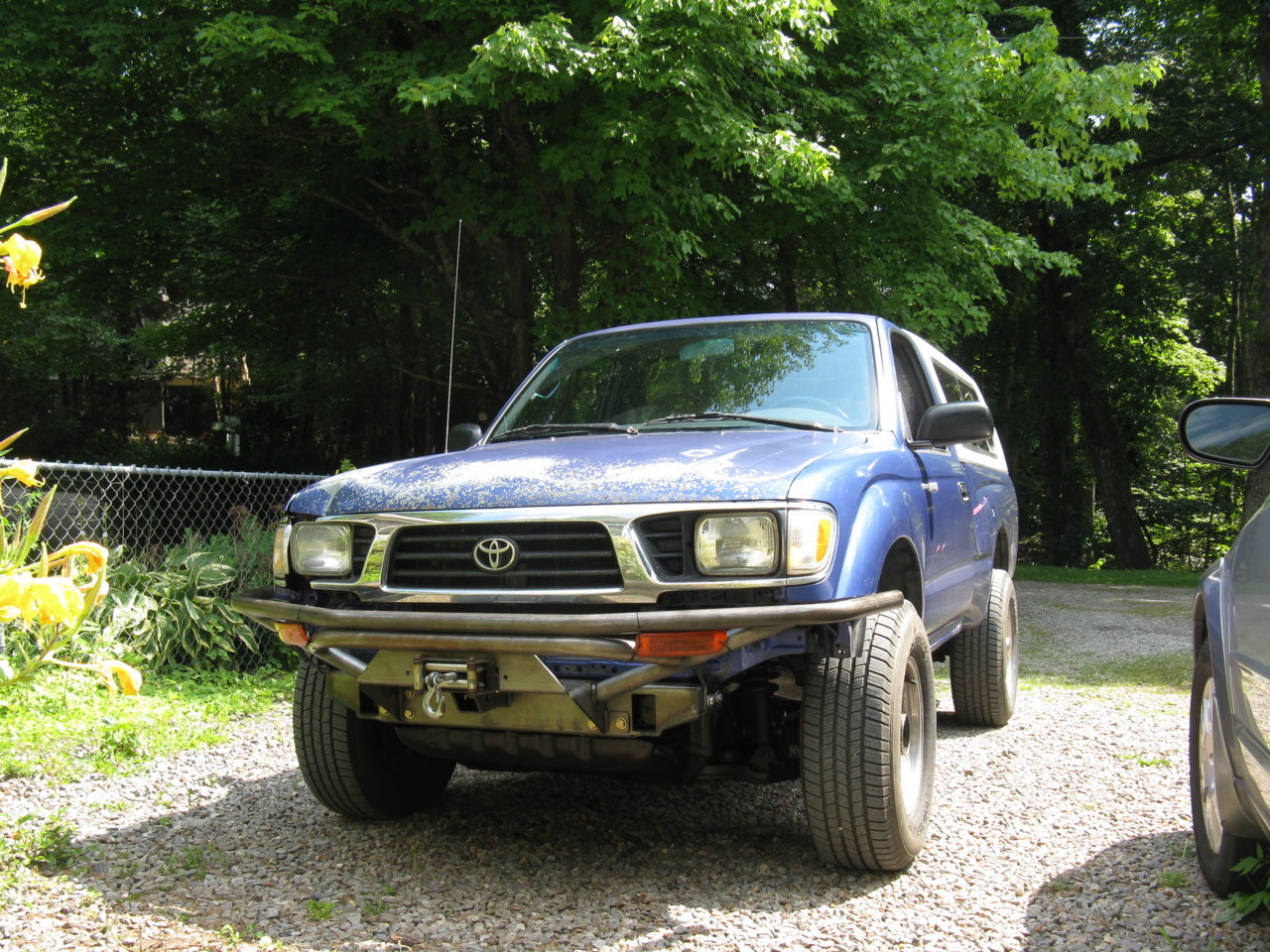

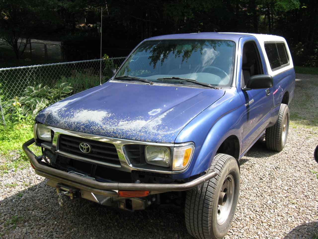

    Here's the truck as I got it. The bumper was homebrew and attached terribly.

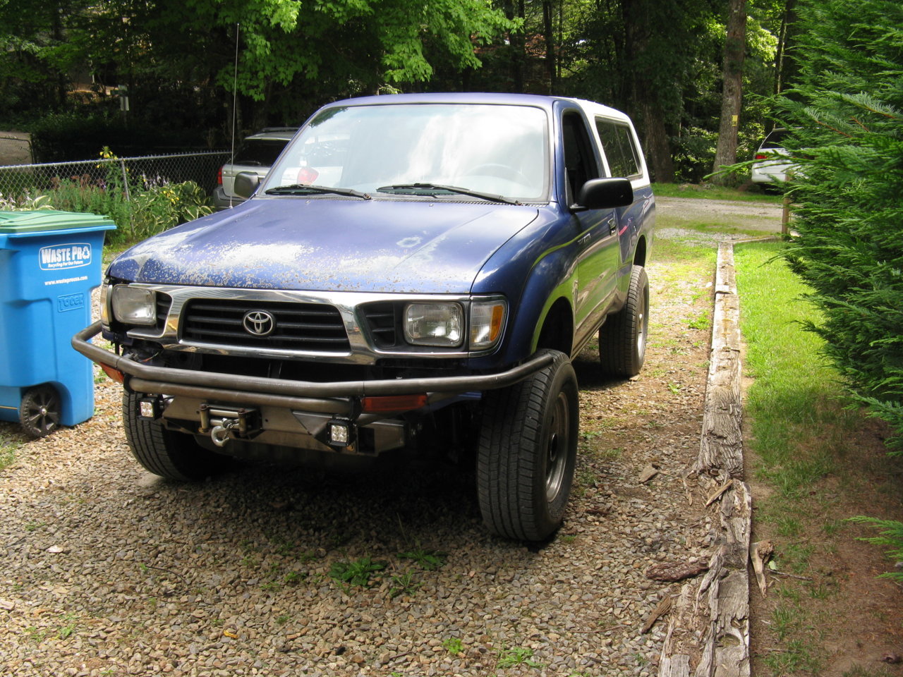

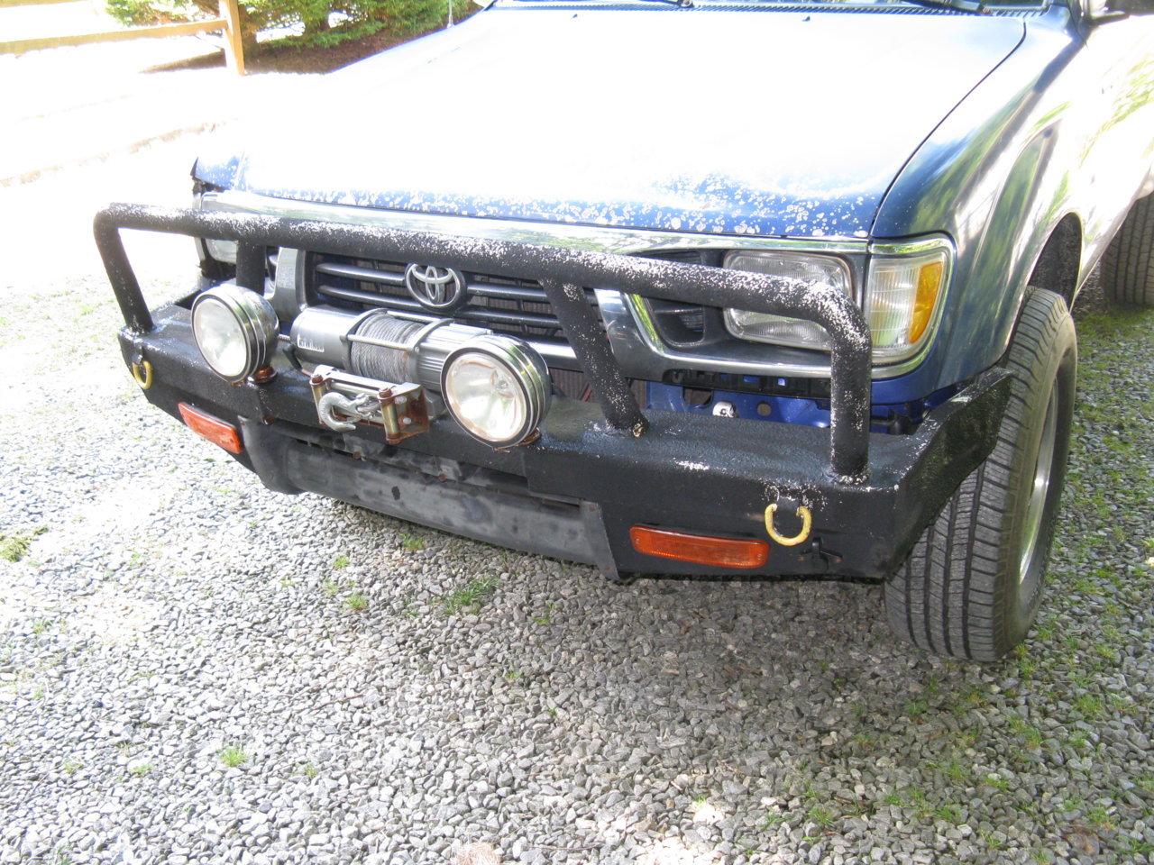

    Dropped some coin to get what I thought was a good option from trailgear. This is what it looks like now.
    Front suspension is way past worn (bottom mount bushings are completely gone), and with the added weight of the winch sags quite a bit in the front. Got some cheap new oem-style struts coming from rockauto, hopefully they'll do until I decide on a more complete suspension upgrade.
