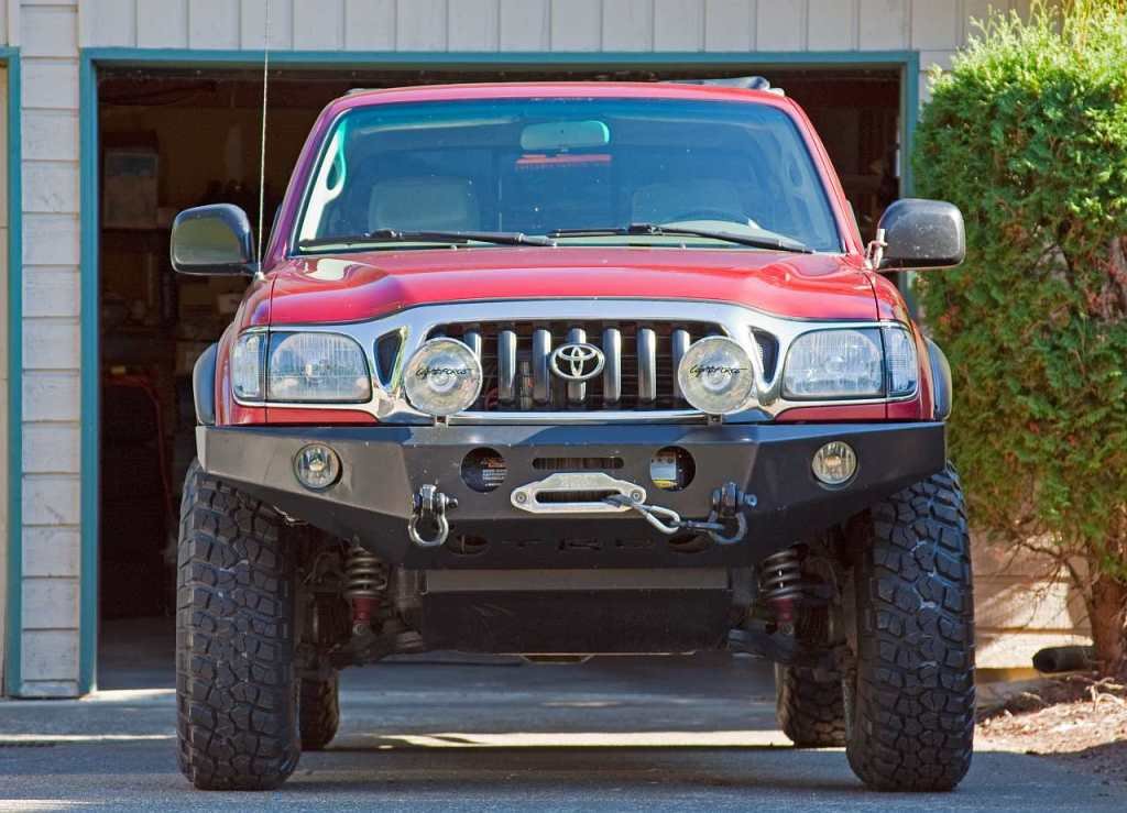

    Can you do dual lights like this?

    i might sound dumb but what are the too holes and the cutout below the winch cutout used for?

    They give you access to the winch controls and to the front skid plate mounting bolts.

    there is no other way to reach the winch controls? your truck looks great by the way!

    The holes next to the fairlead allow you access to the winch clutch.
    Solenoid must be relocated as the space is too tight for the solenoid
