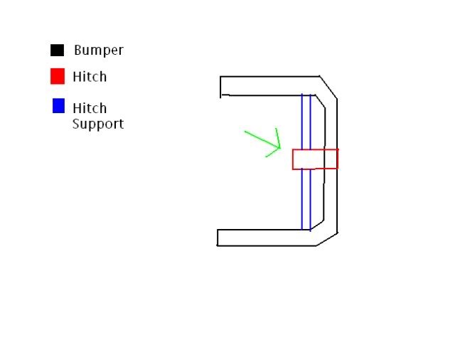

    Here is a quick drawing I just did in paint. Where the arrow is pointing, is where I had to cut. There is a support tube for the hitch that runs side to side and the hitch tube actually stuck way out from that. I didn't realize that it was going to hit my spare until I got it painted and installed on the truck. When I pulled the spare up and it wouldn't fit. So I just grabbed the sawzall and cut it off as close to the support bar as possible. There might be an inch left behind the support bar because I couldn't get the saw super close. I cut it off without removing the bumper, I just made sure to spray a little paint on the very end of the tube. Cutting it off did not affect the strength at all because the ball doesn't go very far into the hitch anyway. I have pulled a few trailers and haven't had any problems either.

    Ok, that's what I thought at first, but then I saw JLee's picture of it and didn't see enough sticking out to be cut off. Maybe Tim made an adjustment there.

    Yeah i don't have 3" to cut on mine but I can't put my tire under there anyway so i don't care.

    Oh ok. Yea I had alot more sticking out than that. Mine is about that length now. I also noticed that mine doesn't have those flat plates beside the license plate and the plate that my chains hook to is behind the support bar. So yea he changed a few things when he made mine.
