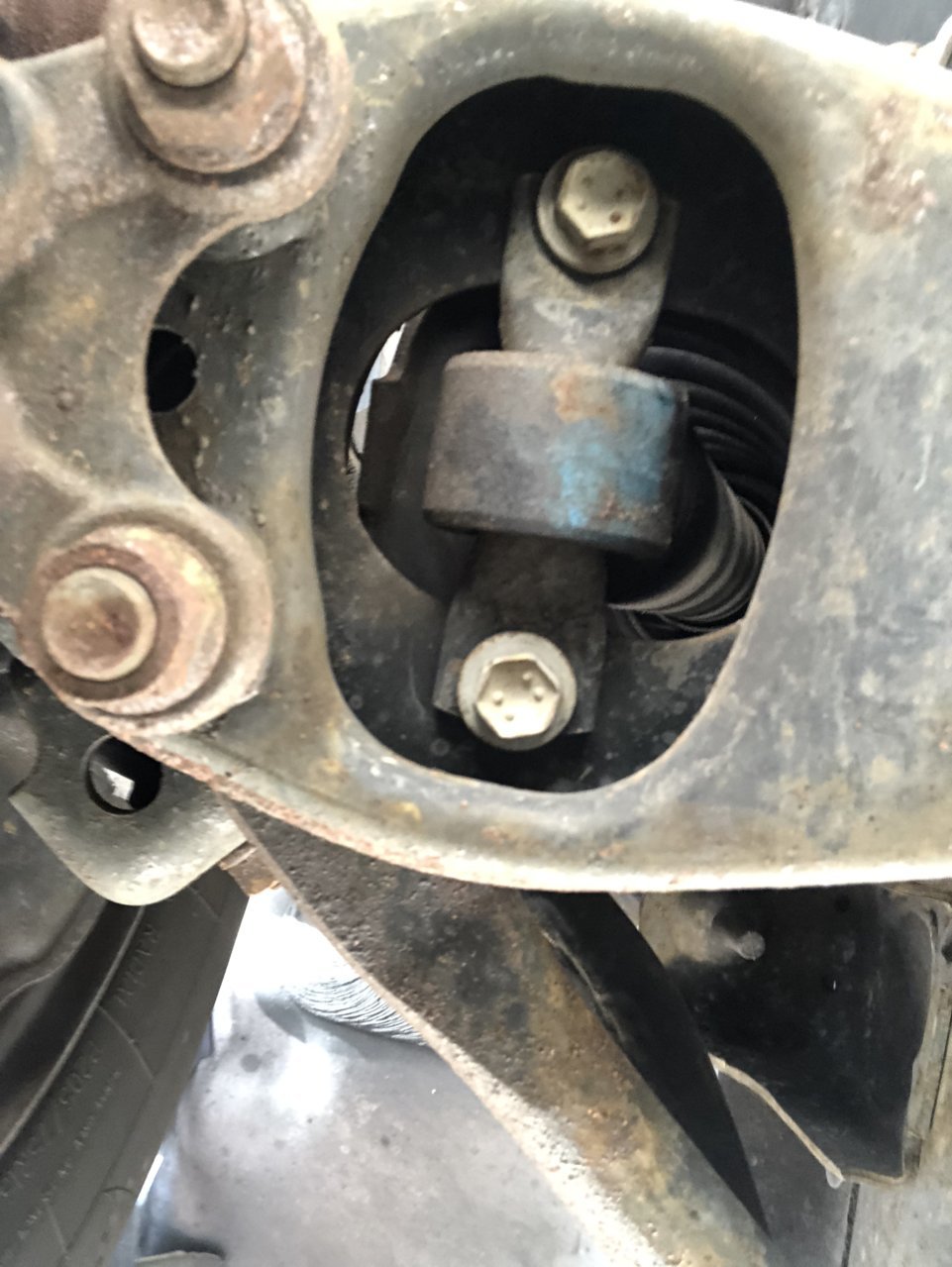

    So to switch out just the shock you can just take these two screws and the top on off?
    Thinking of doing the same. 172k original suspension

    Yeap. Just those 2 bolts and top nut.
