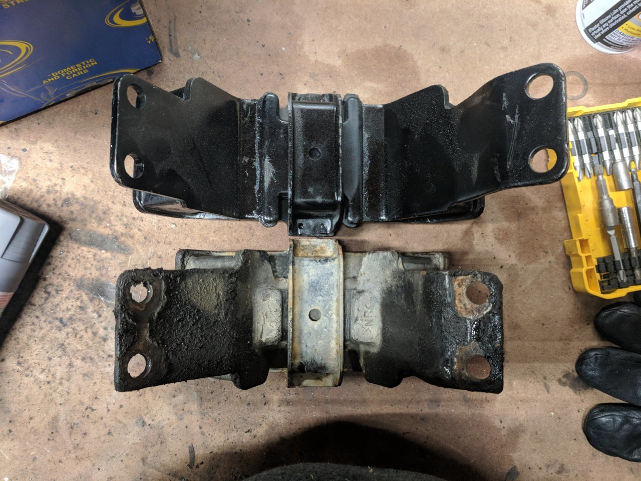

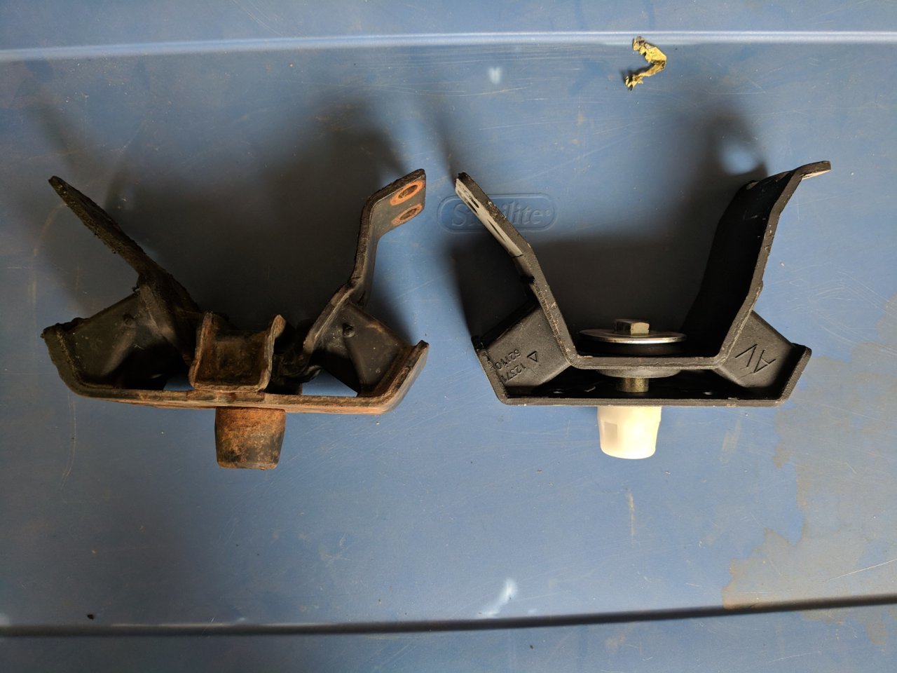

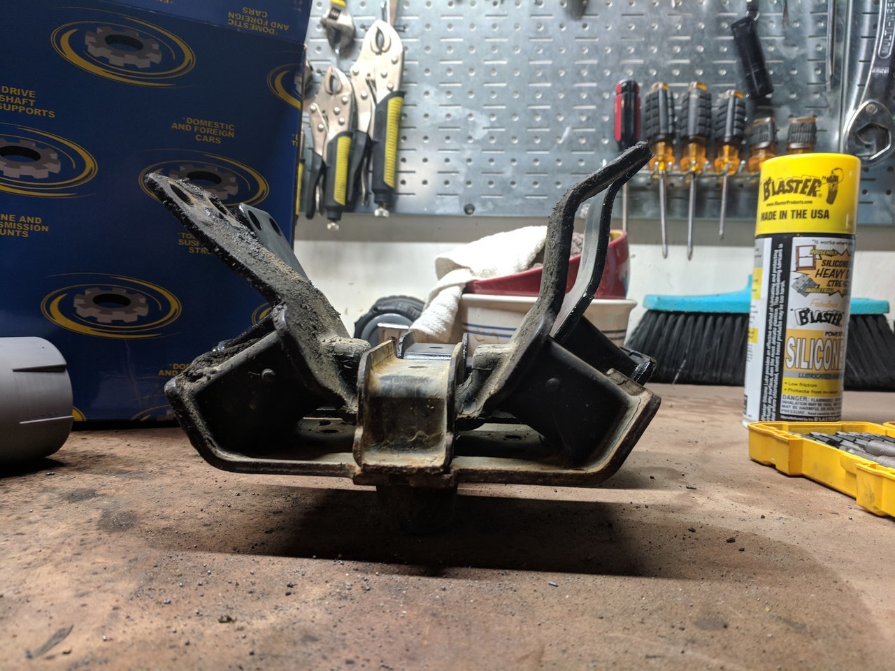

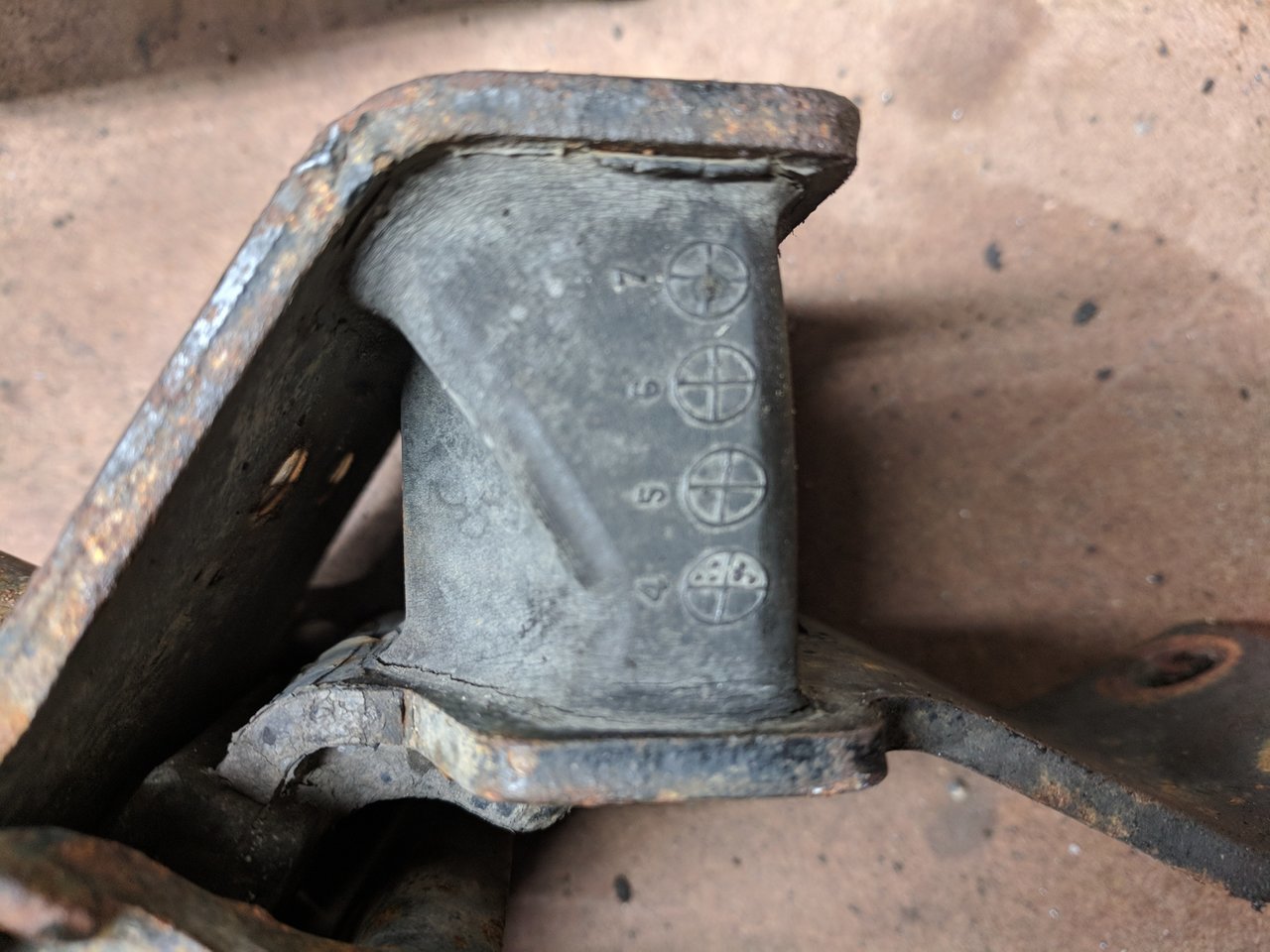

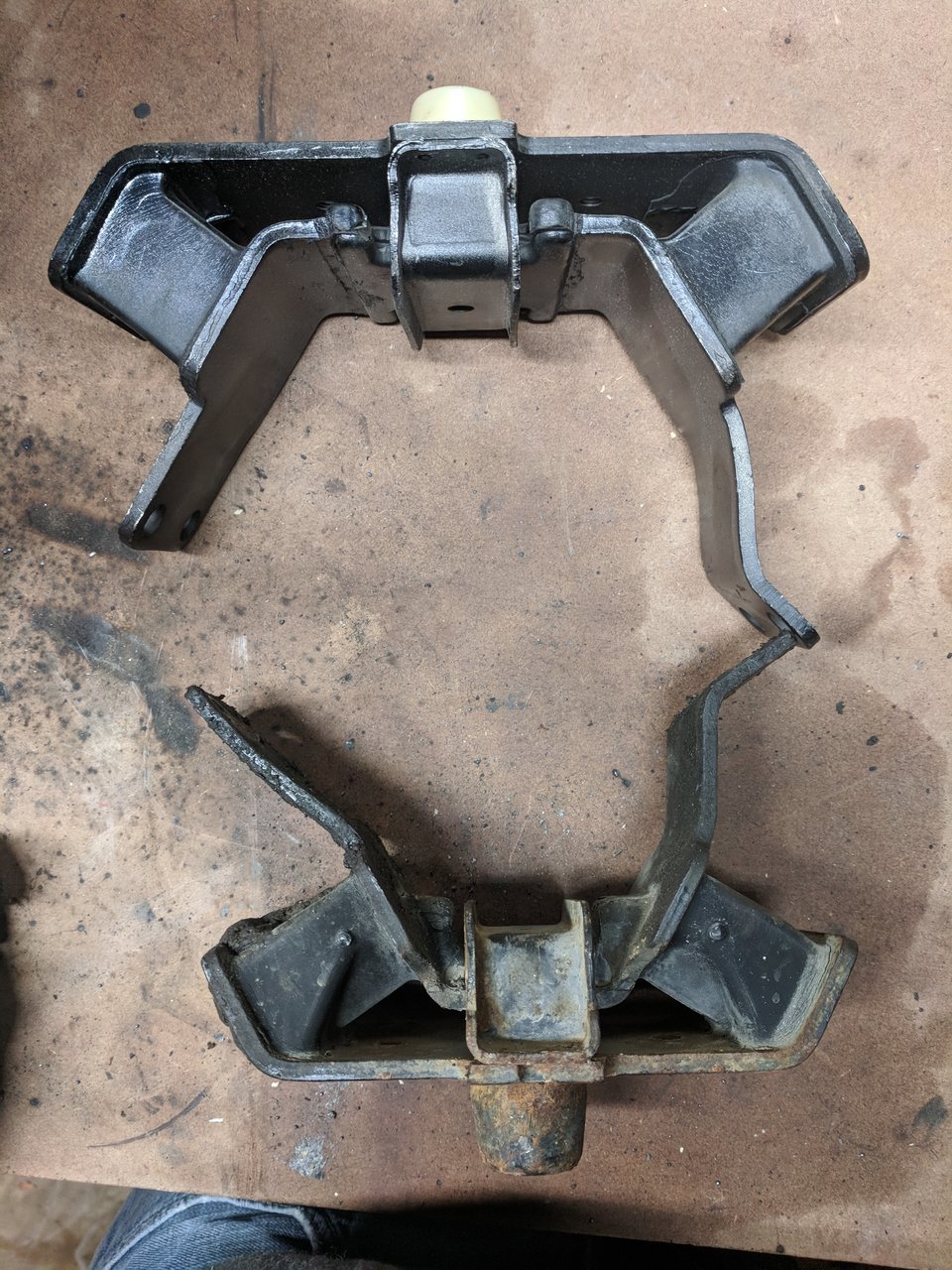

    I cannot for the life of me figure out which part to order for my transmission mount. Thought I ordered the right one from Rockauto and it turned out to be wrong. I have attached pictures of the mount i just pulled out and the one I ordered.
    As you can see the one I ordered is just too wide at the mounting points, and the passenger side of the mount is way tall. And yes I did try to search the forums and it lead me to this point! I ordered the V6 mount because that is what my mount most closely resembles. When I look up the 4 cylinder mounts it looks nothing like the one that's on my truck now.

    Yea and that's my issue. When I look up that part number i get a part that looks totally incorrect. But shows someone having the exact same problem as me. He ordered the part you listed FROM TOYOTA and got the right one.
    However if I look up that part number on any site it shows me equivalent parts from other brands that just don't look right. It seems the whole internet is messed up on this one. For instance autosites tell me to order the Beck Arnley 104-1822 and once again that part looks flat out wrong from the picture. The Beck Arnley 104-1825 looks almost exactly right but that is listed for 93-98 T100s.
