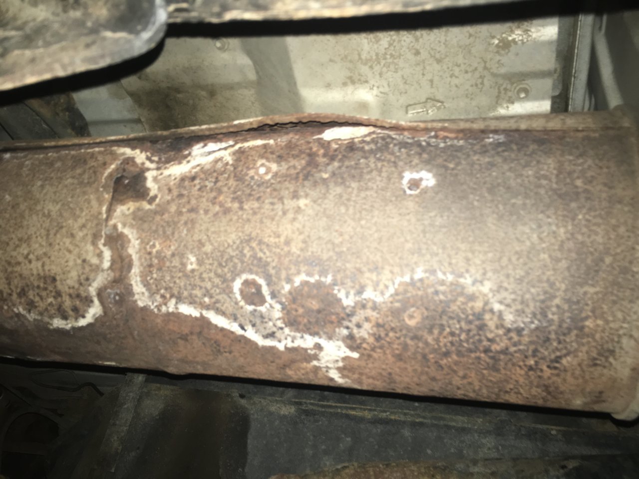

    When’s the last time you gave your muffler/exhaust system a thorough look around/ run through? You could have a bad muffler leak and or/ some holes somewhere along your exhaust if not in your muffler. My muffler looked like this around a year ago and now it has 2 7 inch or so sized holes on both sides of it
