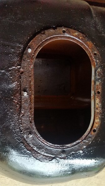

    So here is what I'm looking at. Soaked a bunch of times with pb blaster. Tried needle nose vise grips. Won't budge. Tank draine20160402_120726.jpg d. Airing out.

    122
    4 stubs. Won't budge.

    122
    So I got all but one retapped. Do you think I will be ok with 7 of 8? Should it make enough of a seal? Also, should I run some silicon between tank and new gasket?
