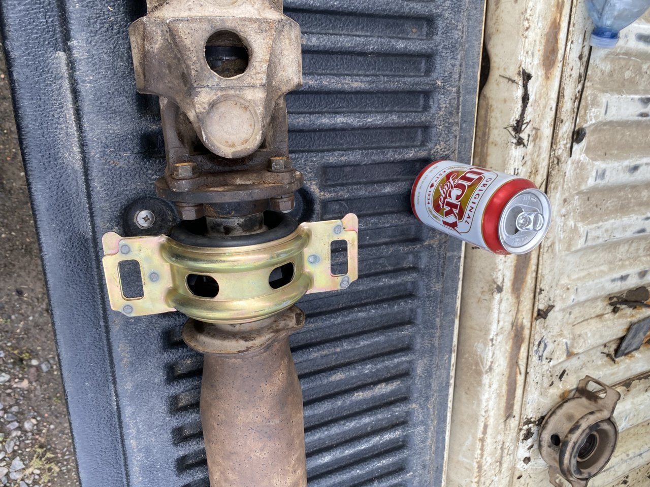

    Hey all, just replaced the original steady bearing in the truck due to a really bad vibration from around 60-100 km. Got the new bearing from Napa and within 250 yards down the road it immediately failed and almost shook every bolt loose in the truck before I got stopped, assumed bad bearing and got another identical one today, installed and didn’t get 10 feet out of the shop before identical issue happened. Just wondering if anyone else has had a similar issue or has any advice on the replacement process TIA

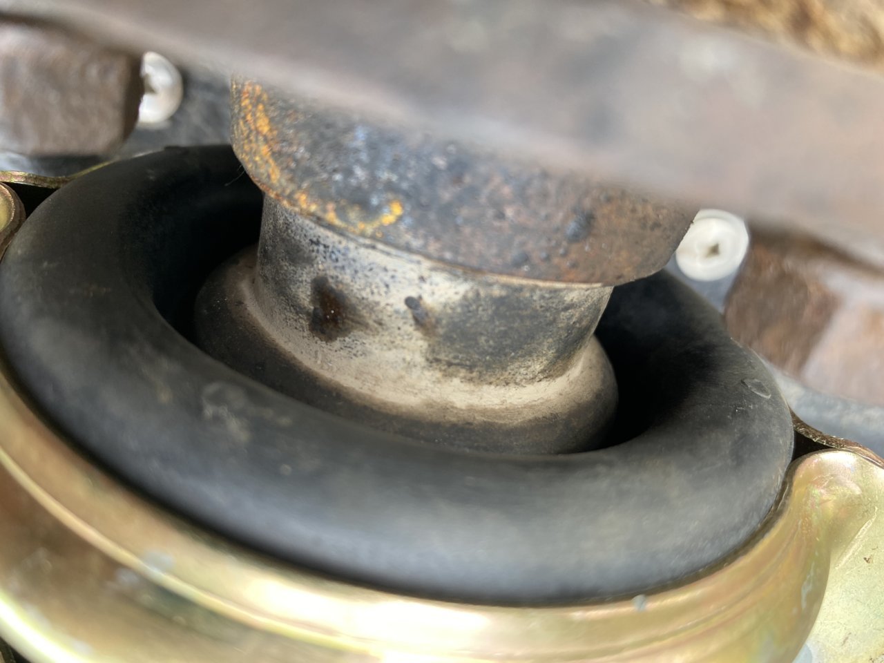

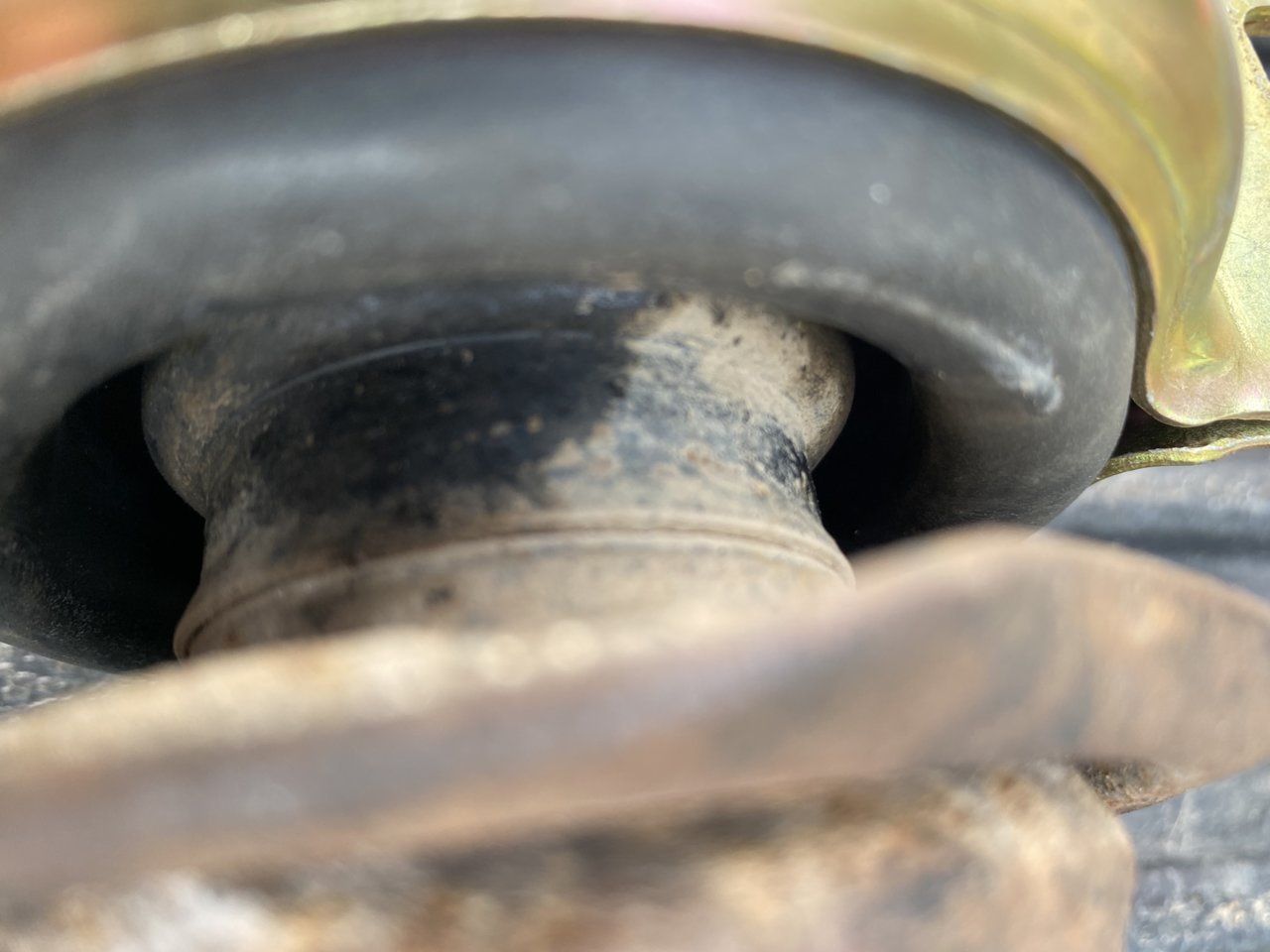

    maineah Well-Known Member

    Sorry meant to say 50 not 60 gotta love a classic typo when it comes to torque specs included some pics of new bearing how I had it in the truck on the last 2 pics I’m not sure if those seals or dust covers were supposed to stay in or not new bearing didn’t come with any

    Yeah I spun it all by hand and it’s seems to be just the bearing that’s bound up, even before setting bearing its way to hard to spin, thinking it might be those seals in the 2nd and 3rd picture but they are way to seized on the come off nicely and I’m hesitant to remove them due to lack of part availability, was really hoping this was a common issue that someone had dealt with before but doesn’t seem to be the case here
