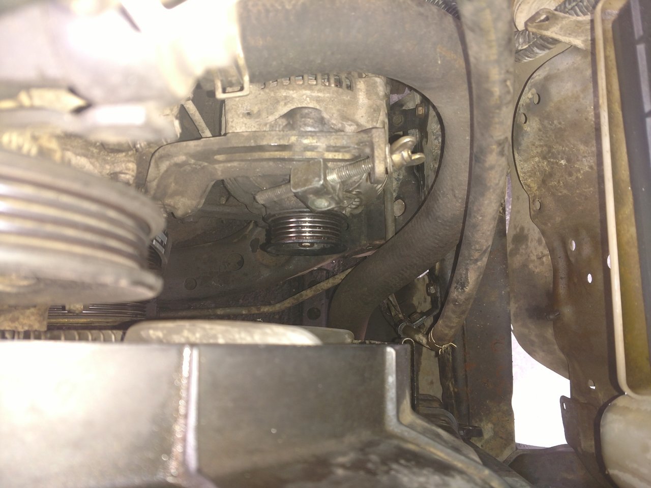

    Im trying to replace my belts, my alternator belt came apart on me a few days ago, and ive gotten them all off (except the alternator belt, but it decided to turn into shrapnel), and I cant manage to move the alternator to get the belt on. Ive completely undone the top bracket, but I cant seem to turn the bottom tension bolt. Ive actually broken a socket wrench so far trying to turn it.
    What am I doing wrong? Ive been stuck in a motel parking lot for two days now...
    Its this guy that I broke my socket wrench on... \/
    Its the 2.7 4 banger. I dont know what I'm doing wrong...

    I use a box wrench on the nut side and rest that on the frame while I break the front loose with a long handled ratchet. Did this yesterday so I know it works.

    counter clockwise to break it loose. It is just a normal bolt and nut

    To remove the belt, you loosen the upper pivot bolt, loosen the tensioner locknut and then loosen the tensioner adjuster bolt to take tension off the belt. Here's a video that might help you:
