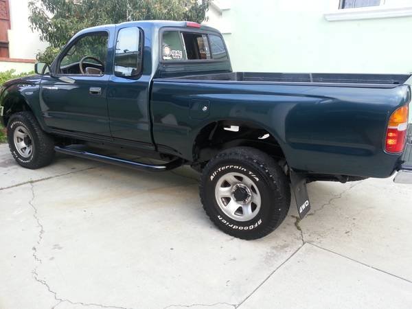

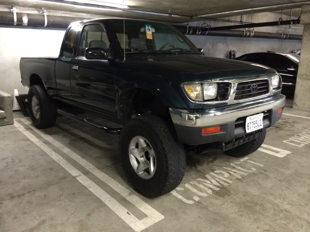

    Pic from the Craiglist ad. Looks pretty, but not so much. Frame was bent, windsheild broken, upholstery torn, water damaged head unit, blown speakers, broken door lock, and fried blower fan. But I bought it anyway. Replaced the windsheild, stereo system, door lock, and blower fan. Repaired the upholstery and had the frame straightened. It did already have a 3" body lift and and Injen intake.

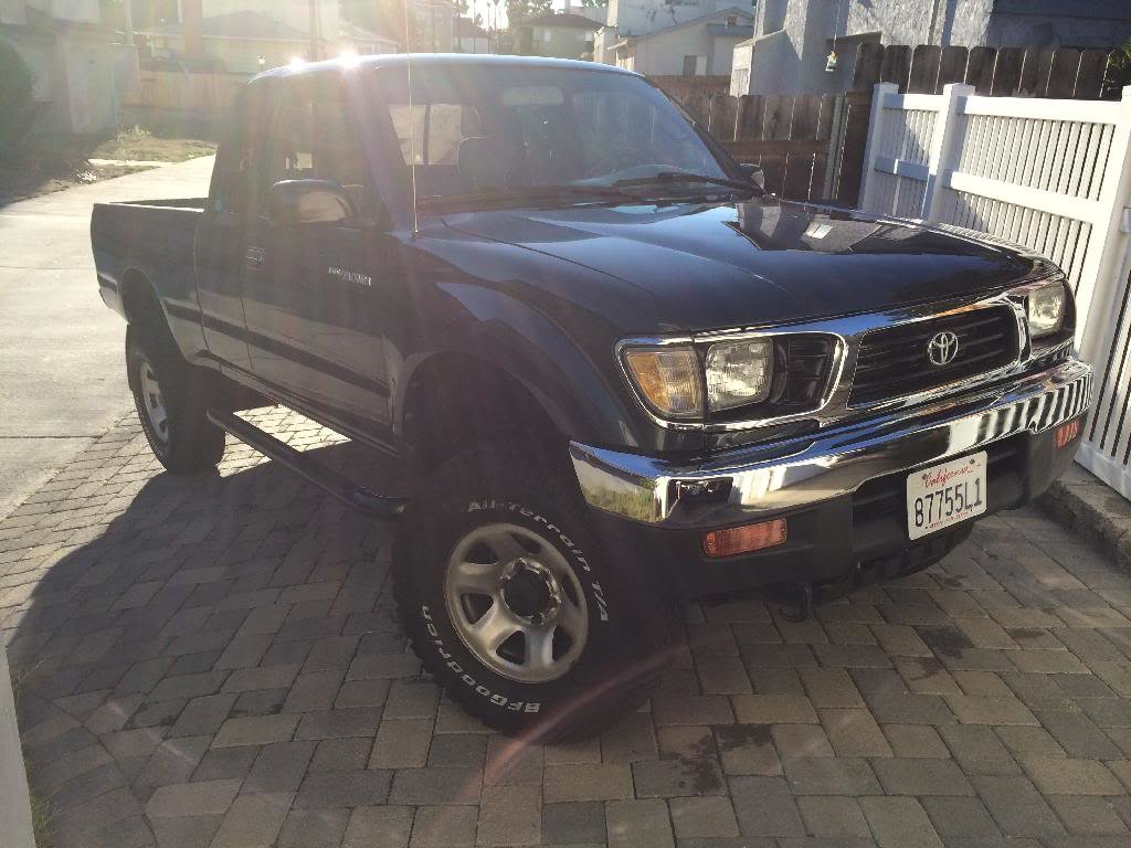

    01591C04-D432-4738-930D-0321D7F93460_zps_a3349452fdd924cd1962023c4750d728eda2b48e.jpg
    All fixed, now time for fun stuff...
    BCE99C4B-E37D-4217-B3EB-6029BF7A3731_zps_e2dba57b7035e29328f75da8ae818f6f2c8cdce8.jpg
    Debadged and I bought a set of 2002 stock alloys with 285x75r16 BFG's for $190 on Craigslist and sold the old steelies for $100. No center caps, but thats ok for now, someday. Now I have a small amount of frame rub, so I want to put on some wheel spacers. I am concerned about fender rub with the spacers so I ordered a set of Eibach lift springs and Bilstein 5100's, as well as the spacers. Not sure if I need a diff drop. I should have installed in the next couple weeks. I will post more pics when it happens.

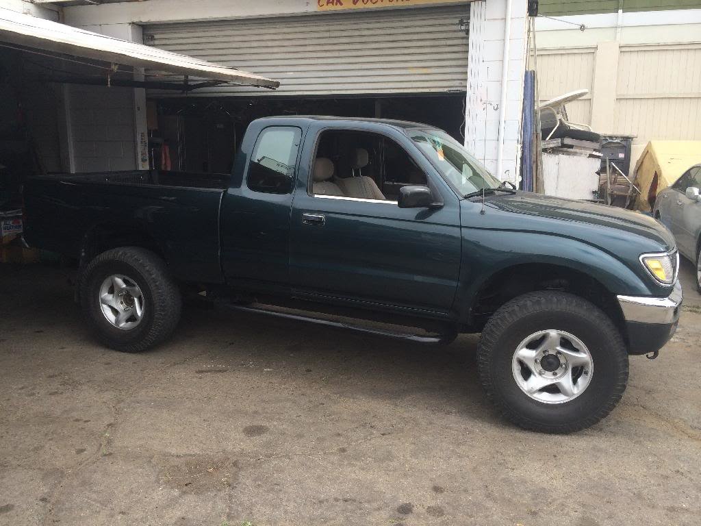

    79744312-1EB3-4C29-91CD-1B6E26E78562_zps_d8659b1777873cc7b7c63c23e0190a069a6019cc.jpg
    Did the diff drop, really close to the UCA's, so spidertrax going on this weekend

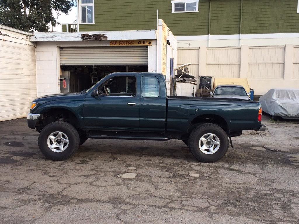

    I wanted it sit a little higher in the front, now I think its a little too much of a difference. Contemplating lifting the rear a little more. 2" toytec shackles and billies in the rear might be in order.

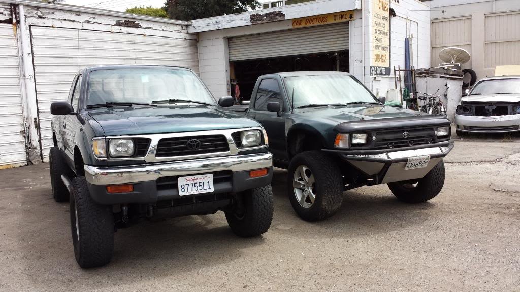

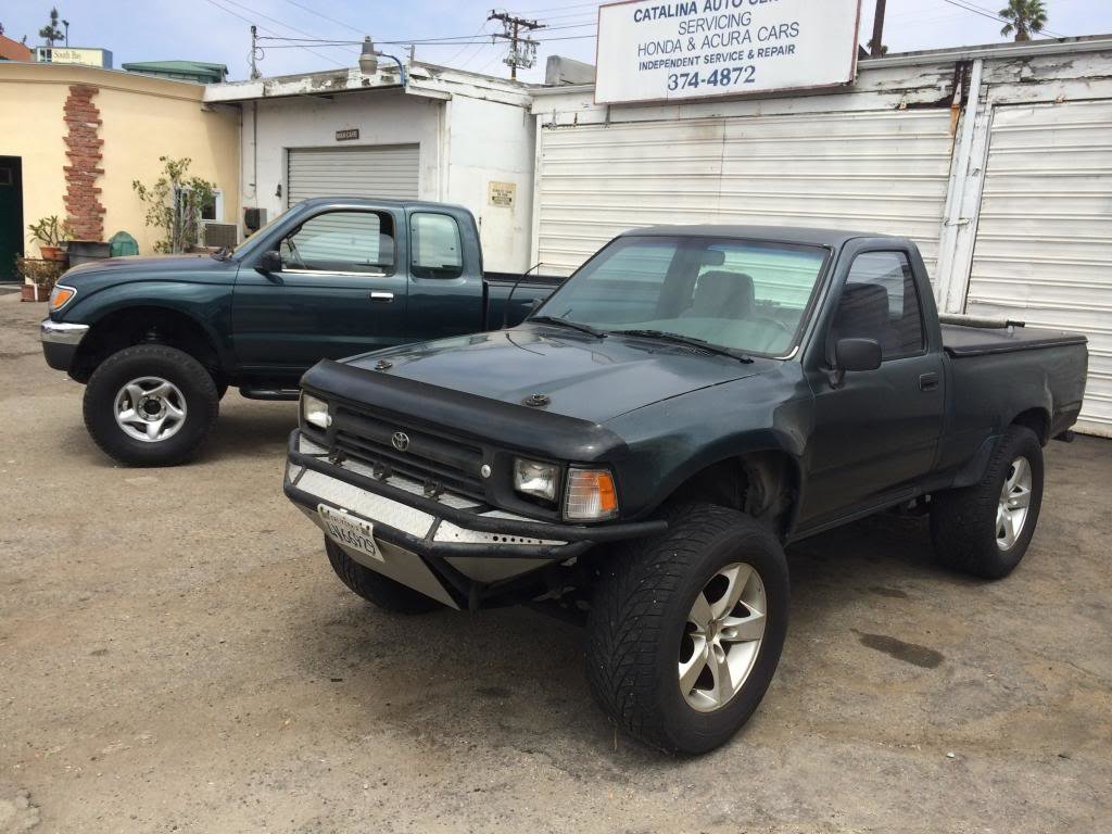

    Hanging with my friend Greg and his 1993

    Is it just me or does your truck have a saggy butt?
  17. May 19, 2014 at 1:23 PM
    #17
    Madjik_Man
    Madjik_Man The Rembrandt of Rattle Can
    Dec 2, 2009
    #26893
    19,723
    Colorado Front Range
    1998 Ext Cab 3.4 4x4 TRD 5MT, 2004 DC 3.4 4x4 TRD
    He has bro lean.
    Read post #7.
