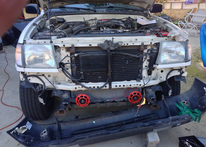

    My '99 Prerunner had one horn, right side, behind the turn signal location. I put the twin Hellas on the horizontal bar behind the bumper: much moar betta!

    Clips can be obtained from the dealers, should you break any...After I put new horns on, most of mine were junk, so I used some heavy duty black zip ties through the holes: no rattles as long as you pull the ties good and tight.

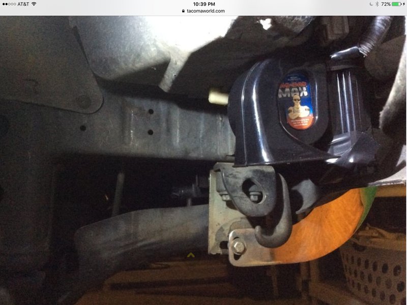

    Just connect the wire you had to the old horn to the bad max air horn , connect to the front frame underside, will take 15 minutes to do without pulling everything apart
