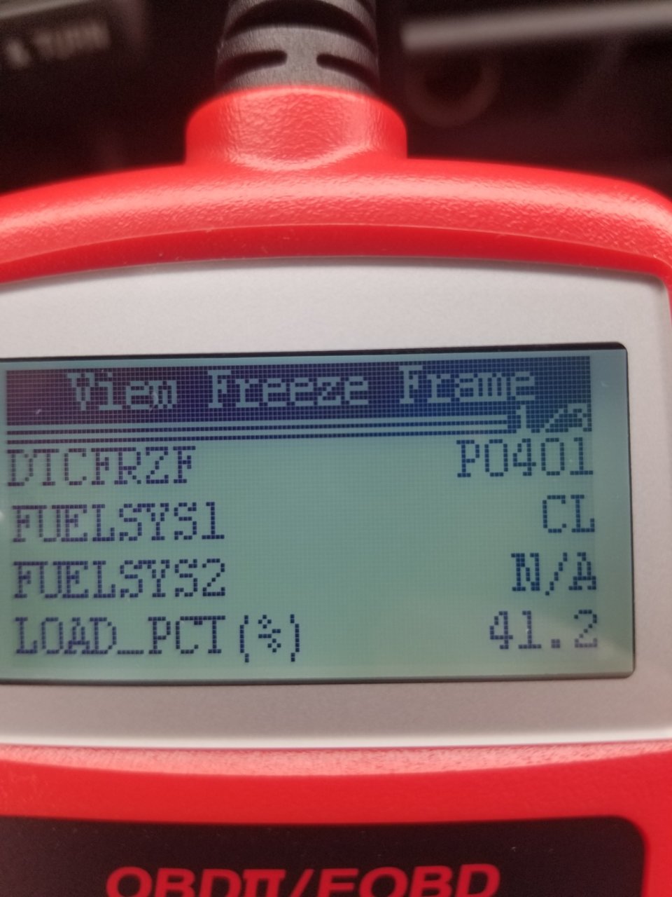

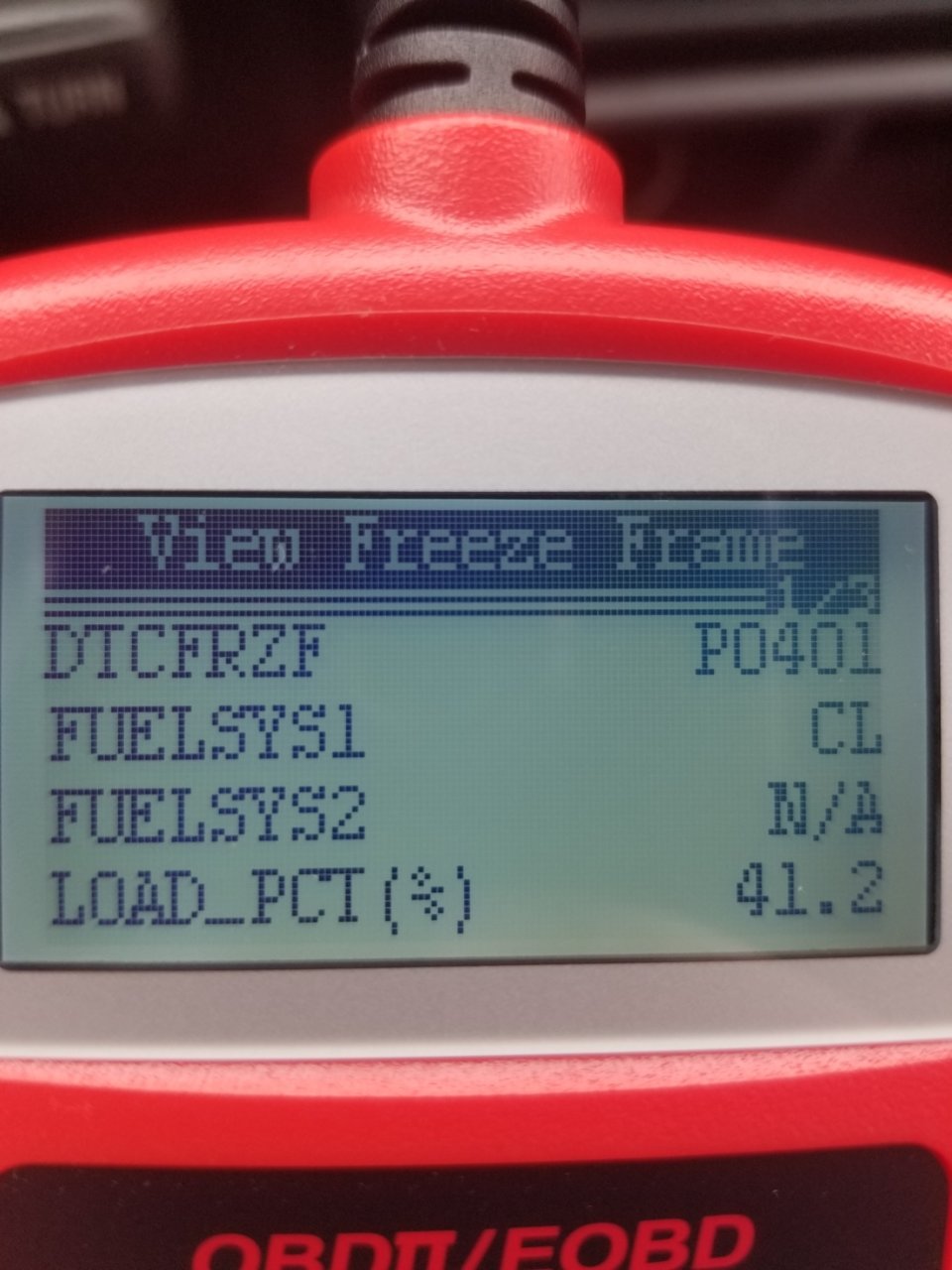

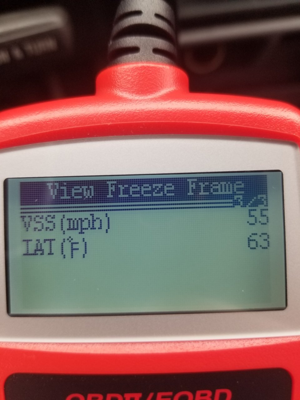

    Yeh here is the freeze frame data.

    Was the engine warmed up at this time. Either the temperature sensor is registering low (I would think it would register a different fault in that scenario)
    or the valve is getting stuck closed or partially closed.
    maybe the switch has failed or the vacuum tubes are leaking. Ill have to check the routing on mine to think it through.
