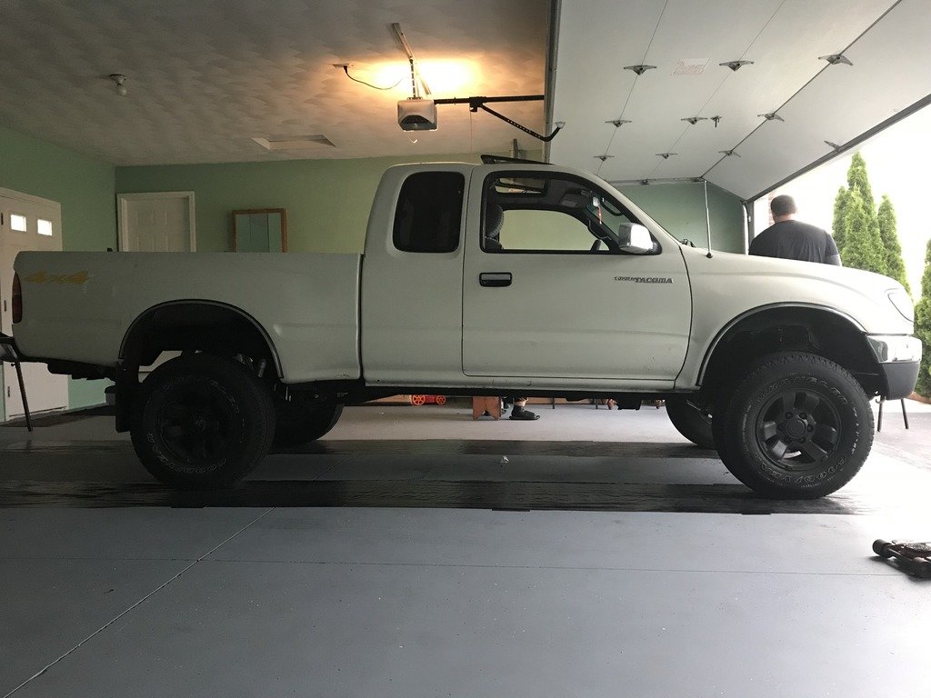

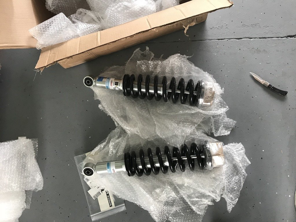

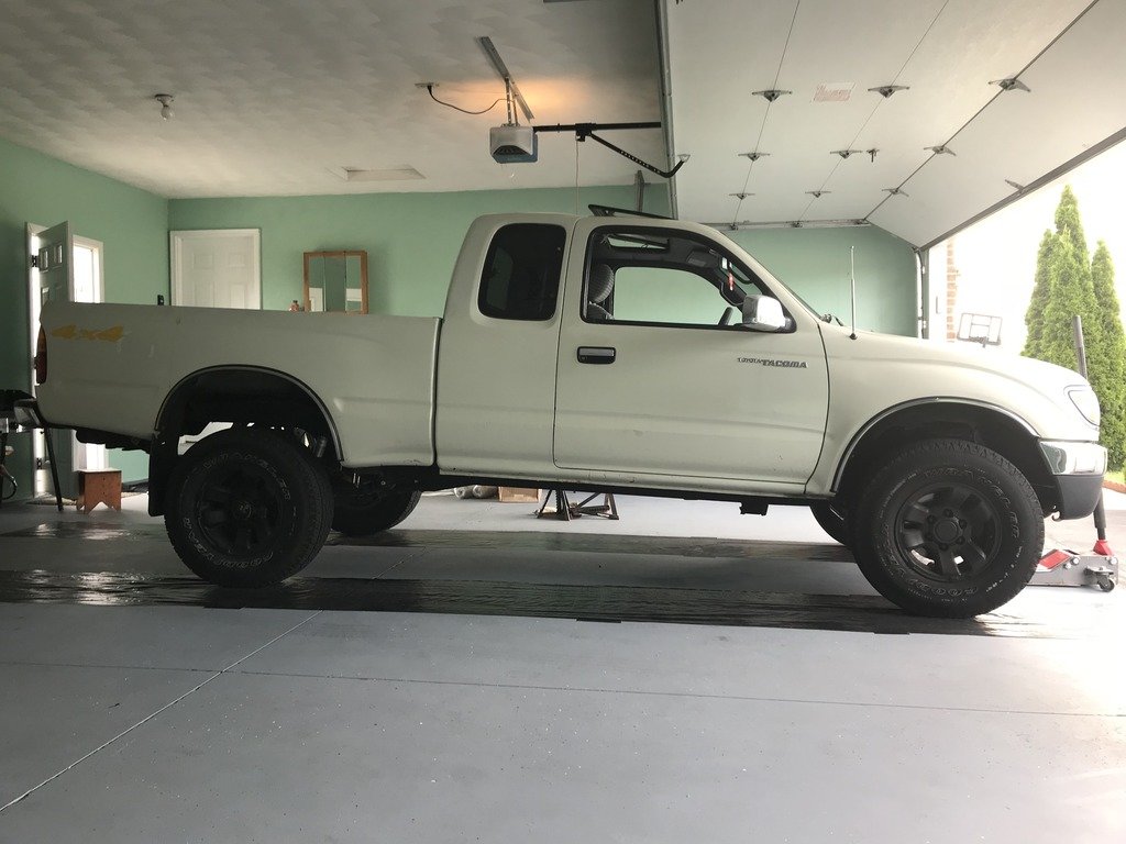

    Ended up going with 5100 and 881 springs. Installed them today and everything went super easy, got it done under 2 hrs.
    Drove it for a little bit and they felt much better than stock ones and somewhat leveled out the truck. Total lift was around 2.5" but from what I read from other owners is that the front will settle down about 1/2" which is unfortunate for me but oh well it is not recommended to go higher than 2.5" anyways.
    Before:
    After:

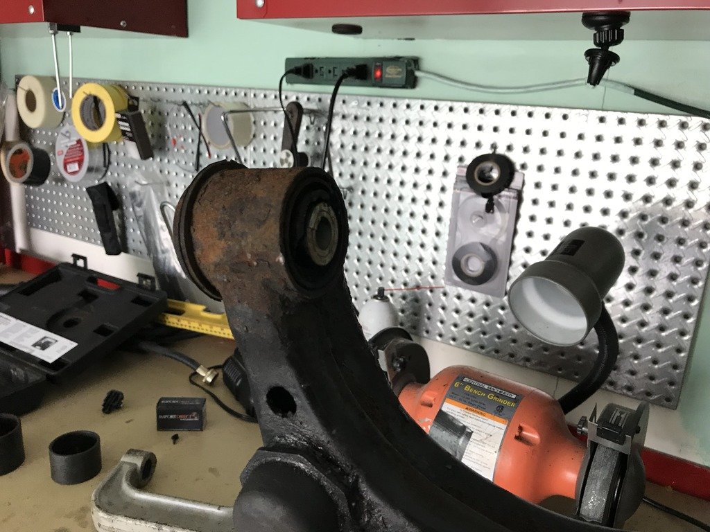

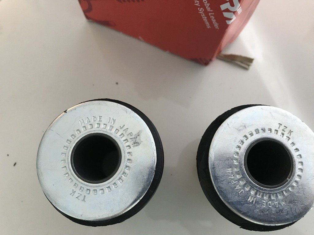

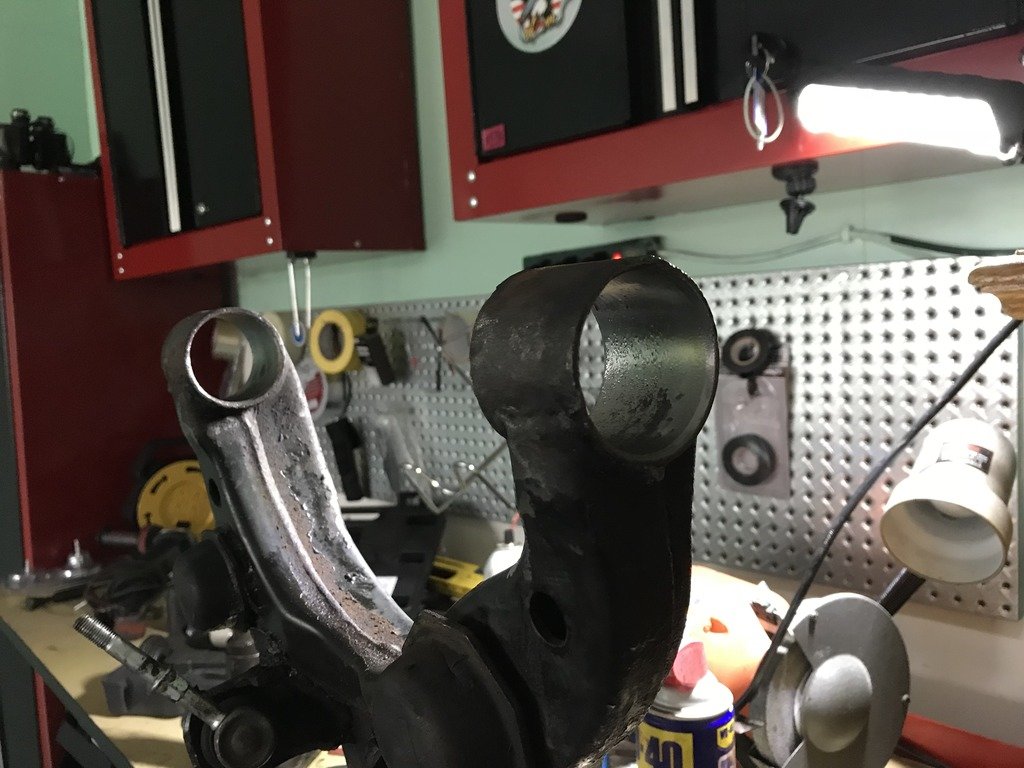

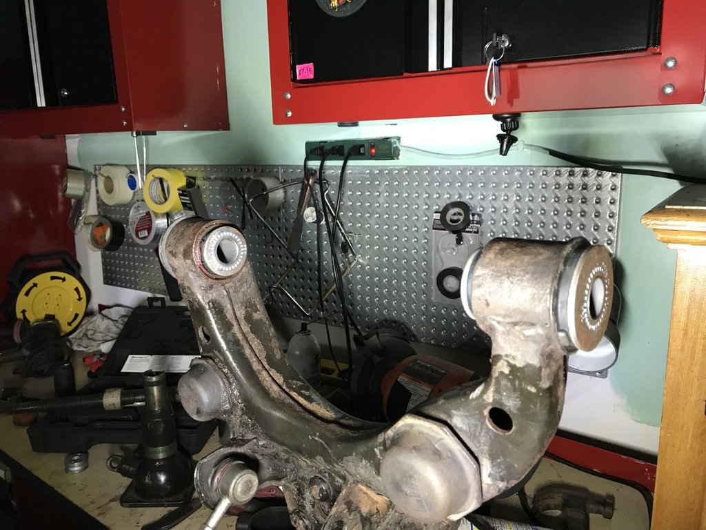

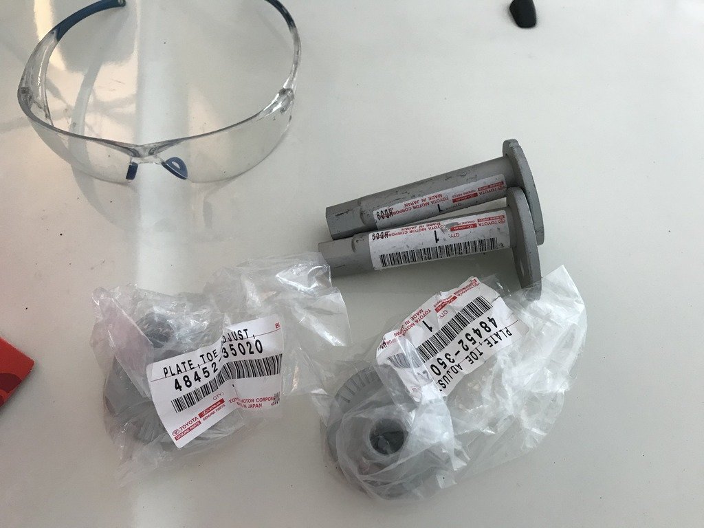

    Hello everyone!

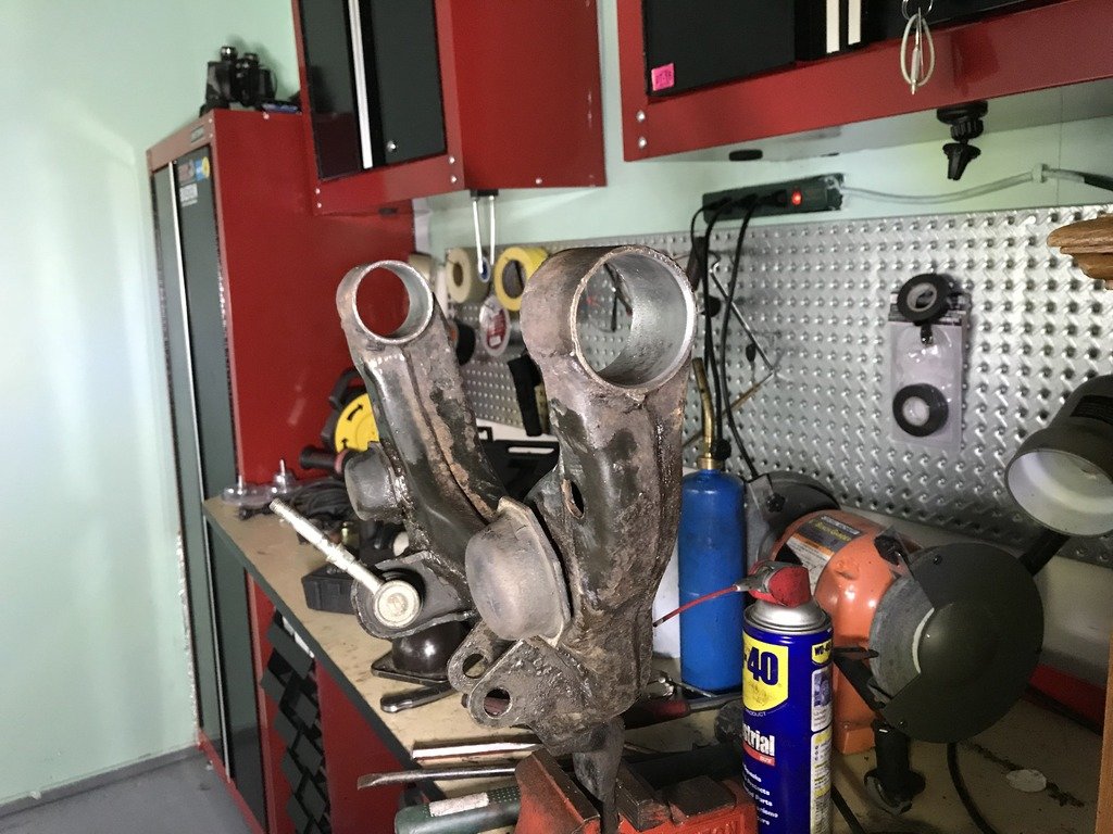

    Sorry for not updating for a while, I got super busy with the family as we had our baby #2 and there went my freetime. BUT I still managed to find some time to work on the truck in the meantime.

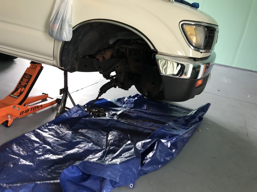

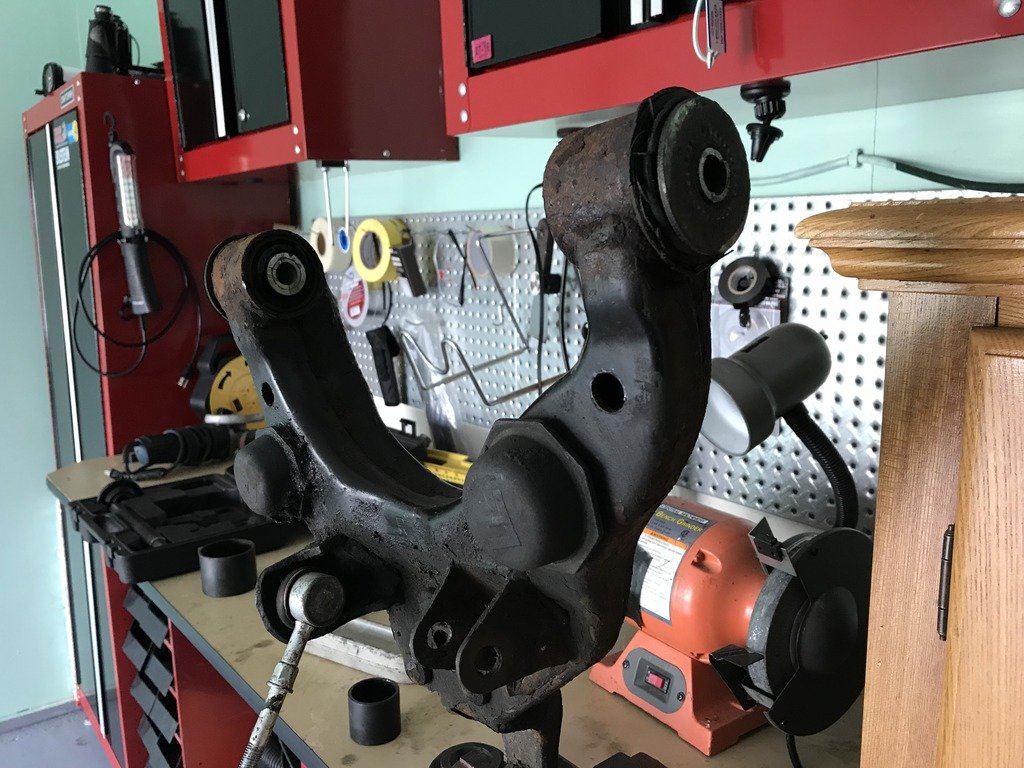

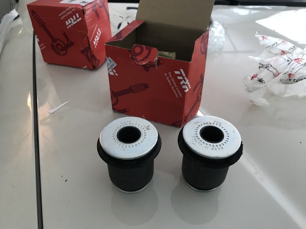

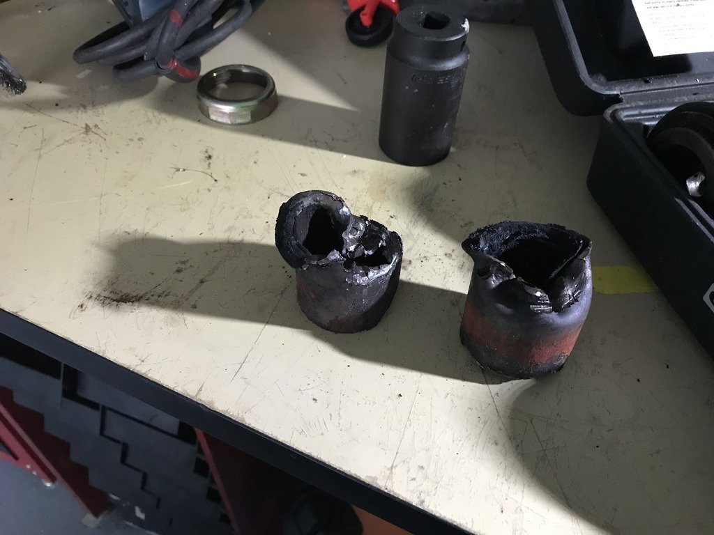

    Anyhow; after the front end lift the, the truck needed an alignment done very bad. Took it in for an alignment but failed because the right side adjusters were rusted on. I tried to get them loose but ended up damaging the bushing. So it needed new bushings and I decided to do the job myself "should be easy" I thought but boy oh boy was I ever wrong. I went through and experienced pretty much every horror story you've read on here about control arm bushing replacement. What a pain the nut sack!
    Dalandser likes this.
  18. Feb 3, 2019 at 9:34 PM
    #58

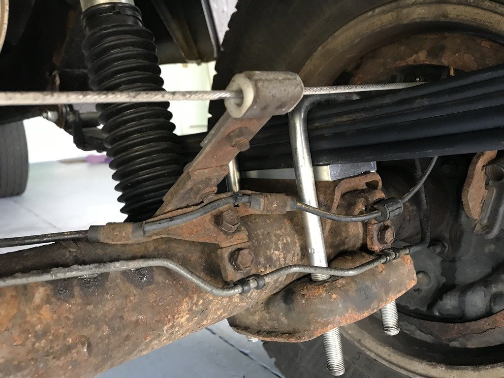

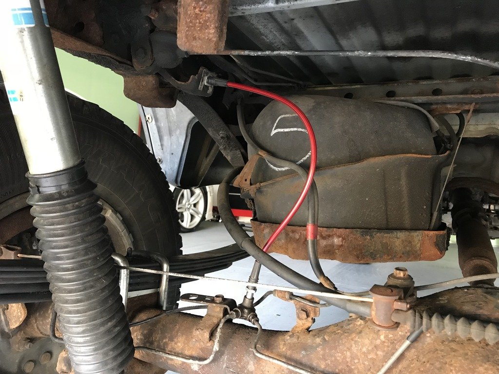

    Installed a longer brake hose and a 3 degree pinion angle shim under the leafs for the vibrations as CB drop didnt really work. The shim cured that issue right away.
