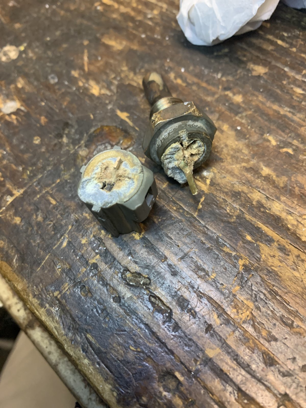

    Update. Last weekend, the Cooling System Temperature Sensor was replaced. Couple of glitches on first start up. So far, running well.

    I had a code for CTS
    Look what mine looked like b4 replacing

    96 Tacoma still running well.
    My CST Sensor looked a lot like Control Cars.
