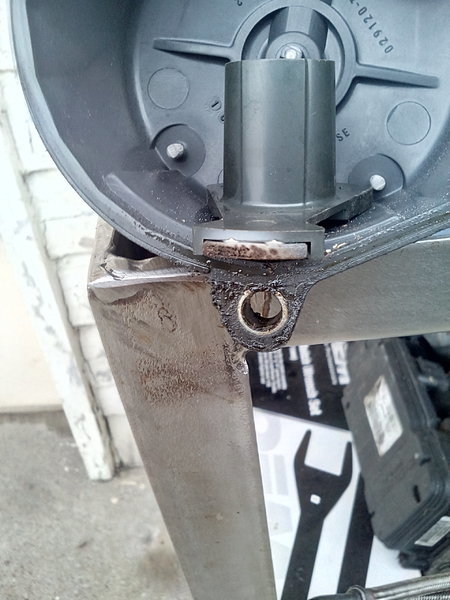

    Compression test results ran from 165 to 175 throughout all 4. So, I swapped out rotor,cap, and wires. You can see that the rotor was rusted and pitted pretty badly. The contact points in the cap were glazed and pitted as well. However, it is now sputtering/missing , idle speed is very low/almost dies, and it is throwing a code for misfire in cylinder 2 still yet. Injectors? How do I prove or disprove a bad injector?
